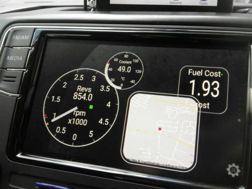

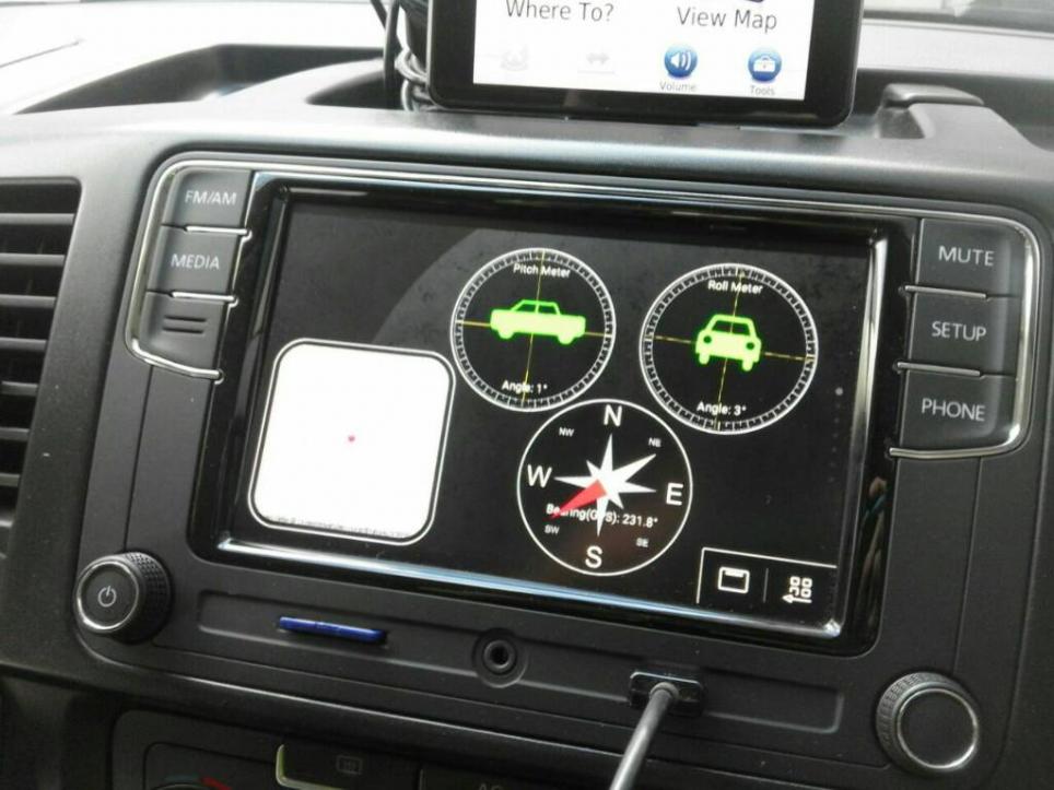

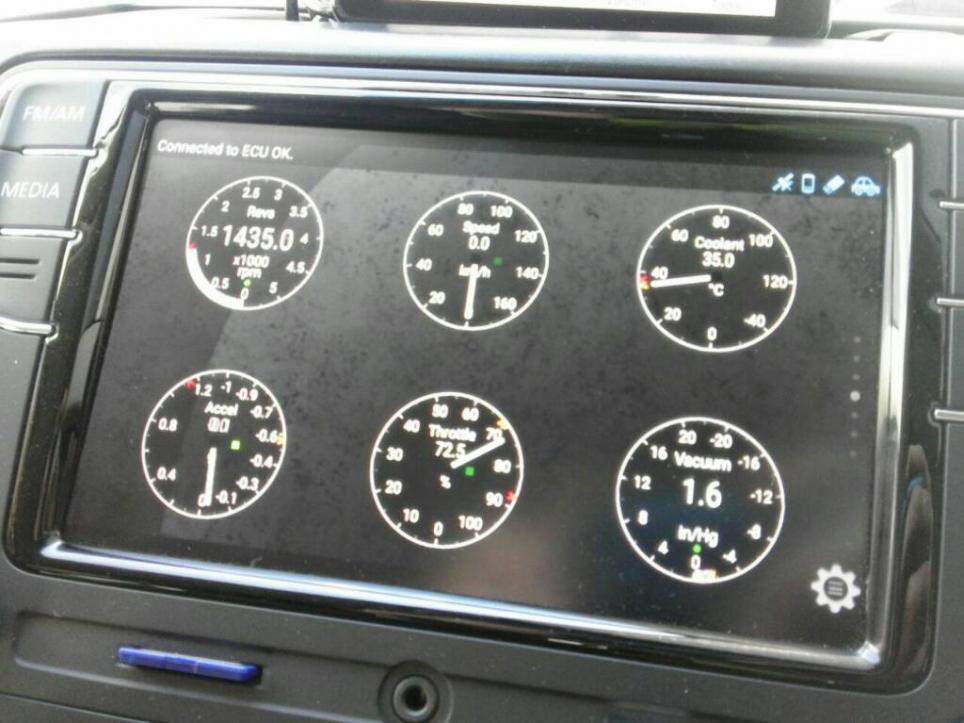

                          Played around a bit, loaded Torque and used mirrorlink
                          Sent from my SM-G900H using Tapatalk
                              That looks amazing dude
