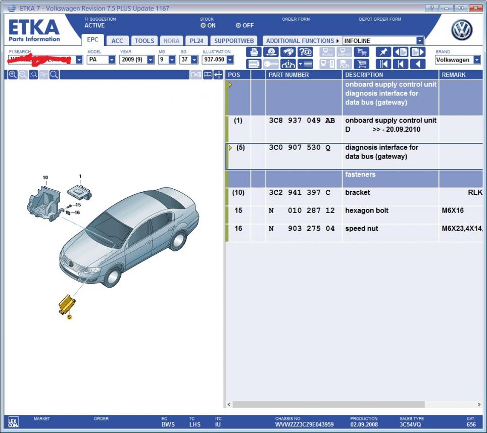

How did you know your Canbus module was not effected? Just from trial and error, or are there some documented versions? I have not found a reliable source of information on this subject.Originally posted by water_Jetta View PostAlso my Can-bus module is recent enough not to have battery drain issues or any of those problems. I believe that's what that unit is for
From what I've been reading if you have the CAN BUS gateway ending in Q you should be able to get away without having to get a CAN module adapter.
Being a Parts interpreter for a Volkswagen dealer has it's perks, looks like I'm in the clear
