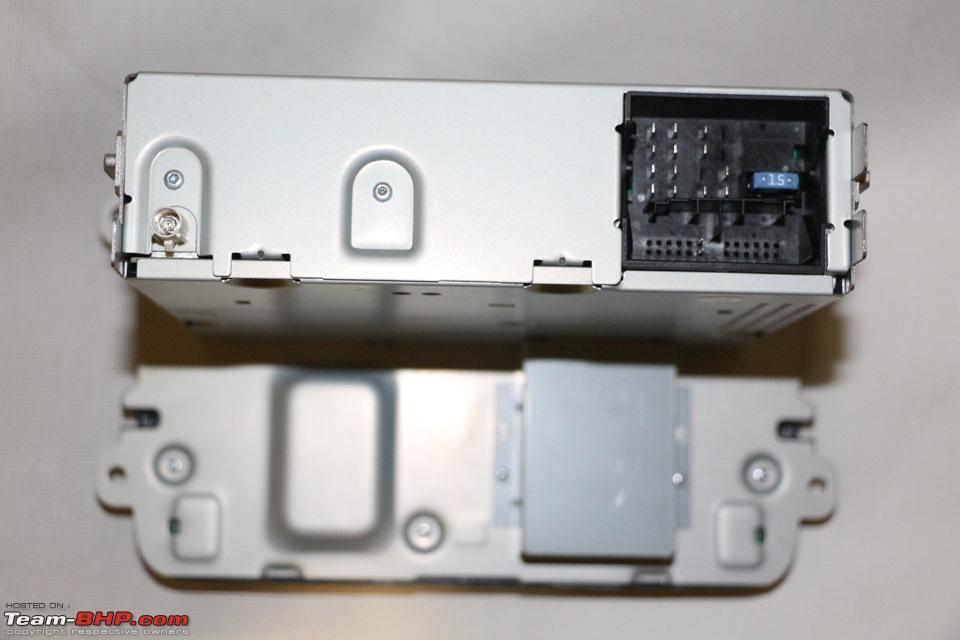

                    No problem, there is only a front facing one. This is what the rear looks like:

                        I have a question about your OEM camera connection, I've just bought a RCD330 and I'm trying to work out which aftermarket camera I should get. If you need that converter you linked does that mean this unit only has a single composite video input where as the RCD510/RNS510 have component (RGB)?

                        Anyone know if the difference in image quality of RGB cameras and the cheaper yellow plugged composite cameras noticeable? If so does anyone have a pin-layout for the rear of the RCD330 so we can confirm that it doesn't have RGB input as well as composite.

                            The RCD330 doesnt have a composite video input, thats why the sellers are usually providing a "free" camera adapter like this guy: https://www.aliexpress.com/store/pro...651650889.html
                            Here is what the rear of the RCD330 looks like: http://g03.a.alicdn.com/kf/HTB1TX6WM...Xq6xXFXXXR.jpg
