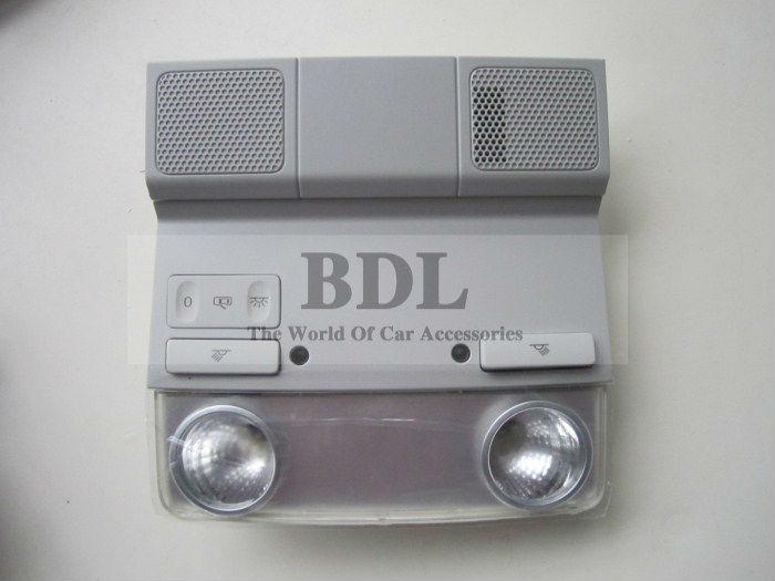

        Hi Guys, lots of good info here.
        I am about to purchase one of these units for my mk6 golf. I was wondering if anyone has:
        a) confirmation of Bluetooth connectivity working for phone calls and audio?
        b) Retrofit an OEM mic in the OEM location (pictured below), if so how does it connect to the RCD330?
        I guess it is worth asking, is an external mic even required to make good quality phone calls with this unit?

            a) These units have a built in bluetooth module that handles both phone audio and music streaming.
            b)Such a retrofit would involve taking the Unit apart and soldering a new microphone onto the logic board. While i cant personally attest to the quality of the mic as i dont have an unit installed yet, retro fitting one in the way you're suggesting would be complicated process that may or may not result in improved call quality. Imho not even remotely worth it
