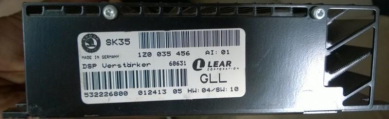

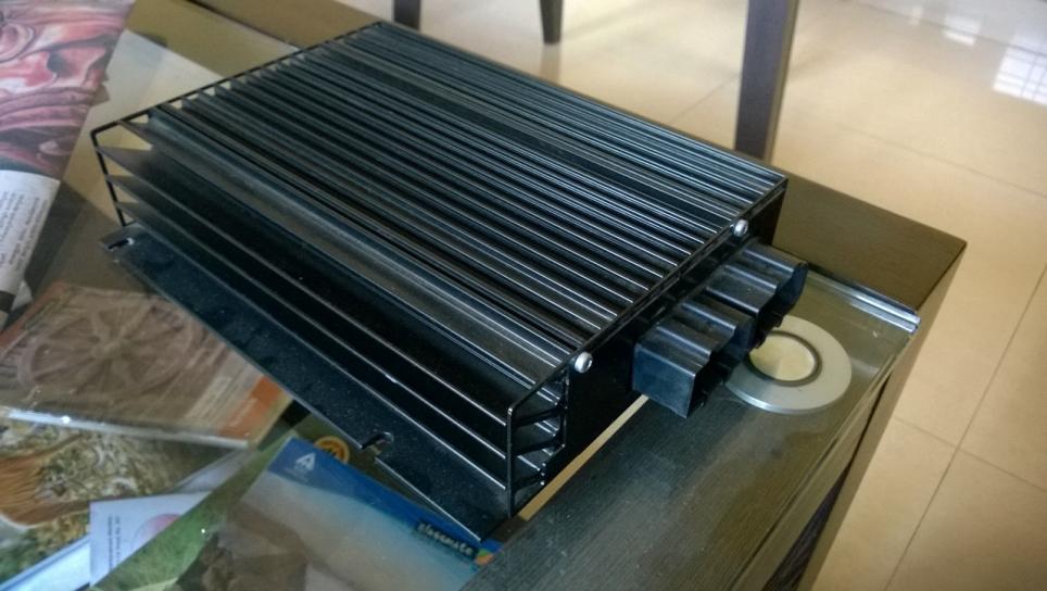

                      My car has a factory fitted DSP with the 12-speaker sound system. Here is a picture of the DSP:
                      I have read through the entire thread and I am ready to pull the trigger on an RCD330 with android auto, but I just wanted to make sure it will work with my car's DSP - I have read that people have managed to get it working with Dynaudio / Fender sound systems by disconnecting and re-connecting the battery - will this trick also work for my car? My hope is that since the RCD330 works with the VW sound systems, it can work with skoda's as well?

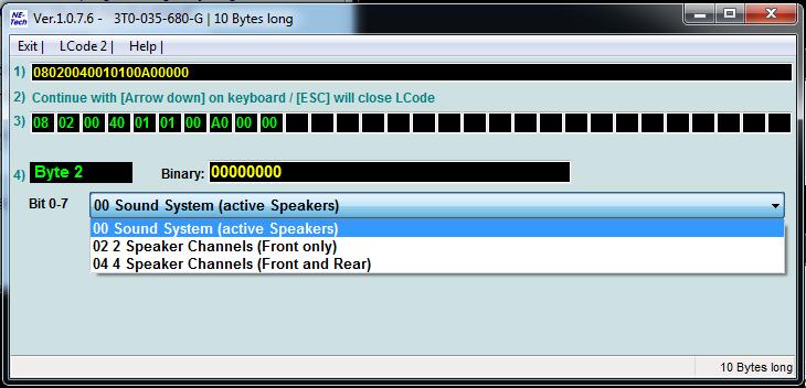

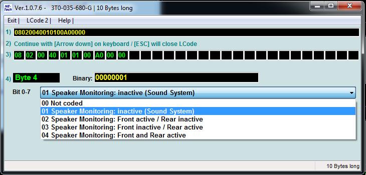

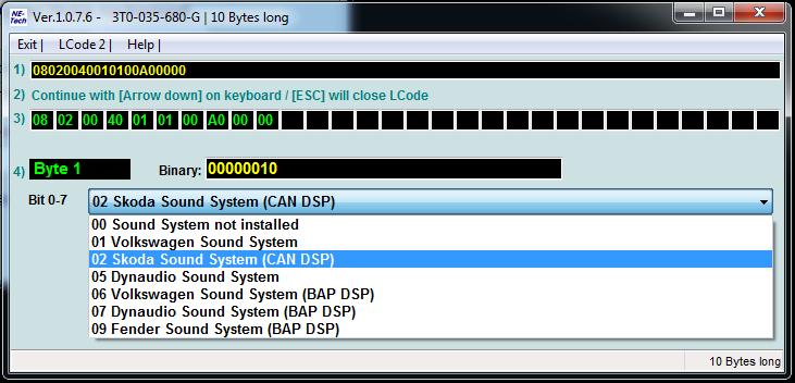

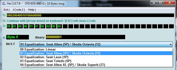

                      Here are the coding values I have applied to my Columbus to get it working with the DSP
                      BYTE 1: 02 Skoda Sound System (CAN DSP)
                      BYTE 2: 00 Sound System (active speakers)
                      BYTE 4: 01 Speaker Monitoring: Inactive (Sound System)
                      BYTE 5: 01 Equalization: Seat Altea (5P) / Skoda Octavia (1Z)
                      My concern is BYTE 1:
                      the skoda sound system is marked as CAN DSP, while the VW/Dynaudio/Fender sound-systems are marked as BAP DSP - dunno what this entails
                      Your inputs are greatly appreciated
