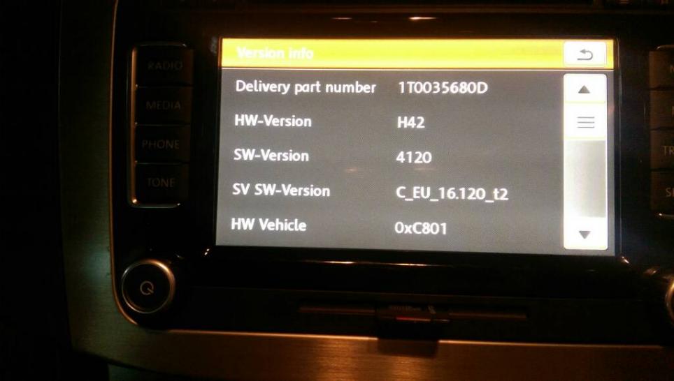

Put 4120 in and be happy Mine is a C and it works as well as anything VW can There isnt really any advantage going to anything else.
Euro versions are different due to the size of partition required for the larger maps.
Also some of the higher numbered versions are for units with DAB boards and you can stuff an older unit if you load it, be warned
Yes, I installed 4120 last night, no issues - despite many reports of needing to recode when flashing 4120 on other threads... The newer 52xx stuff is reportedly faster...

Yes, the model number must match... Mine is the 1T0035680D, 680 is the Australia/NZ version, so I wouldn't touch it unless the version matches the description. There are a few people who asked the question regarding this specific version and some answers saying, you can do it anyway... I'll PM them to ask how they fared.

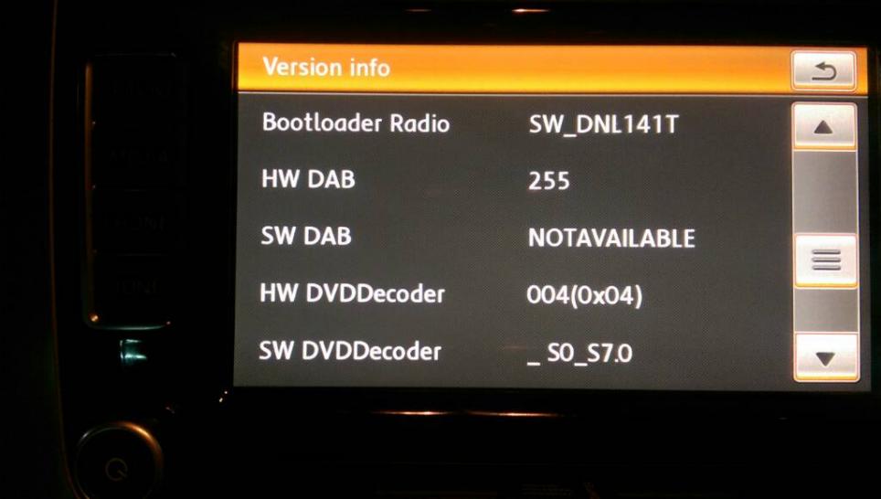

I was just poking around and noticed the HWDAB field populated... 255 looks like 11111111 in binary, which I guess could mean nothing present or something present... No idea... What does yours show?
Also, I was copying some music from a music folder on sdcard to hdd, but I noticed after copying that it seems to have eliminated the music folder and moved the album folders to the root of the hdd... Is this typical or did I miss something along the way... How else do you do a bulk import?
If you read through the thread (Its a good idea) I think in one of Kamolds posts he said the 255 means IT DOESNT HAVE DAB

The version tested to work here in Australia is the 1T0035686C (1T0 035 686 C) with a Hardware Level of HW:09 and running software level 5238. This unit is a stock RNS 510 with LED screen, 40GB hard drive and is the latest available model from Volkswagen.
Only the above has DAB C and a D most definitely DONT. Mine is a C and when you put the 4120 in it changes to appear as a D but in fact is still a C Its all in the thread if you care to read it
