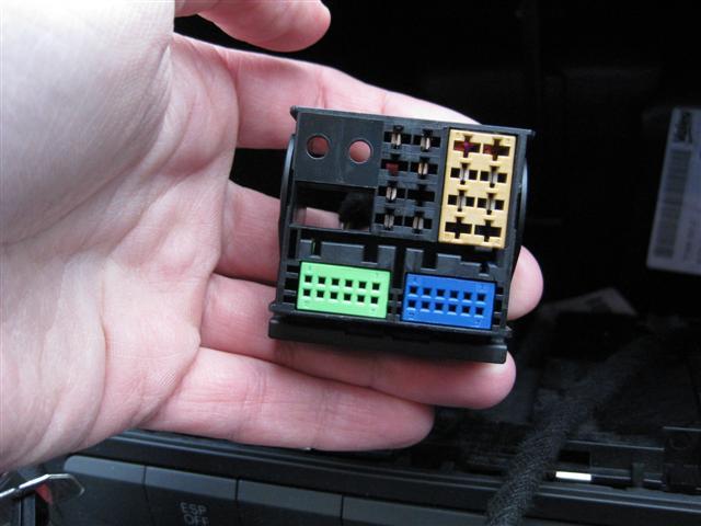

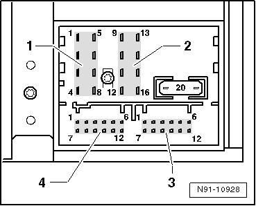

I think it's the blue one (or one of those down the bottom) that needs to be extended to reach the HU. Although I thought it was pink on my one (that pic is from an Audi though).
correct, its the blue one.
corresponds to no.4 in the pic below......
