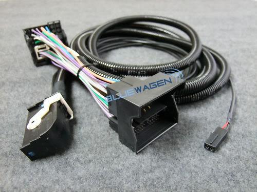

              • Hi guys. I've bought the 9W7 kit from Bluewagen. I have an MY10 with the factory fitted voice control for the RNS 510 already enabled.
                For those of you who have the factory mic already installed, was it just a matter of pulling out pin 1 and 7 from the car harness and splicing it into the piggyback harness? or did you wire in the second mic.
                I pulled out my RNS 510 and climatronic just to have a look and spent a bit of time looking at the connections. Looks like Mic should go to Mic in on RNS 510 and then Mic out from RNS 510 to bluetooth module.
                Any tips would be appreciated. I just put everything back together and haven't installed the 9W7 yet. Happy for any input before I have a real go on the weekend including how best to splice the wires....is it ok to just twist and cover with electrical tape or better to try to place in the pin holes directly.....I have no pin removal tool.
                Thanks. Sorry for the newbie question.
                Ray.

                  i bought the bt wiring harness from bluewagen for my 9wz install.
                  it was a simple plug-n-play with my factory installed rns510.
                  i didn't have to do anything with regards to the mic for voice-control (factory installed) either. the wiring harness is setup by default to make the bt use the rns510's factory installed mic.
                  if u want to use the bt's mic, then there was some pin swapping required i believe.
                  also the older bt wiring harness required splicing & swapping as they weren't "factory installed voice control" friendly.

                    Thanks darkshadow. I installed it tonight works well......mine wasn't factory voice friendly so had to cut the factory wires and joined them by crimping using some audio crimps i bought from jaycar today. Didn't want to risk tape coming apart in heat. Anway 9w7 works well. Will code over weekend to enable steering wheel button.

                    Aaah i just went through the old posts and found your harness with a single microphone input.....mine was quite different!
