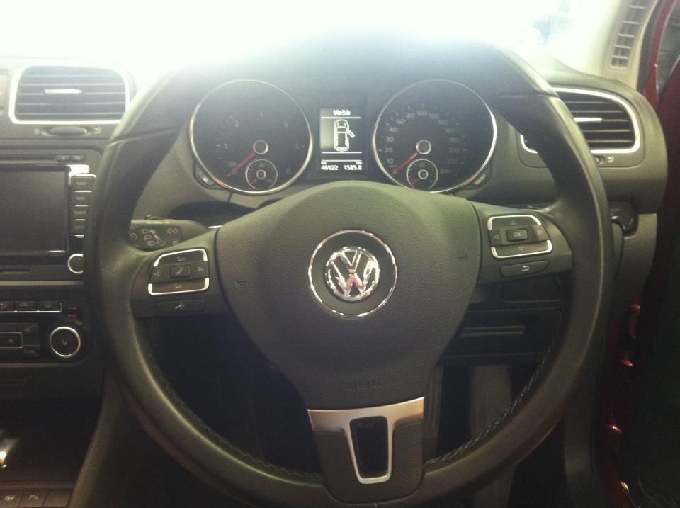

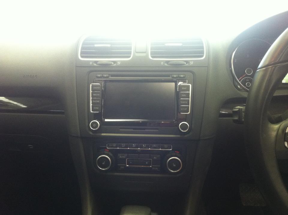

          • Apologies for asking something that might be answered elsewhere in this thread, but while it is a fantastic resource, it is difficult to glean exactly the information I want from its 50+ pages. So I'm hoping one of the resident experts might be able to answer my question.
            I'm about to buy a late (December build) 08 Golf V Pacific 2.0TD. It has an RNS510 with nav, that I assume was factory installed (car has loads of options so was probably a special order). However, the car does not have bluetooth. I would like to install a BT module, one that will allow browsing of the phone's phonebook, and accept and end calls from the steering wheel controls. I'd also like to do BT audio streaming, preferably with playback controls. Track name and whatnot on the screen/MFD would be nice, but not necessary. Voice commands/tags likewise would be nice, but not at all necessary. Basically, I test drove a brand new Octavia last week, and want that kind of functionality, but in a Golf if possible.
            I gather it can depend on which MFD and steering wheel you have. This is not a picture of the exact car, but the MFD and steering wheel in the one I'm looking at are the same as those in this pic:
            So, if someone could tell me whether there exists a unit that will do all this, I would be very grateful. Is any other info needed? The car is in another state, but if it's easily accessible with a button press or suchlike, I'd probably be able to get the seller to find out the version, bus and firmware.
            Thanks so much in advance to anyone can help! I'm getting excited about my potential new car!
            • If you read from say Page 45 and beyond you should get the most relevant info.
              I would normally associate a 2008 Golf with the old red MFD which is not 100% compatible with the newest BT modules, but if you are certain that you have the white MFD+ (which hopefully is the same as all the other MK6 Golfs) then you should be fine using the newest one.

                Thanks for the response.
                If someone can show me how to post a pic I have on my hard drive onto the forum, I can post a pic of the actual car, sent to me by the seller, to eliminate doubt. I can see the "image" button above, but it's only html script for an image already somewhere on the web. Other forums I've used allow you to add an attachment to a post. Am I missing something?

                    • Looks like any other 2009 MK6 Golf - so it should be fine. Don't yell at me if I'm wrong, though
                      Audi A3
                      • Originally posted by thelongroad View Post
                        That is definitely not a Golf V. It is unmistakably a Mk6.
                        • Originally posted by AdamD View Post
                          Great news, what I wanted to hear. Thanks so much!
