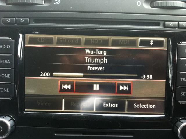

                • Originally posted by vraptor View Post
                  here is a pic i took to show what mine looks like, pause, forward and back all work within the playlist selected.
                  I would very much like to know how you're getting Album, Artist, Track names to appear over Bluetooth. I have an iPhone 4 with IOS5, 9W7 and RNS510 and all I get on the display is "Bluetooth Audio". Perhaps you have a more recent 9W7 firmware? Can you dump the versions using VCDS software?
                  Ed: according to http://www.iphonehacks.com/2011/06/i...o-devices.html the folks at Apple upgraded to the latest AVRCP version in IOS5. This adds support for album/artist/track and even artwork. So I bet it's the 9W7 that needs to be upgraded. Oh well.

                  • Originally posted by nhand42 View Post
                    Ed: according to iOS 5 Feature: Ability To Send Artist, Album And Track Name To Bluetooth Audio Devices the folks at Apple upgraded to the latest AVRCP version in IOS5. This adds support for album/artist/track and even artwork. So I bet it's the 9W7 that needs to be upgraded. Oh well.
                                Does this help you:
                                Address 77: Telephone (J412) Labels: 7P6-035-730.clb
                                Part No SW: 7P6 035 730 F HW: 7P6 035 730 F
                                Component: TELEFON H09 2730
                                Yes it does, thank you. You have the F model and I have the C model. That's almost certainly the important difference.
