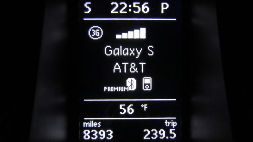

                    • Originally posted by YellowLemon View Post
                      I'm wondering how can you tell if it is using 3G and what band? Does it say on the display?
                      ...(Unless you knew there was a coverage hole at some location where only 850Mhz or 900Mhz was available
                      Well, according to alot of the pictures I've seen, it is capable of 3G (it's got a lovely little 3G in a bubble next to the reception):
                      See
                      • I have iPhone 4 with Telstra and 9WZ. Works well. BUT am not using the additional GSM antenna for rsap. The 9WZ uses the iPhone for reception.
