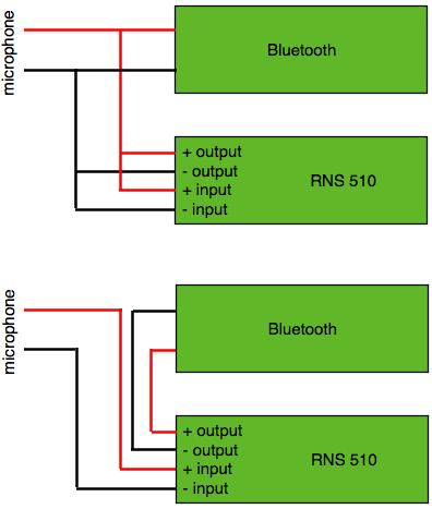

                    • doridori, I bough the unit you posted. Works flawlessly, supporting stereo music streaming, however, in order to make the wiring harness compatible with RNS510, RCD510 and RCD310, the microphone is wired to the Bluetooth module, then to both the microphone output and input of the head unit.
                      This is fine for RCD310's (as they do not have microphone pins), however for the others this may cause interference on the microphone.
                      What I did was cut the wire coming from the microphone, and connected that to the input of the Head Unit, then cut the bridge between the input and output of the head unit, on the wiring harness. my-gti has a diagram with the pin assignments for an RNS510 unit, but will post pictures and links when I get back to my computer.

                        • OK, so here goes.
                          The wiring harness itself is not OEM, as Volkswagen wire all the components (e.g.: speakers, MDI, Bluetooth, CAN, Aux-in) to one connector when the car is being assembled. The harness supplied with the module is designed to be plug-and-play, you plug the original plug into the harness, and then the harness into the head unit, and it makes all the necessary connections, however...
                          As per this thread... The Volkswagen Club of South Africa - View topic - Golf VI GTI RNS 510 and 9WZ Bluetooth Install - Long Post, and this Volkswagen RNS 510 pin assignments | my-gti.com, the harness is incorrectly wired.
                          In the following diagram, the top setup is how the harness is supplied, and the second is the required setup.

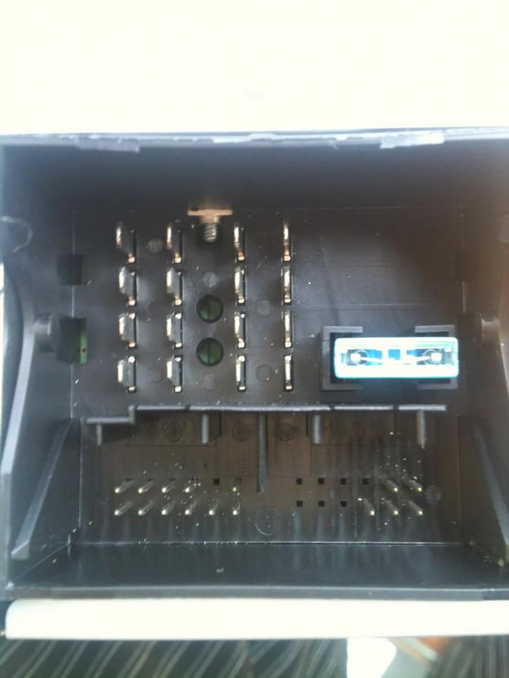

                          As I had an RCD310, I visited Volkswagen RCD 310 pin assignments | my-gti.com and thought that I must also change my harness, however after modifying it I took out my unit and discovered that those pins did not exist! This is why the harness is wired the way it is
                          My RNS510 then arrived the following day, so all was well in the world.
                          So if you have an RCD310, the harness is fine. If you have an RNS510, then it requires (would benefit from) a little modification.
                          The unit came precoded, so it worked straight away (could pair, stream music, initiate calls from the phone), however it will not show in the MFD (screen between the Tachometer and Speedometer) unless you code it using VCDS Ross-Tech: Home.
                          All in all, not that hard. I just put the unit behind the Climatronic unit, ran the microphone under the steering wheel, out the fuse box, under the door seal, and under the roof to the overhead light console. This way I did not need to remove the A-pillar.

                            • wow jameshero that's an awesome post!
                              gee that mic seems to be wired so strangely... did u ever test it with it in its default setup?
                              and why was it wired like that; just so that they can sell it and have it work with numerous configurations albeit at a slightly reduced quality?

                              • Originally posted by jameshero View Post
                                my car came factory-fitted with the rns510 & voice control. so can i assume that i already have a mic in the a-pillar, and its just a matter of wiring the rns510 mic out to the bluetooth (9wz) mic-in?
