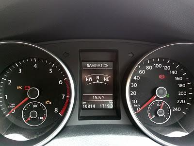

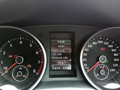

I got a VW 9W7 Bluetooth KIT installed bty VW dealership today. It works great with the RNS-510 but can anyone tell me why the heck the stear column controls dont work. I mean i can make calls and pair the thing and it works like a charm and i have the address book workinmg. I cant answer or hang up via the phone icon in the R36 nor can i use the arrow keys to move (or the OK key to select). They told me they dont have VAG-COM so any suggestions.
They promised me they did all the coding required already but thats not the case.
