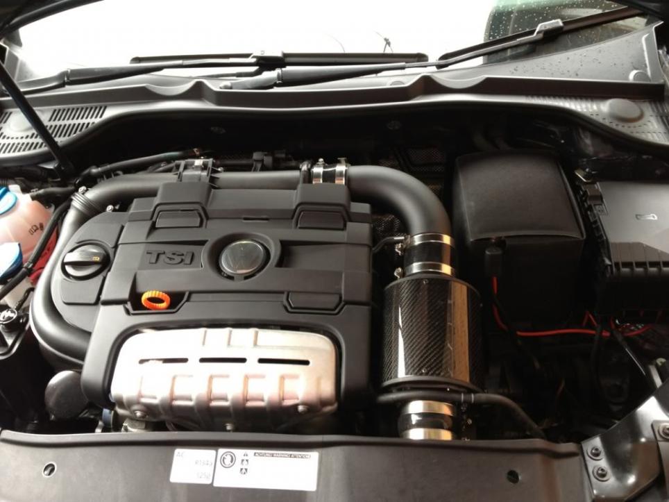

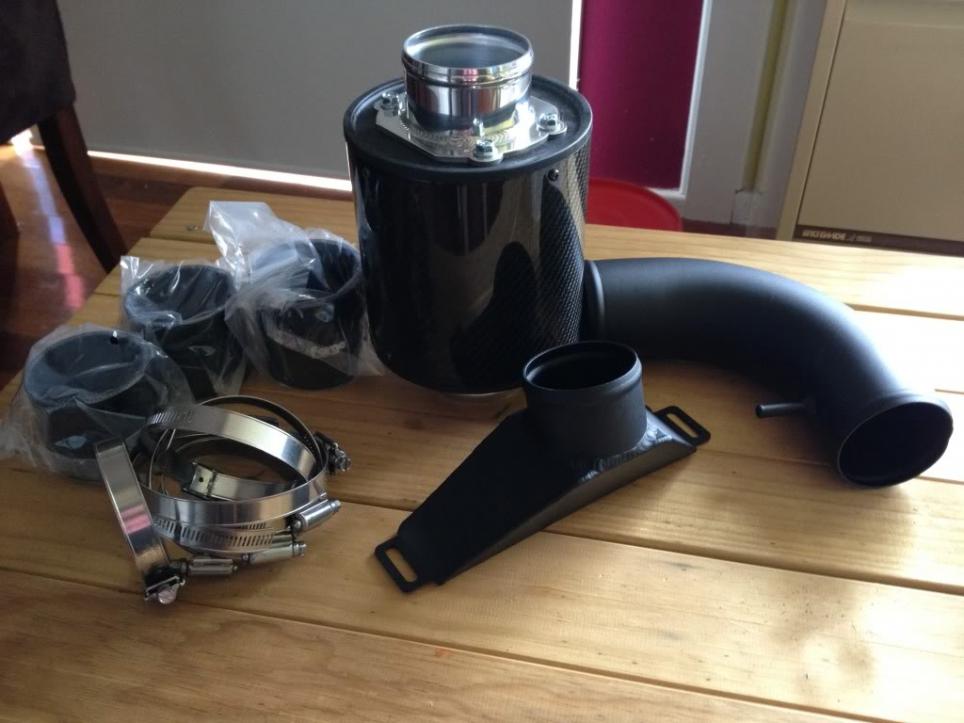

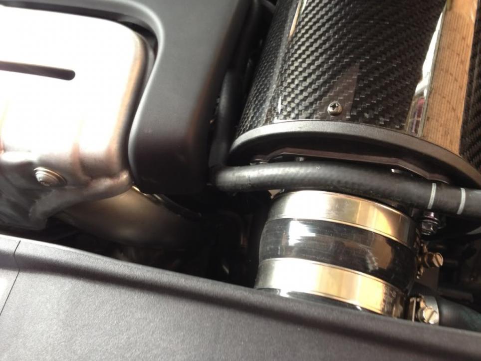

              Install was maybe 30 minutes taking it slow, although I think I could do it in about 10 after seeing how it's all put together. The comment I read about the water pipe touching the engine cover is about right... I might dremel a little groove in that later, but for now it's perfectly fine.
              Performance feels much the same, although I didn't expect anything from an intake alone
              Noise. Well this is interesting, I *think* there is more spooling up noise, but that could be in my head, what I have noticed is that the blow off is now much more noticeable and at light throttle and cruising it sounds like it's constantly bleeding boost, something you could ever hear before.
              I'll have to give it a good drive before I can make any real comments however my first impressions are mixed, half of me likes the new noises the other half wants less noise... Will see which side wins!
              And some pics:
              (PS: On a side note, does anyone know if it matters which way around the filter goes? There doesn't appear to be any indication in the instructions or on the housing itself?)
                      And some pics:
                      Edit: I can confirm it scares small children
                      I emailed forge asking them
                      Which orientation for the filter and the response I got back was that under readying they found it worked identically regardless if orientation, but like Brendan I went with small side out.
                      Used the dremel today and it seems to have done the trick by the looks of things
