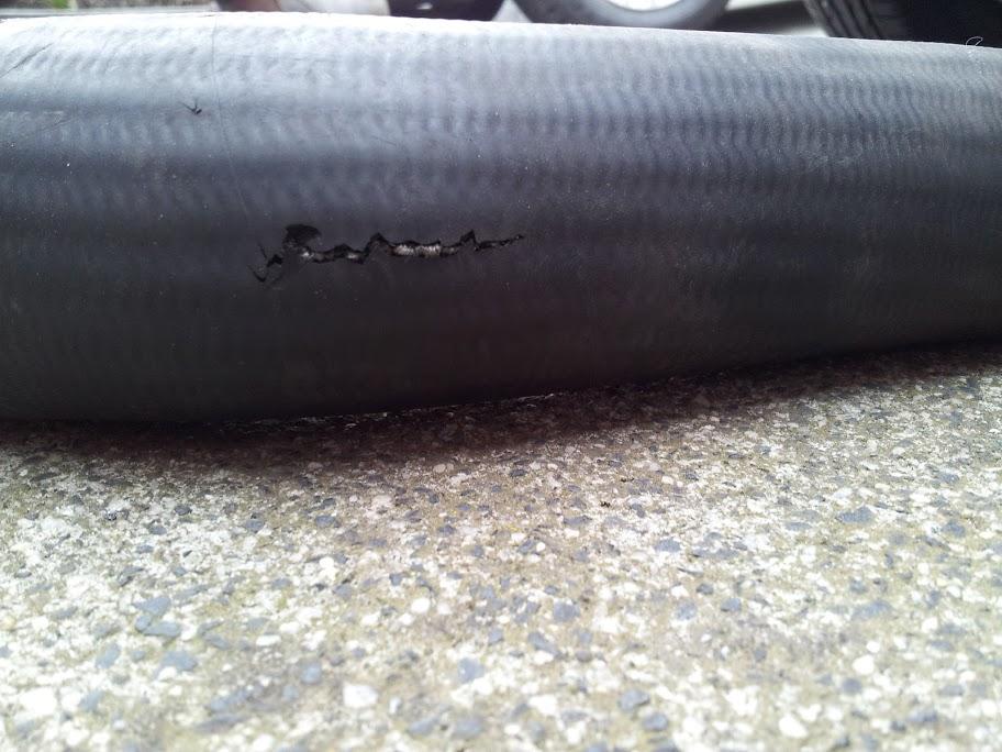

Don't know how but I've got a nice big gouge in my charged air pipe which has been making my car sound like I've got a Forge CAI
and has been reducing power. Will grab a replacement from a spare parts car and swap it over tomorrow hopefully.
Then I've got the car booked in at VW next week, and hope to get the S3 FMIC installed soon after.
^^ That would be leaking like a bitch. Gaffa tape is your friend until you can source a new pipe.
Stuck some duct tape on there (wrapped around a few times) and the resulting performance was obviously better, but the sound 20x worse. Imagine trying to play a gum-leaf as some sort of kazoo (instrument) but much higher pitched and way louder. Undid that solution and will bear having the leak for one more day. Only gotta go to the train station and back tomorrow.
Looks like something sharp ran along the side of it; can see after the gash the scratch that runs around the hose.
You can get a rubber tape that essentially fuses to the rubber you wrap it to with abit of heat; will seal properly unlike tape, but regardless still a temporary fix until you replace the entire hose.VWWC Members - 2018 Special - ECU & DSG Remaps

Hehe, and here I was thinking APR might have given me too much power for the various components to handle. Should have the hose swapped tomorrow night. A friend has access to a garage where a wrecked 118 is there to scavenge from.
