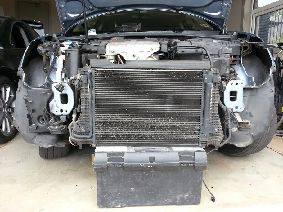

              • Today's the day Brendan - going to finally have a go at whacking that S3 intercooler in this afternoon
                  Lol, about time you installed it. You will notice a difference.

                  • I'll be interested to hear just how michbdifference
                    • Well next time we have a 46.5 C day down here (according to the car) I'll be able to let you know
                      On most hot days the Intake temp sits at around 50 C, so if it is indeed a 30% improvement then I should see the temps at around 35 C I suppose.
                      Having the DSG oil changed from synthetic to mineral however has also made a noticeable difference to hot weather driving (although I haven't done much stop/start in hot weather yet since the freeways are quiet).
