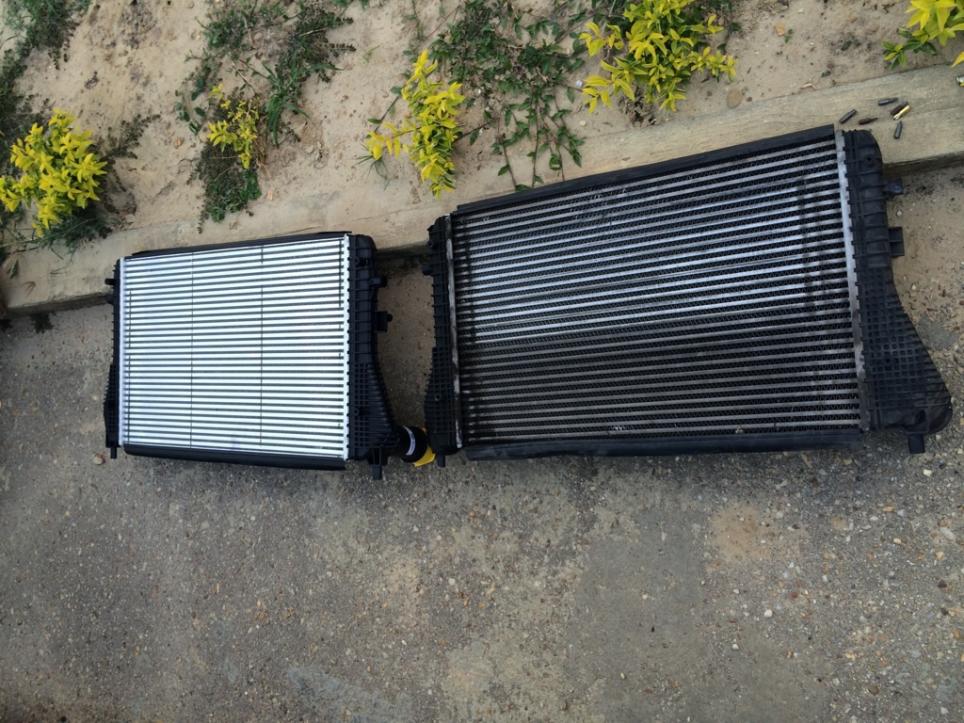

      • Just thought I would post up a few things even though I am doing the swap on a jetta:
        My intercooler is 1k0145803BM. It's dimensions are 31 mm x 418 x 647 mm. I'm surprised it's this big as the S3 intercooler I have is 37 mm x 416 mm x 646 mm.
        1k0145803bp - s3 intercooler has 32 bars of fins vs 30 in the stock intercooler. The fins on the s3 intercooler are also smaller so there are more of them that way as well.
        S3 intercooler has the yellow covers attached in pic.
        Finally I encountered garden hose clips (not sure what the right term is) so didn't have to cut my hoses to fit them onto the new intercooler. All of this should apply to a golf.
