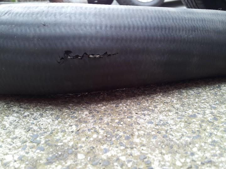

                    • To be fair when I first installed my S3 FMIC one of the hoses did pop off within a couple of days. Also got a decent split/crack in the hose as well so had to replace (found one on a wrecked Golf). Been a few years with no issues now, however.
                      Sounded like someone trying to play/blow a eucalyptus leaf as an instrument.
