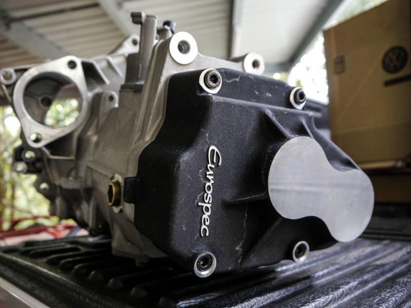

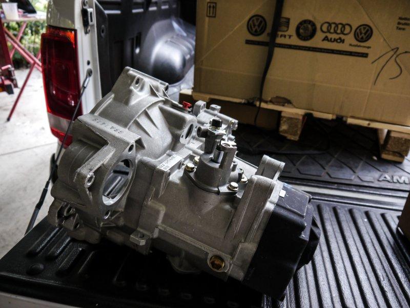

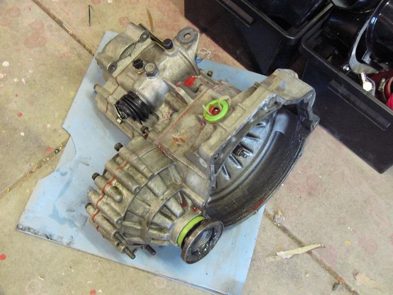

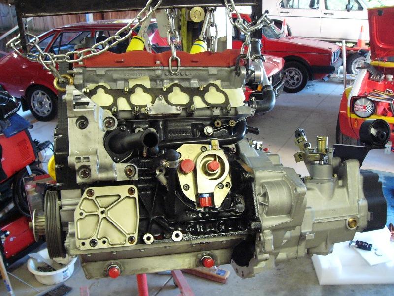

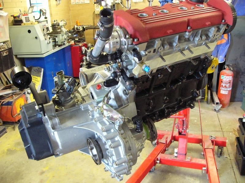

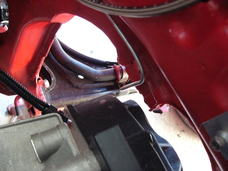

My new gearbox has arrived.
It's been two years in the planning and about a year of saving.
I had EuroSpec build it for me.
They did a great job on the motor and they've got a lot of interesting options for the late gearboxes.
I've opted for an 02J housing containing a 6 speed close ratio gear set along with a Wavetrac diff.
The ratios are
1st: 2.3
2nd: 1.8
3rd: 1.45
4th: 1.15
5th: .96
6th: .85
R&P 4.24
There's no low first gear in this box. The sprints I do are rolling starts so I don't need one.
This box squeezes gears 1-6 into the range normally occupied by 2-5 in some stock boxes.
I've chosen a lower diff ratio to increase acceleration, there's plenty of RPM left at the end of the main straight currently going to waste.

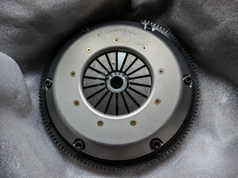

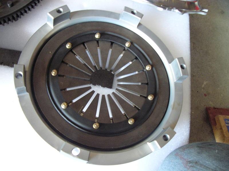

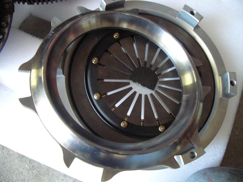

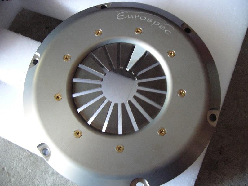

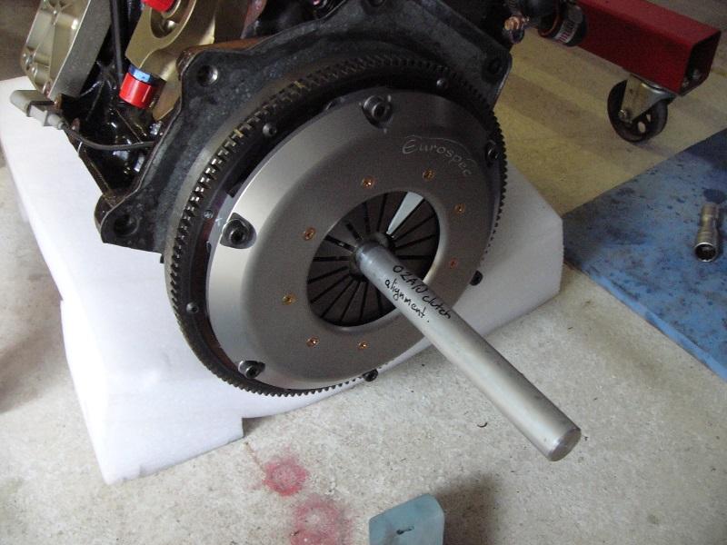

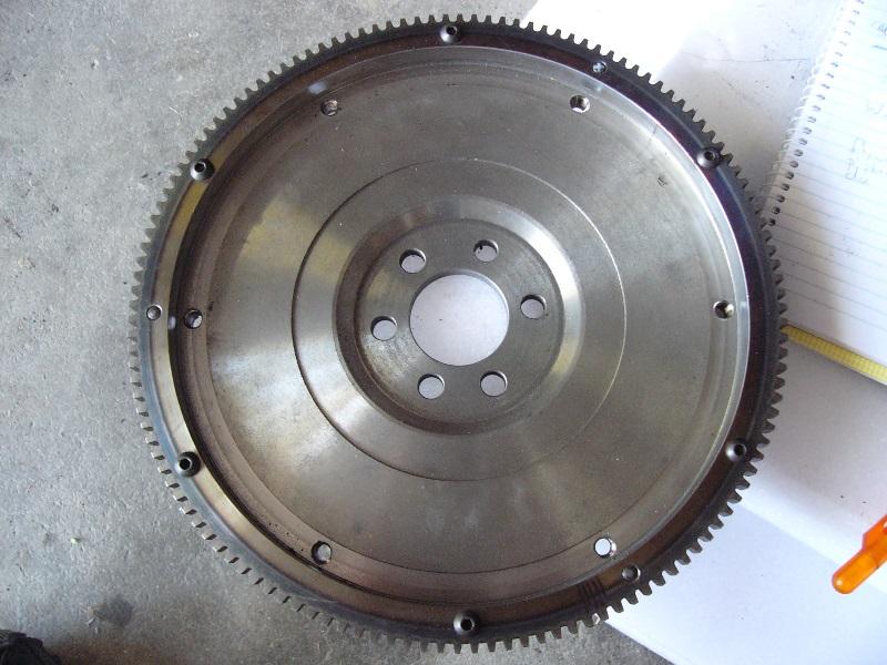

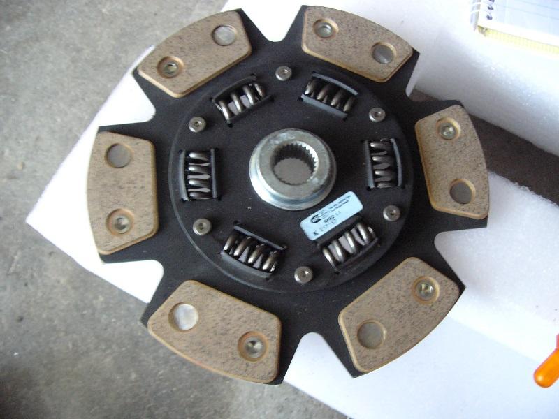

Eurospec have also supplied a clutch assembly, Lightweight cast flywheel, billet clutch cover, 215mm cerametallic six puck disc.

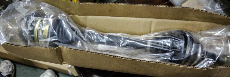

I also had them track down some OEM 100mm drive shaft assemblies. They turned out to be pretty hard to find.

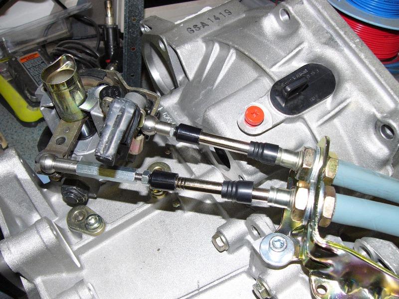

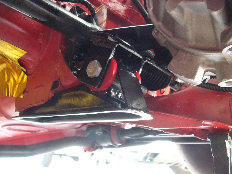

There's a lot of work required to fit this, new cables for the CAE shifter, new mounts, new hydraulic lines, find parts for and setup the shift tower. I'll be pretty busy sorting out the details.

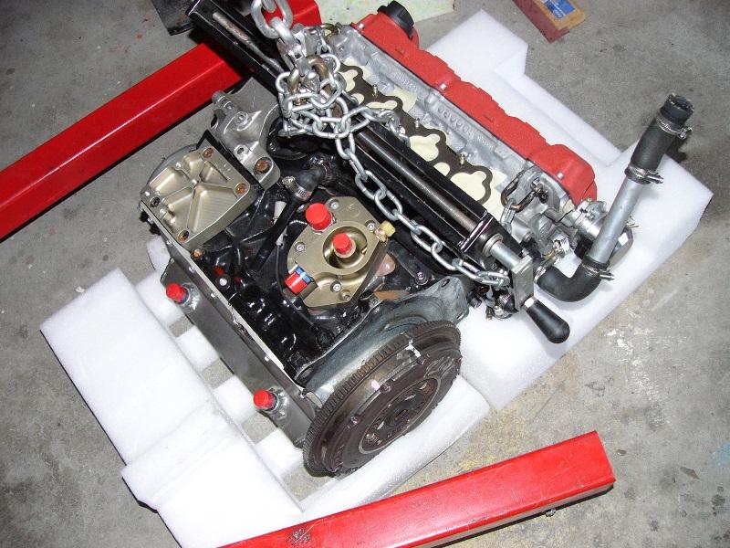

While it's out I'll also service the motor and give it a thorough going over.
