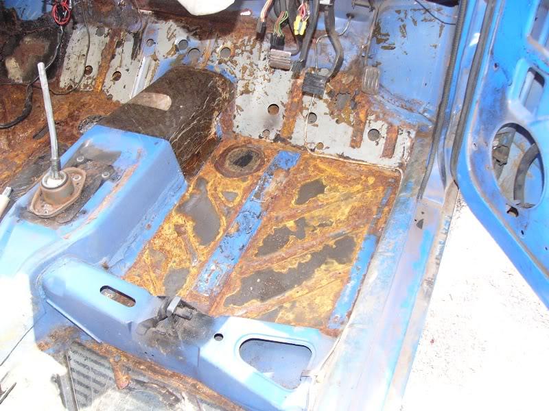

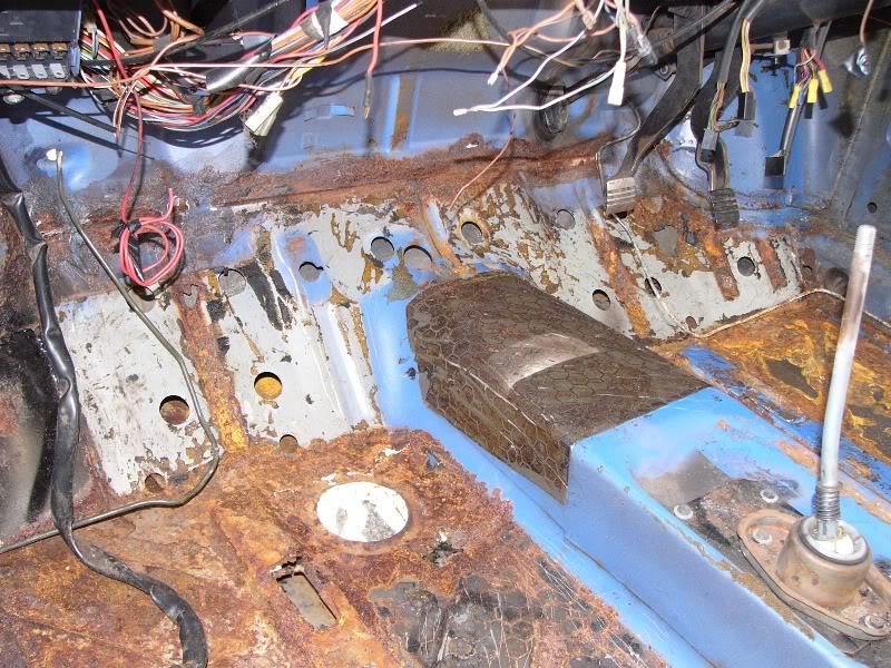

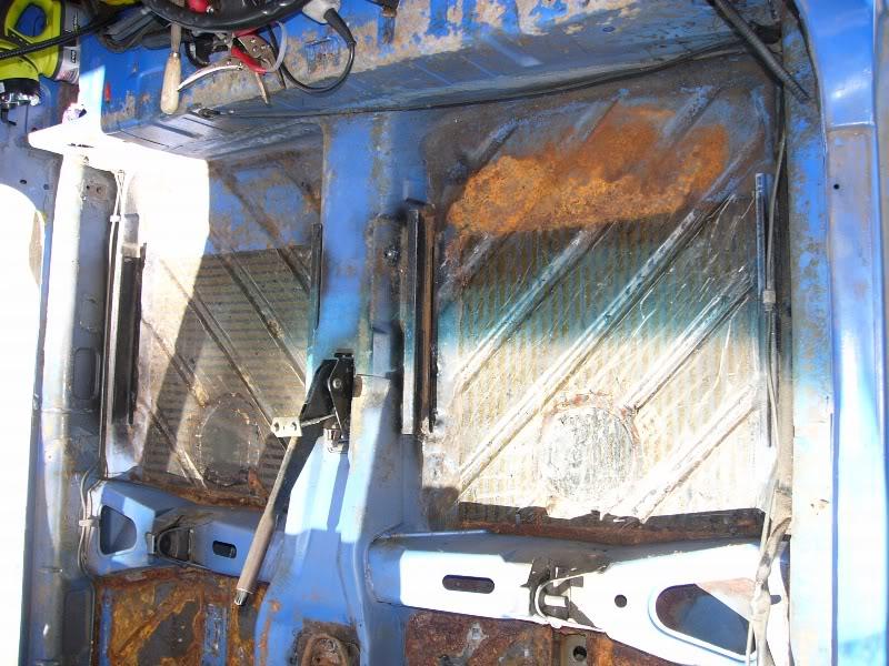

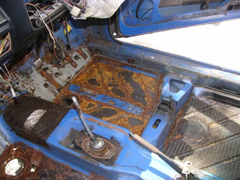

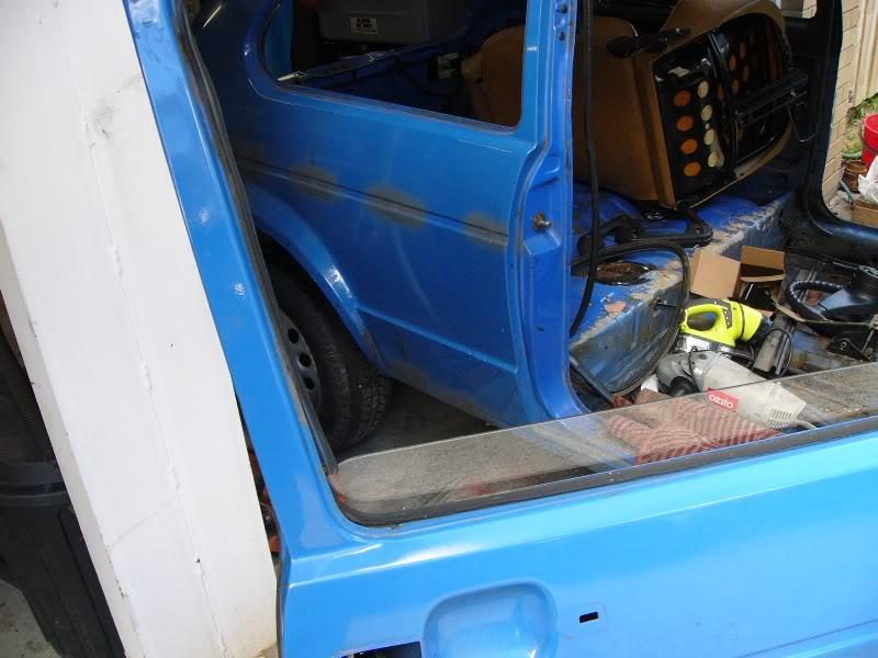

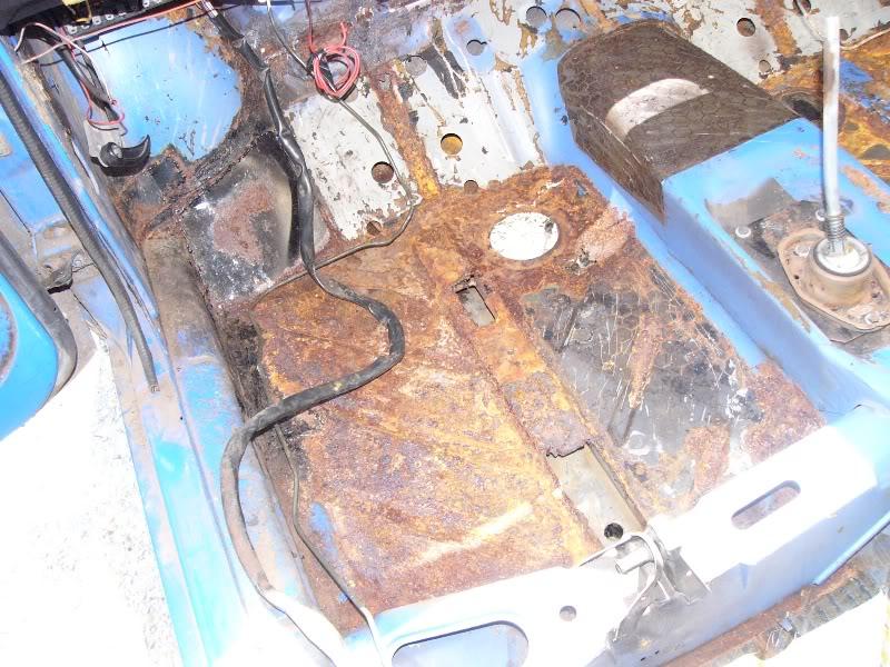

Cleaned the car up a bit over the weekend.
The passenger floor is pretty bad, i'm going to have to replace most of it.
Welded up a few of the trim holes.

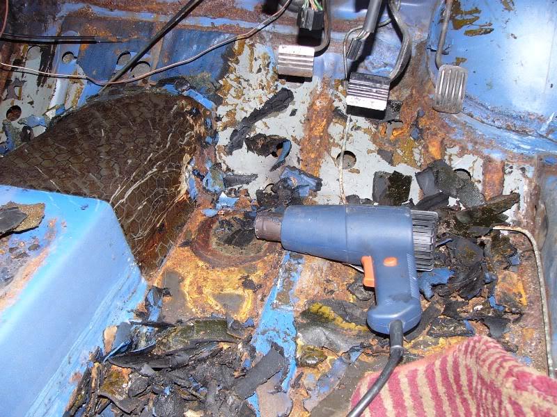

Those tar mats came off pretty easily with a heat gun.

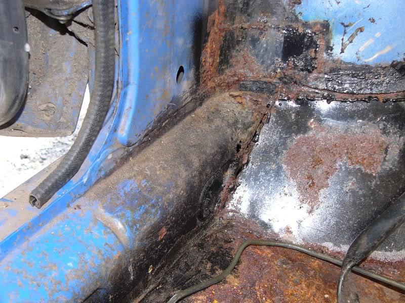

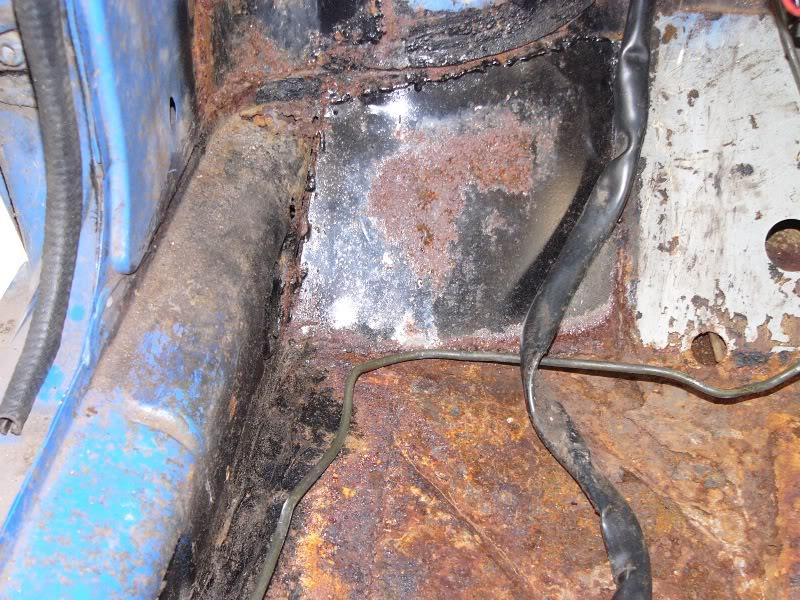

I'm a bit concerned with the passenger side sill channel by the base of the A pillar, I'm going to have to make that very strong again because a leg of the cage will end up there somewhere.

rusty. yum.
Got your work cut out, that's for sure.
With that corner, I'm sure a nice little bit of over engineering will do the trick!
Thats not so bad Pete, I have seen worse.
You`ll be right.sigpic Camden GTI Performance. VW / AUDI Specialists
Yeah, Driver's side is OK that'll clean up with sandblasting.Originally posted by Golf Loon View PostThats not so bad Pete, I have seen worse.
You`ll be right.

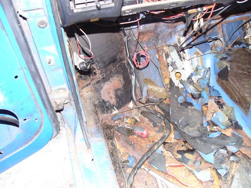

Passenger side will come up ok too, just needs some new metal.

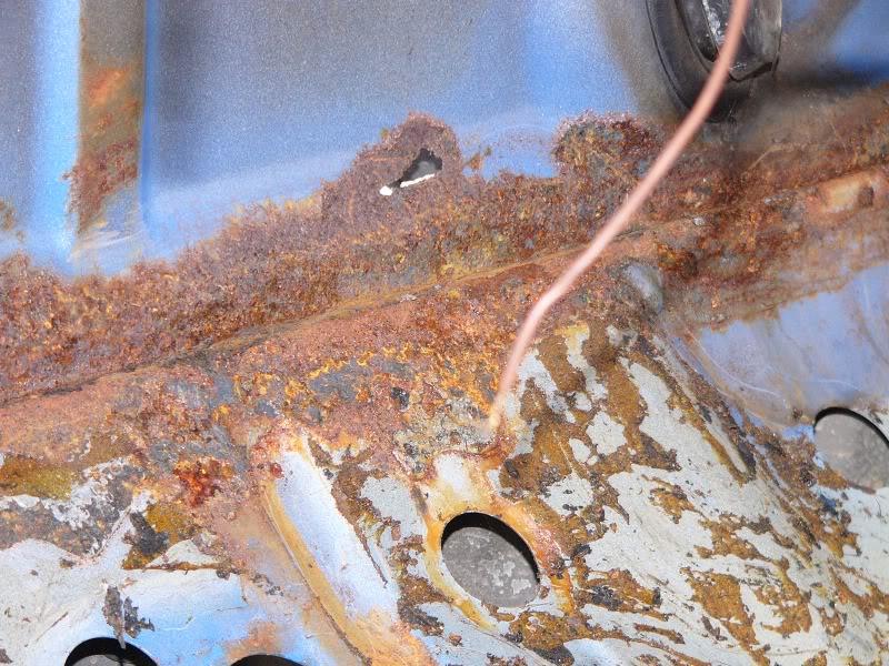

That seam accross the firewall looks worse than it is. It's perforated in a couple of spots but mostly it's surface stuff that will clean up OK.
I'll be seam welding the car so it's got to go to the sand blasters in anyway to chase out all the seam sealer. I'll get them to hit the rust hard.

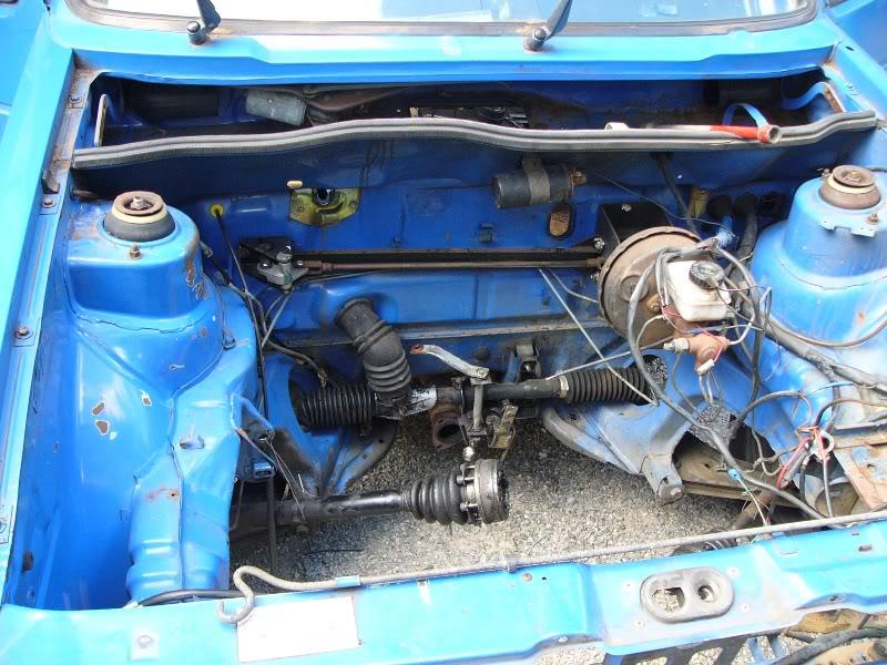

Here's a pic to keep you all guessing for the moment.
