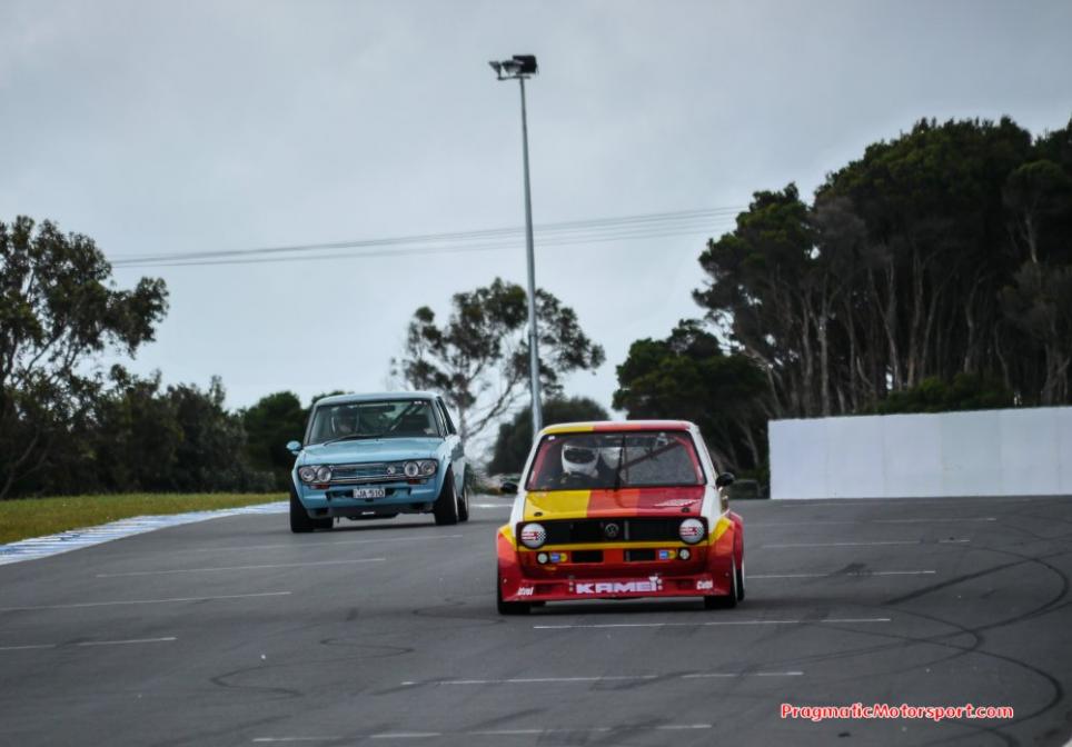

    • Turn a bit too soon in round two there Pete?
      How's the engine tuning coming along, still fiddling with it, or it's more or less sorted?
      s
      • Going too fast and stayed on the brake too long
        Engine needs more tuning, it's running in nicely but there's a lot more to be had yet.

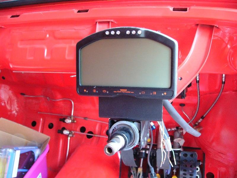

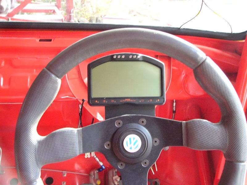

                  What sort of digital display are you using and where is it positioned? I know what you mean about time being rushed. I'm curious about position as I struggle to focus on anything outside my line of vision or in other words outside of the steering wheel position. The shift lights seem seem like a perfect solution. Do u have any photos of your console setup, if that's not asking too much.
                  • There's a bunch of pics of the dash setup on page 47. It's directly behind the steering wheel.
                    It's a Race Technology Dash2 Products » Display products » DASH2 - Racing - Race Technology Ltd - Automotive Technical Excellence
                    Here it is through a dummy wheel I was using for mock up.

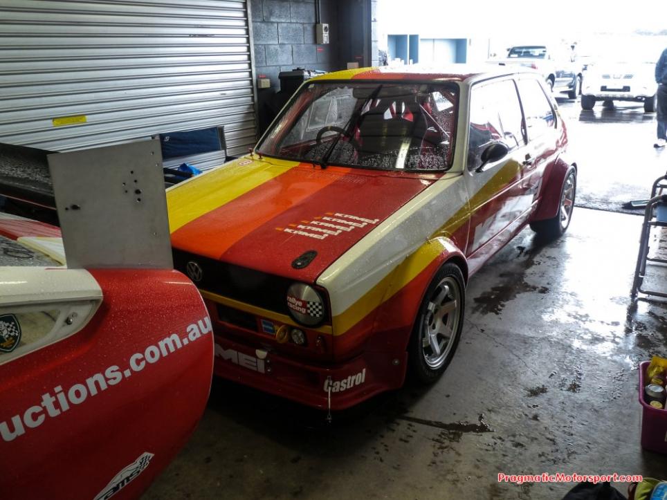

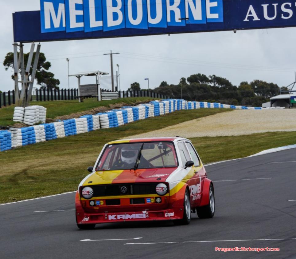

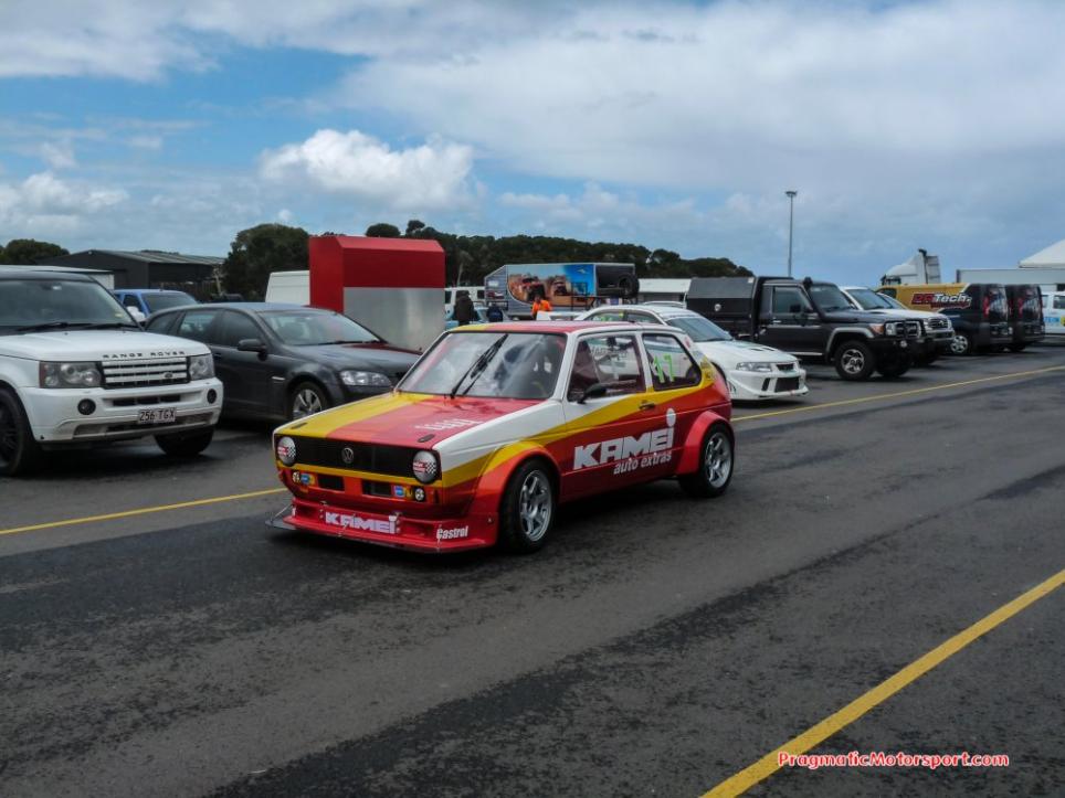

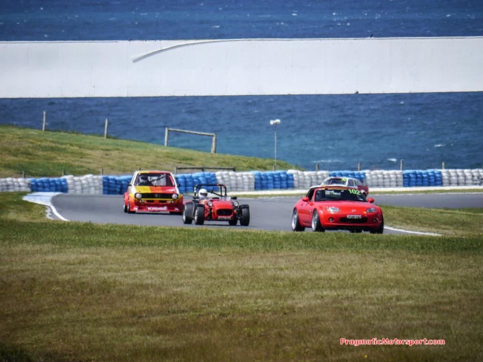

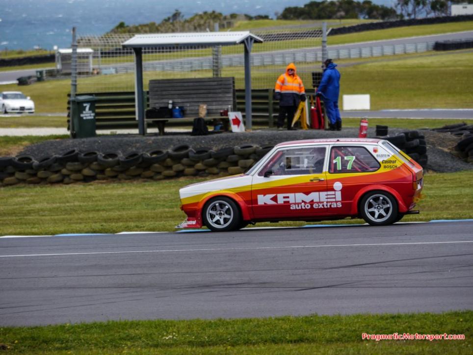

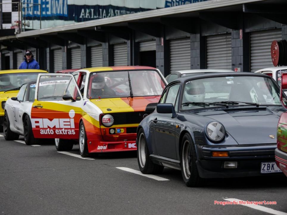

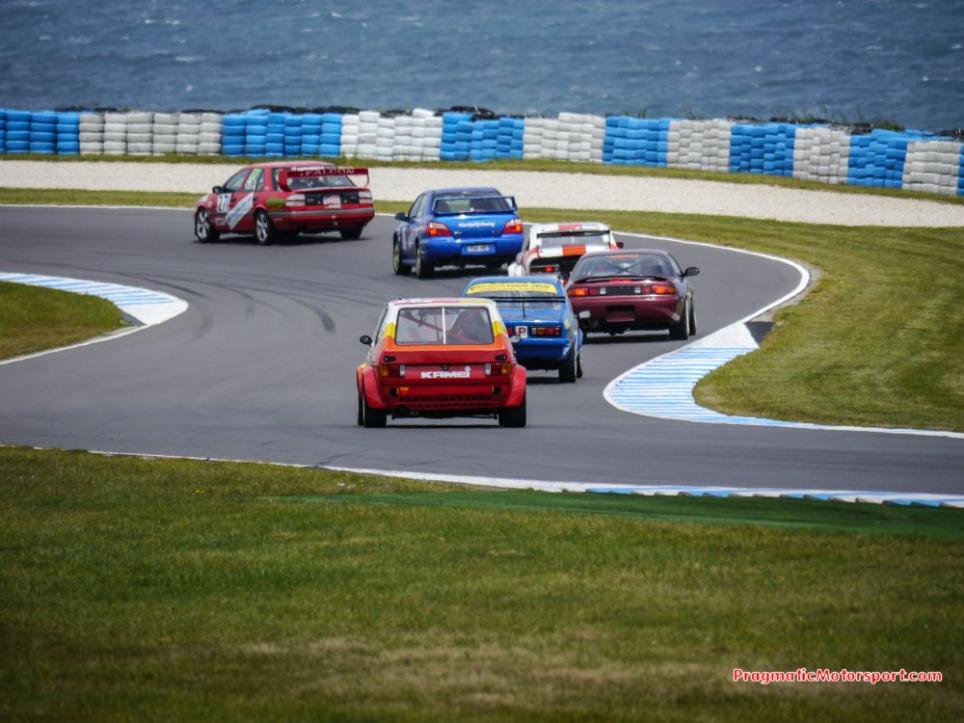

                        • Had one dry run today and ran a 1:56.
                          Getting faster! Another full day tomorrow.
                          Here's some pics.

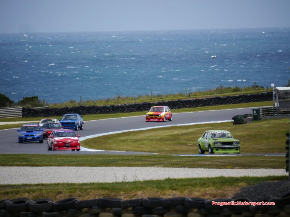

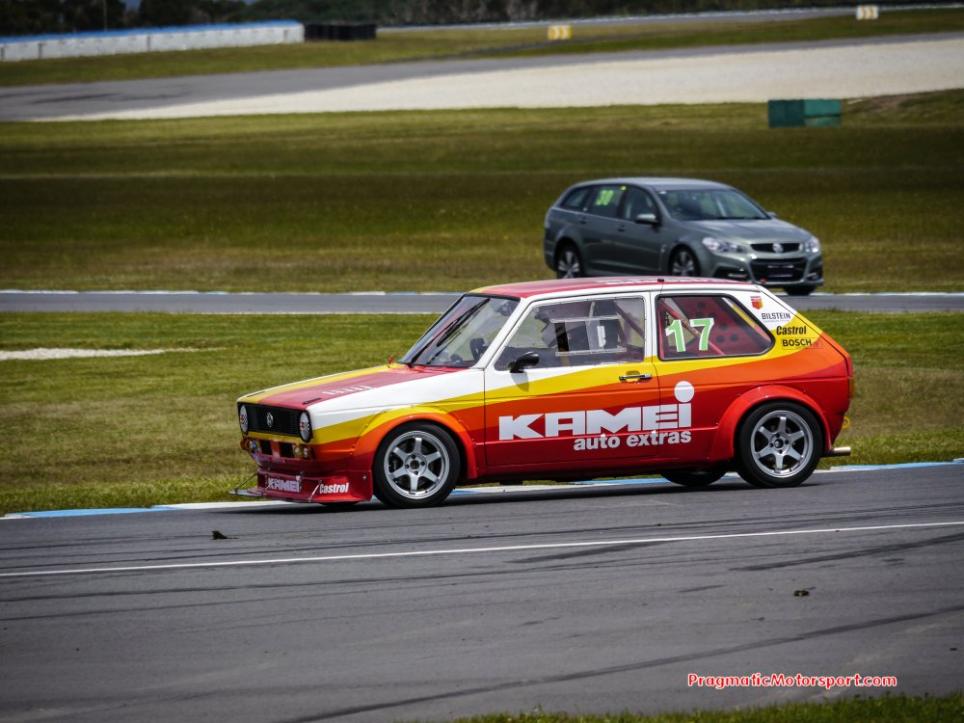

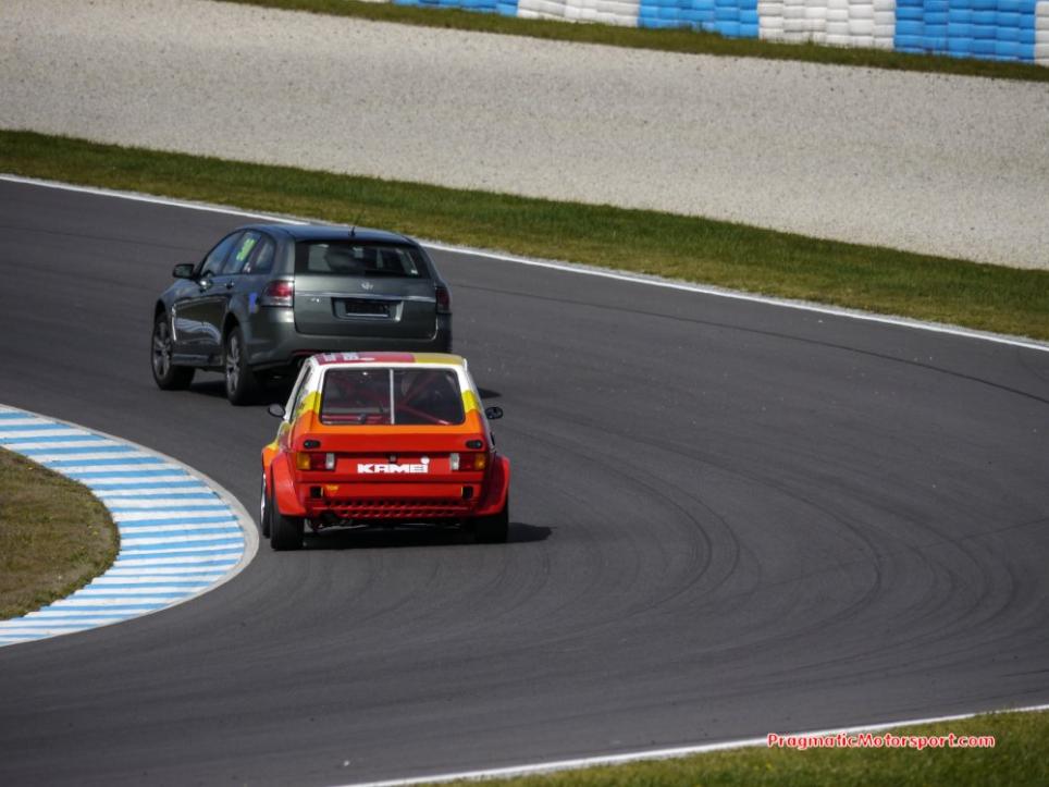

                          • Well done. The mk1 is looking really stable on the track, as opposed to that commodore behind you in the 3rd last pic

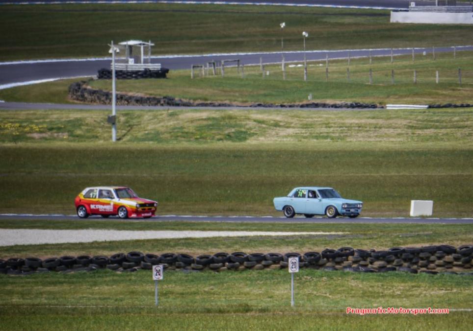

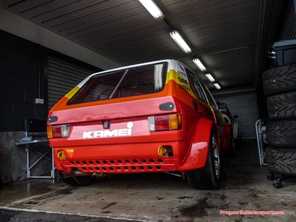

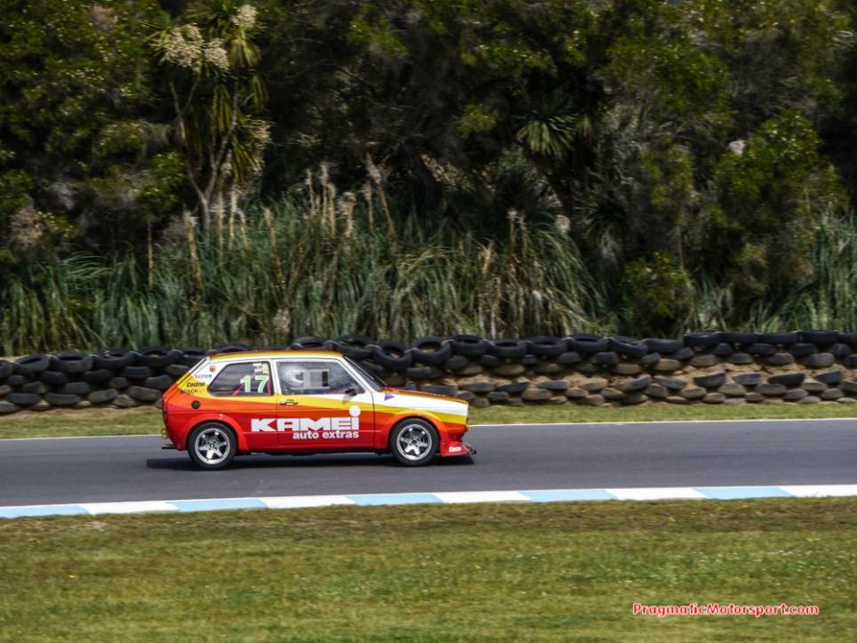

                            • More pics from today.
                              Had to retire early due to a suspected broken CV.
                              (Most likely CV, maybe gearbox, won't know exactly 'till I pull it apart.)
                              CV failed under power, it's the first time I've had the Hoosier R6s fully up to temp.
                              Normally I can spin the wheels out of a corner but with the Hoosiers hooked up the CV (or gearbox) copped the full output of the motor.
                              These were new EMPI 90mm axle assemblies. I'll be fitting a modified 02A box with 100m CVs soon.
                              The noise as pretty impressive, I'll post a video.

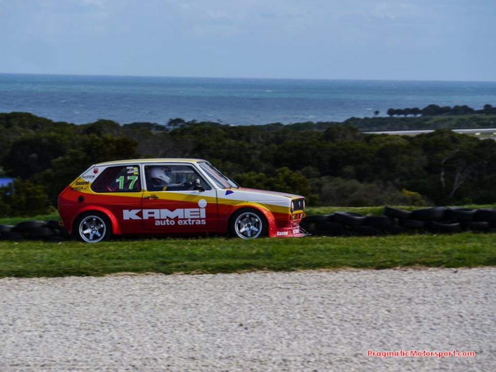

                              Here's some pics from today
                              7? MK1 Caddy
                              79 B1 Passat Dasher Project
                              12 Amarok
                              • Great pics, you can see from that wagon that the MK1 is certainly planted into that bend.
