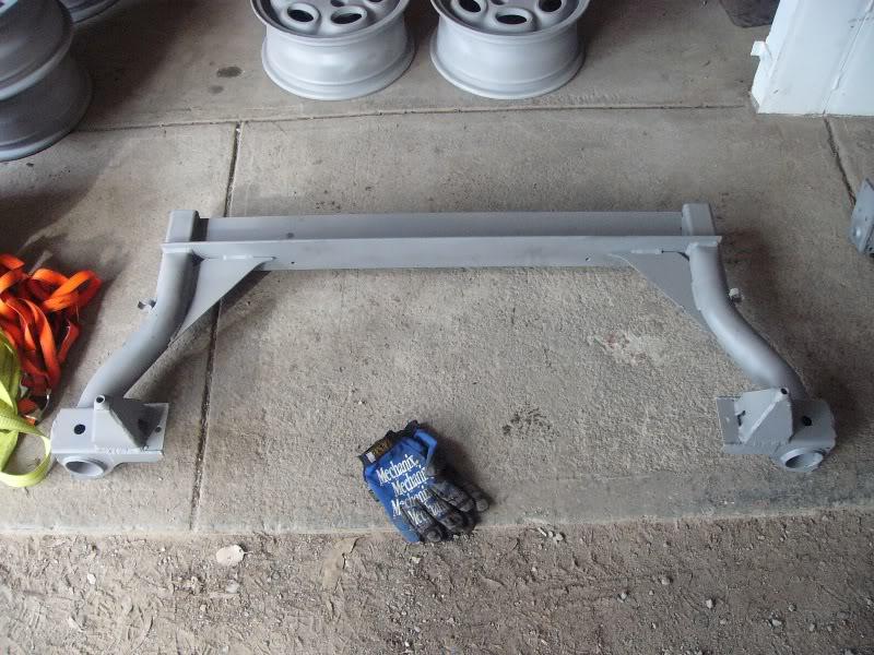

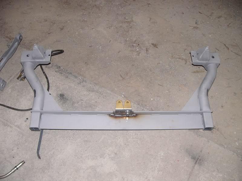

                            • Had a bunch of stuff sandblasted a couple of weeks back so I had the rear beam cleaned up too.

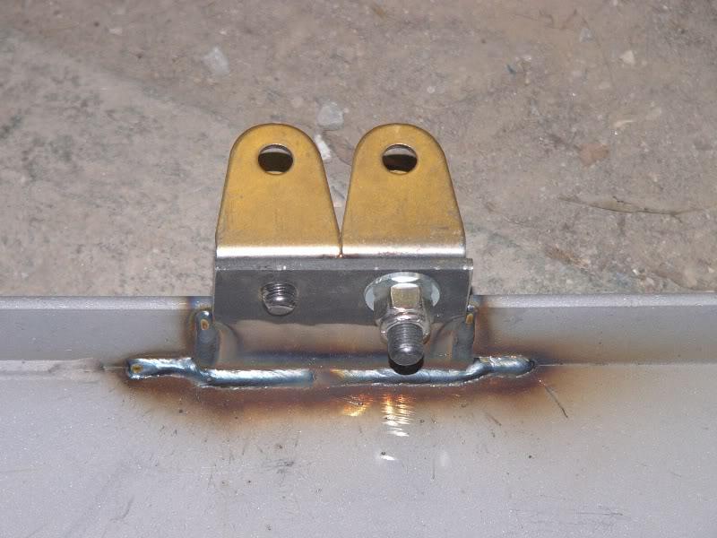

                              I added brackets for disc brake hoses and for the rear toe stabilisers.

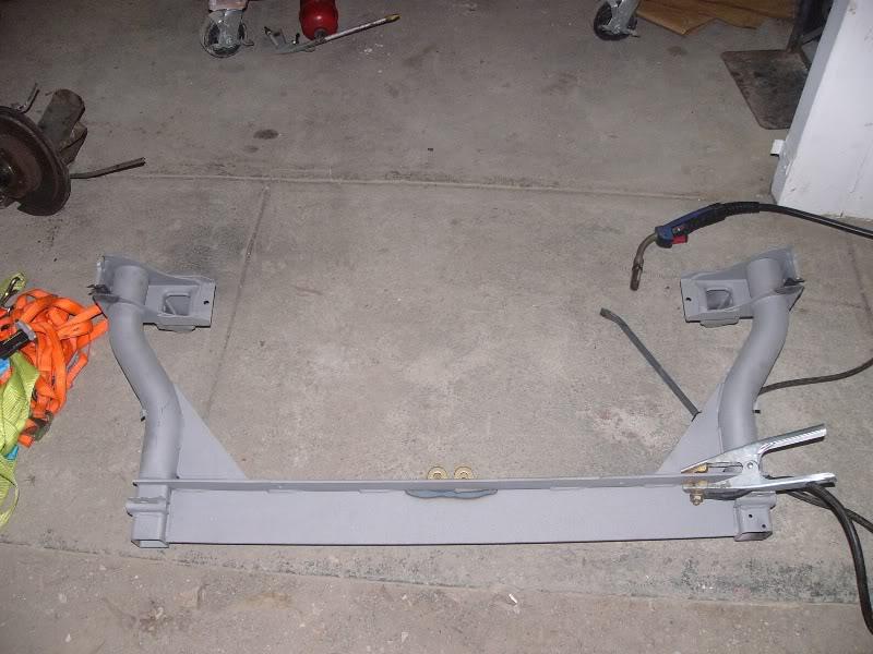

                                I got a bunch of other brackets and stuff powder coated in black. Here's the freshly blasted, coated and re bushed pivot mounts.
                                Made up some new brake lines for the beam, I'll tweak the bends a bit more once everything is bolted up.
                                Bolted up the toe stabilisers to check fit.
