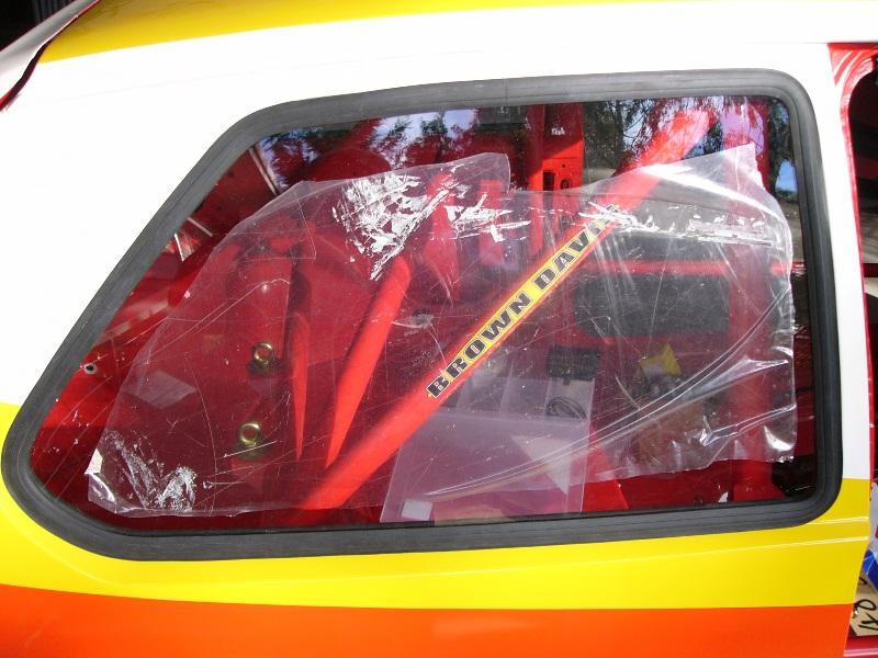

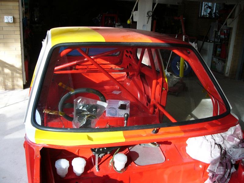

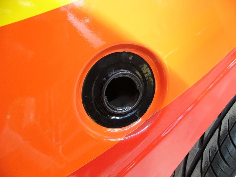

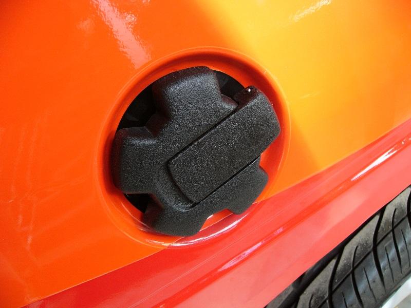

        • A small detail, I cut a vinyl sticker for the fuel filler.

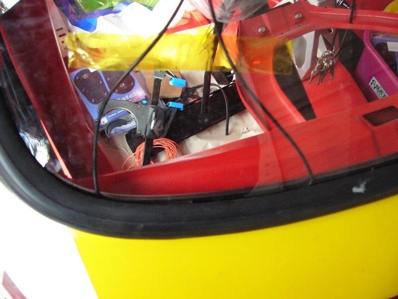

          Back windows are in. CAMS says that the roll cage manufacturer's name must be visible through the back window hence the stickers.
          I'm leaving the cling film on the perspex for the moment just to save it from scratches and dust.
          Here's the windscreen just sitting in place. I've booked a pro in to fit it on Saturday morning.

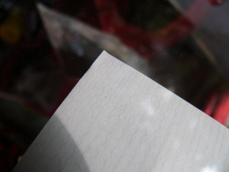

          Normally I'd fit it myself but I've got a lot invested in this screen. It's an electrically heated unit from Ricky Evans motorsport.
          Heated Windscreens
          It will be a long time before I get the opportunity to ship another one of these.
          The heating elements are very fine. Here I'm holding a piece of paper up against the inside of the screen so I could photograph them.
          The screen is dived into separate sections for driver and passenger sides.
          The connections just come out from between the glass and the rubber on either side of the screen.

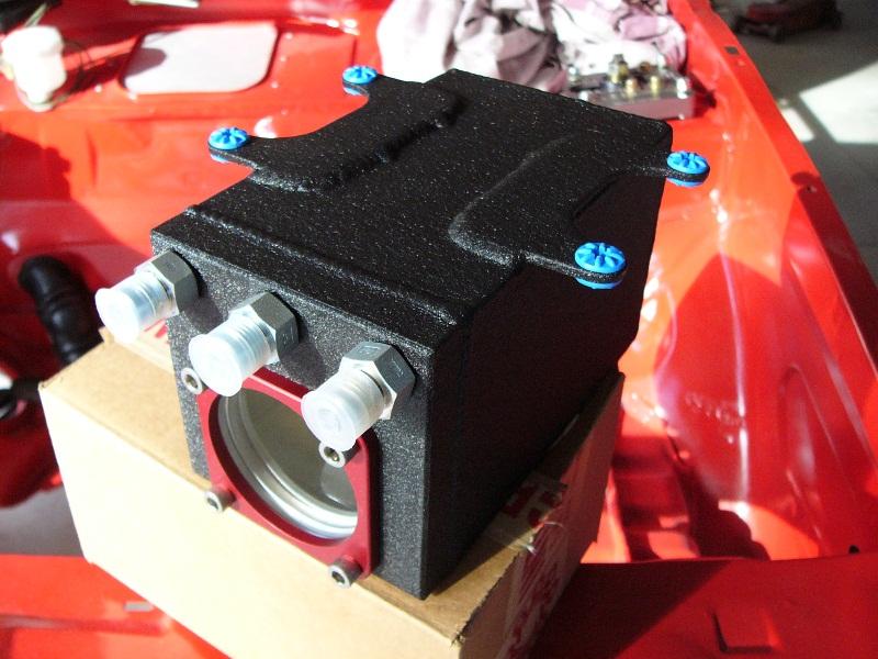

          I've been trying to find a swirl pot that would mount hanging from the floor of the car. Most are designed the other way up to mount in the boot of a sedan.
          This is a brand new design from Integrated Engineering which incorporates the mounting of the fuel pump internally.
          Integrated Engineering Billet Surge Tank- Submerged 044 Pump

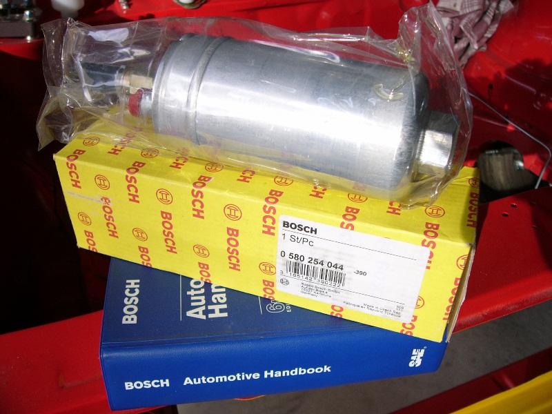

          Here's the pump to go in it. No surprises, it's an 044.
          I've been using the SAE handbook to look up suspension geometry and brake hydraulic info. Great reference for anyone attempting to build a car from first principles.

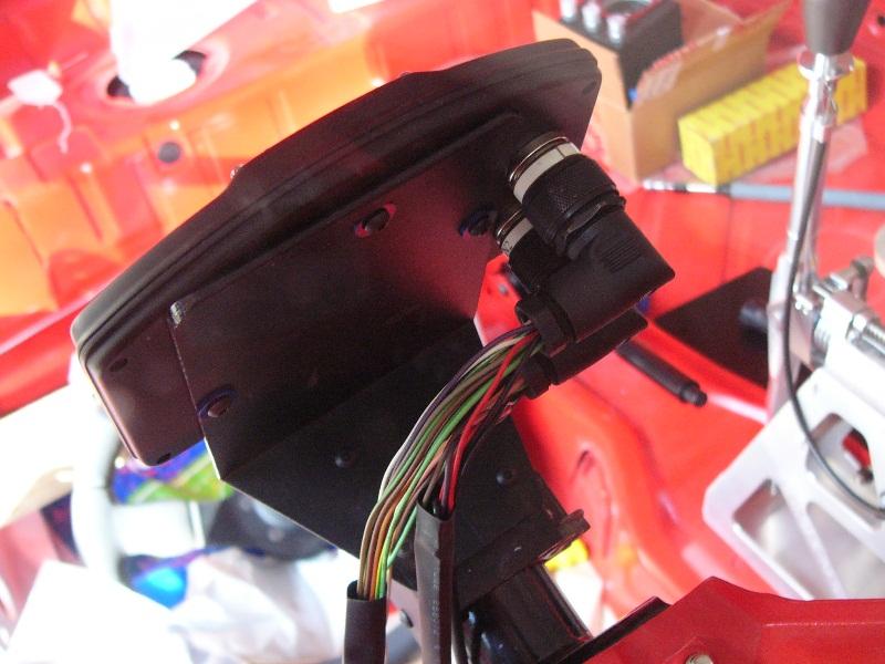

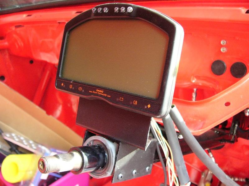

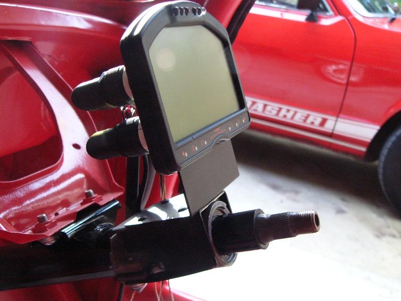

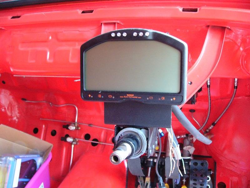

          Mounted up the dashboard.

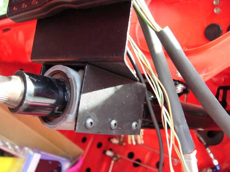

          I folded up some aluminum sheet to box in the remains of the upper column bearing.
          It's secured on one side with 3 M4 screws and on the other by the M8 clamping bolt.

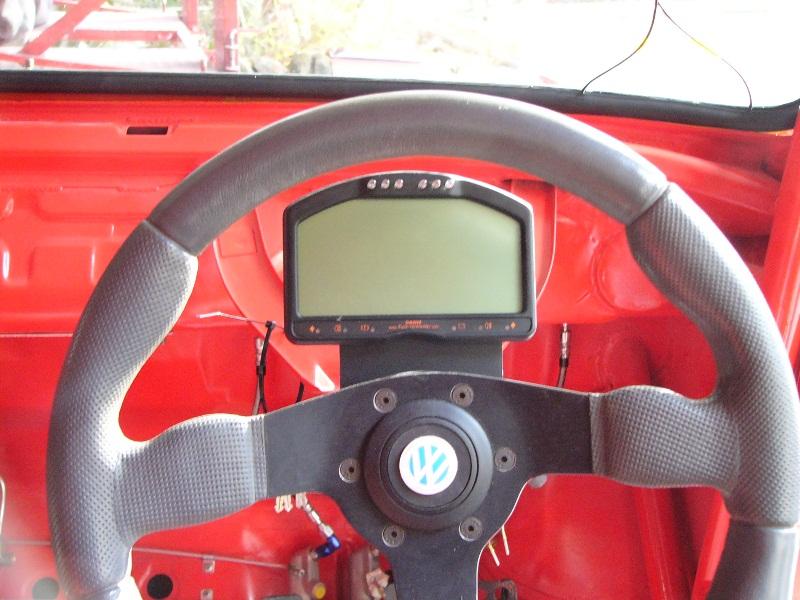

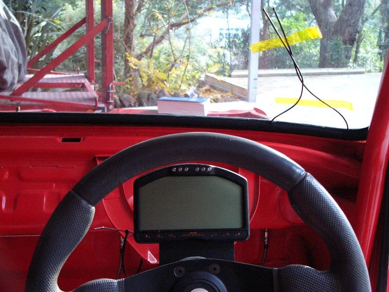

          The sheet is quite rigid, I don't think I'll need a diagonal brace on the vertical section. In any case I need to re-check the viewing angle once the seat is back in.
          Once I've done that I can easily add in a small brace.
          Here's a couple of shots with a dummy wheel on it from roughly the driver's perspective.

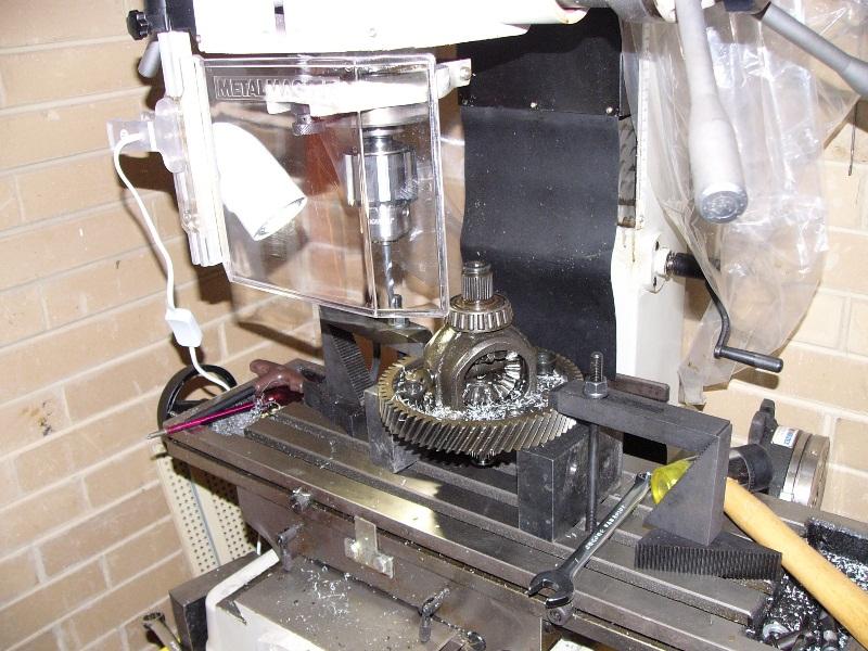

          It's about time to start on another gearbox.
          Here I'm recovering a 3.94 ring gear to go onto that Peloquin I've had sitting about for the last 3 years.

              • The vertical piece that holds the dash up is not symmetrical.
                It annoys me in the photos but I'll get over it. The dash is central to the steering column.
                I would like to point out for the record that the lack of symmetry is caused by the position of the plugs on the rear of the unit and the ridiculous positioning of the mounting holes!
                The manufacturer decided to randomly place the three screw holes across the back in no discernible pattern. I don't know why.
                I suppose I could have made the bracket look wider but this build isn't about looks.
