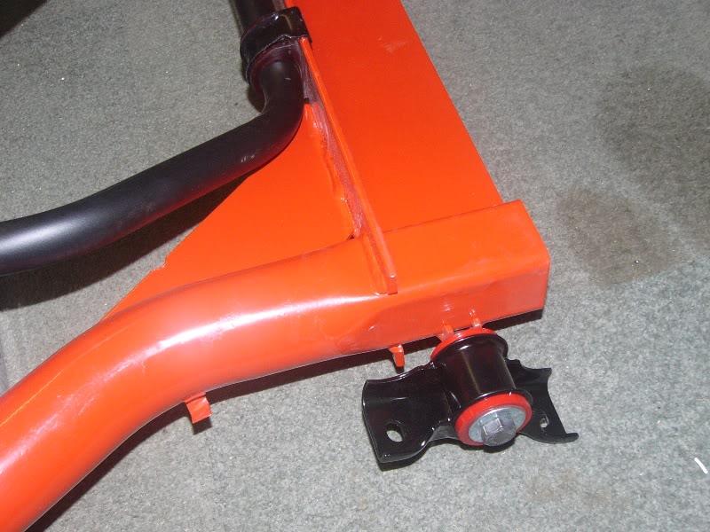

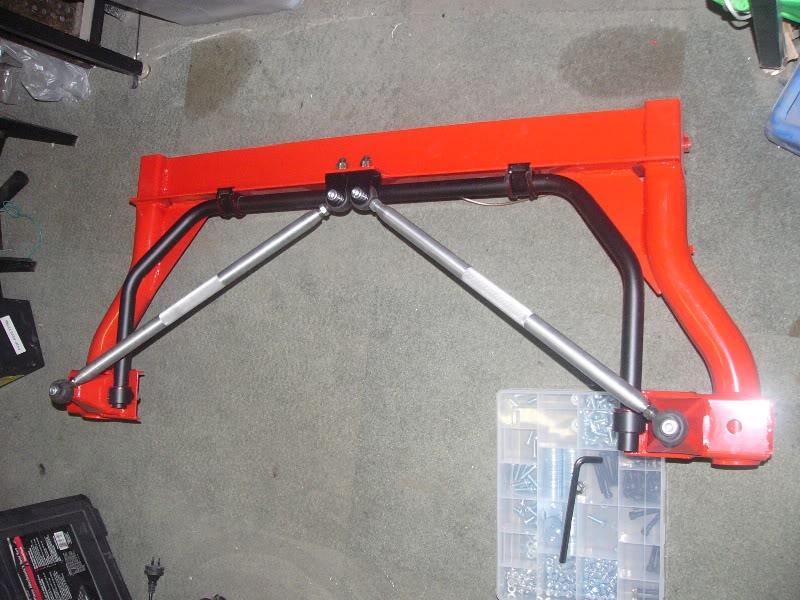

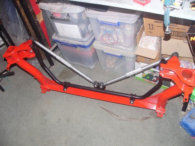

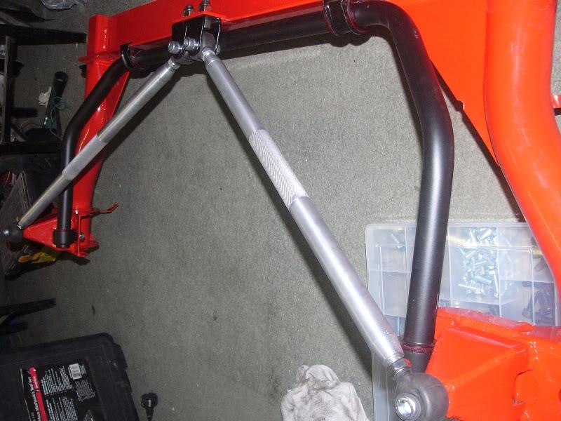

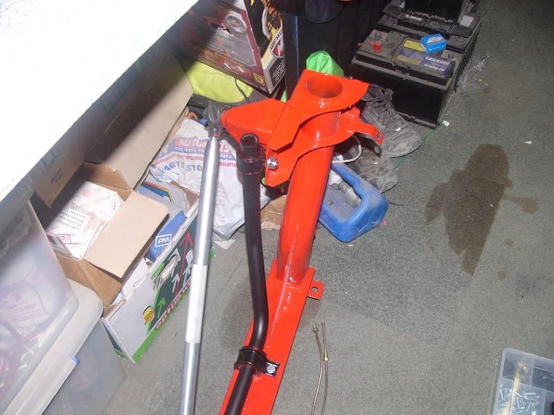

  • Fitted up the sway bar, had to fettle with the bolts on the centre stabiliser bracket to make it all fit nicely.
    Mounts on.

    • Looks the goods, Pete! Glad to see the SCCH gear worked out nicely.
      The red is a bit unusual.. But hey, you're the man doing the work and paying the bills! haha.
      • Looking good Pete!
        • Did you consider stiffening up the beam itself rather than adding the rear anti-roll bar or do you want to be able to remove the bar for running in the rain?
