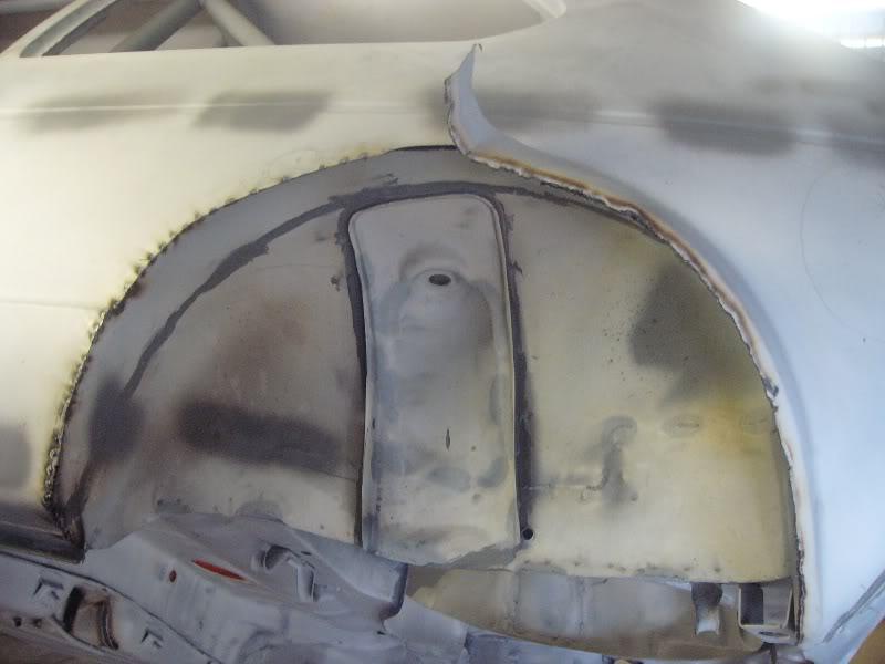

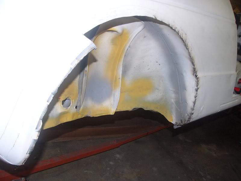

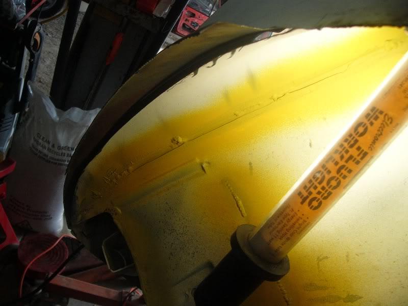

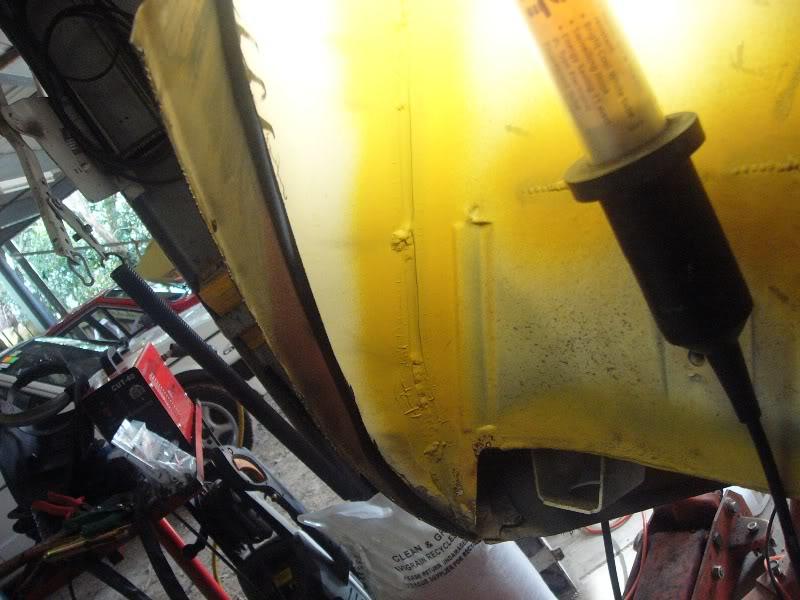

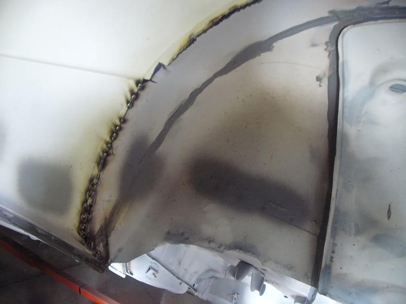

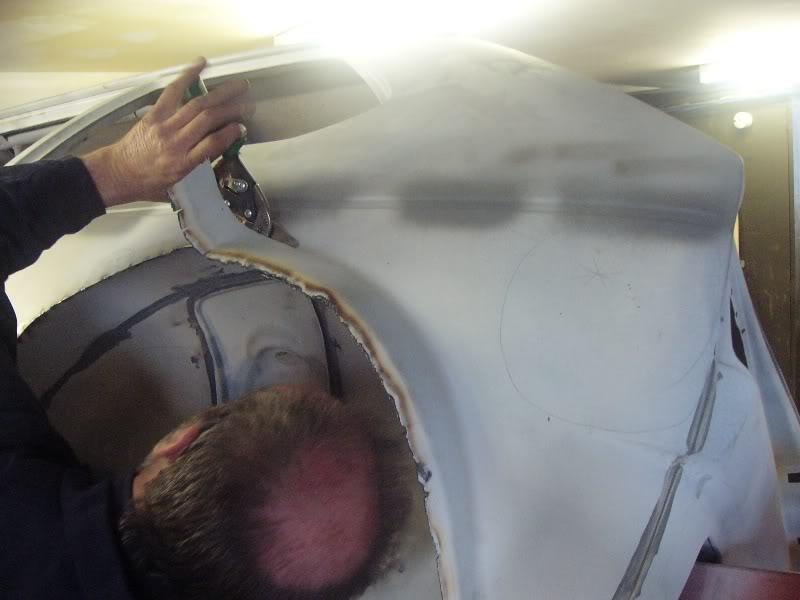

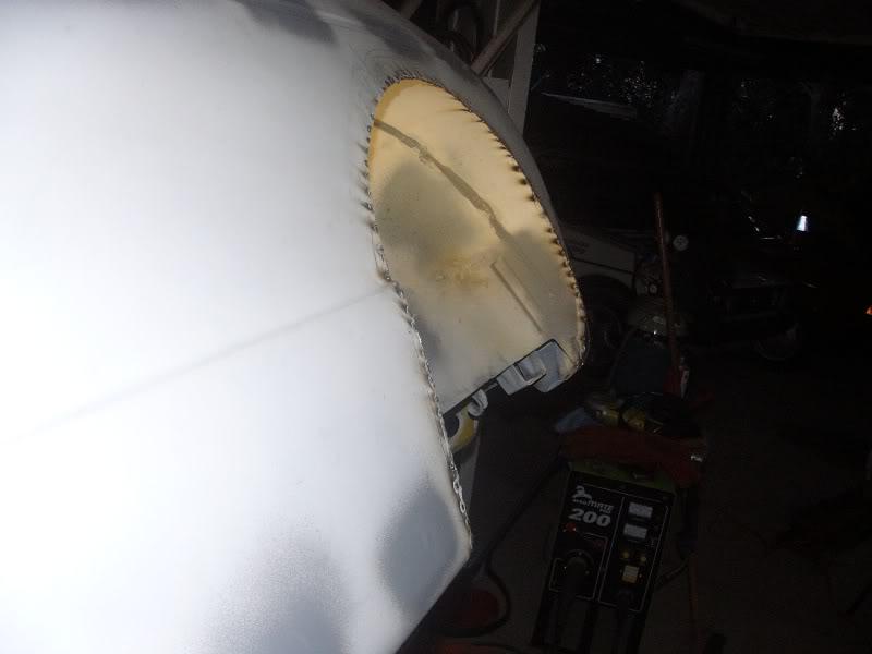

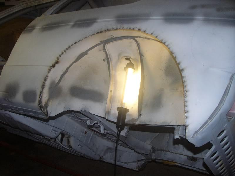

    • Next big job, tackling the rear guards.
      To run wide tyres you have to trim the arches right?
      Quite a bit of work in it, you have to leave some of the original flared outer skin to re shape down to the inner panel.
      Just all tacked up at the moment, next job is to finish the welding, tap it out and grind it down.
      Once that's done It'll need just a little more bumping to flatten it all out.
      Then I suppose I can mount the Berg Cup flares up.

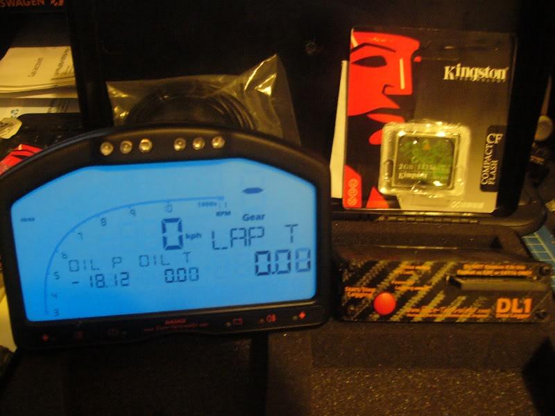

                • Sometimes you just get lucky on eBay.
                  Picked this Race Technology DL1 logger and Dash2 up for well less than 1/2 of retail.
                  Don't really need it yet but it was too good a buy to pass up.
                  Just building a test rig to learn how to set it all up.
                  If I get time I'll give it a run in the other car at Phillip Island in a couple of weeks.
                  This will save me setting up any other gauges, everything can be configured onto the display and all the sensor data logged.

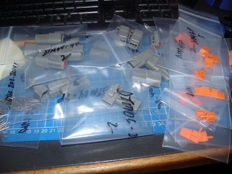

                  Ordered in some Deutsch DTM connectors too, no point in messing about with dodgy connectors. Good thing I know a thing or two about wires.

                  • Deutsch DTM connectors my favorite
                    I could terminate them all day and not need a break haha

                    • There is something perversely exciting about terminating cable and making looms. Everyone always mentions how much they hate it but it super studying when the multimeter plays it's tune.
                      Oh and the dash looks sweet Pete , nice score.
                      Originally posted by Preen59
                      • Cheers guys,I'm most of the way through temporarily mounting the dash into my other car.
                        There's a whole new level of expertise required to set these things up.
                        A lot needs to be configured, giving it all a trial run in another functioning car is a really good idea to develop the skills needed to set it all up.
                        The manual actually recommends setting it for the first time with no external inputs so that debugging is easier.
                        The logger is configured by a file on the CF card which you create with a computer program and the dash is configured over its serial port by a different program or by another file on the CF card.
                        Being English manufactured there's an inherent obscurity to the usability. Definitely a case of designing the functions first and only considering the end user experience as an after thought.
                        Once you get in the mindset though it's al pretty logical.

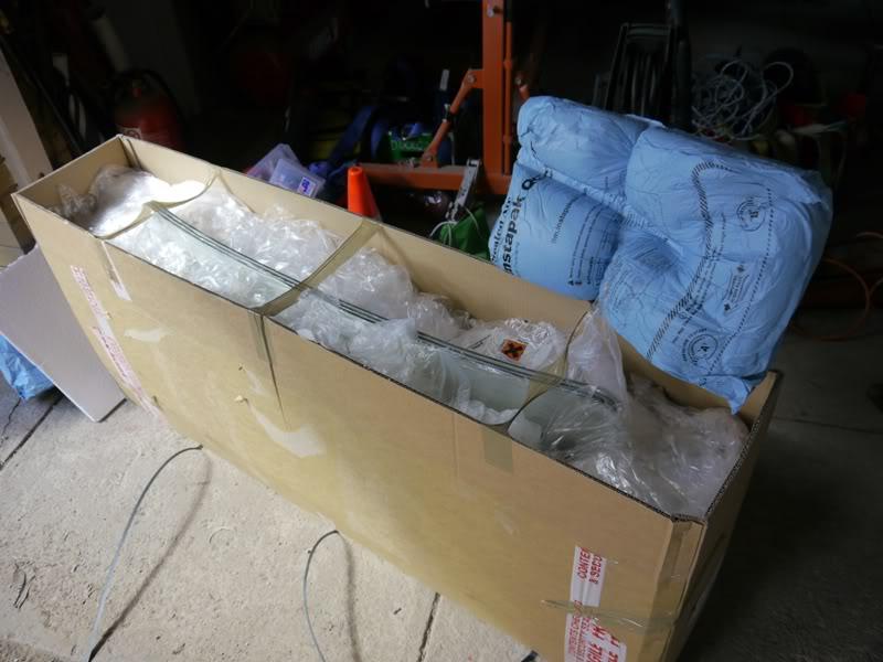

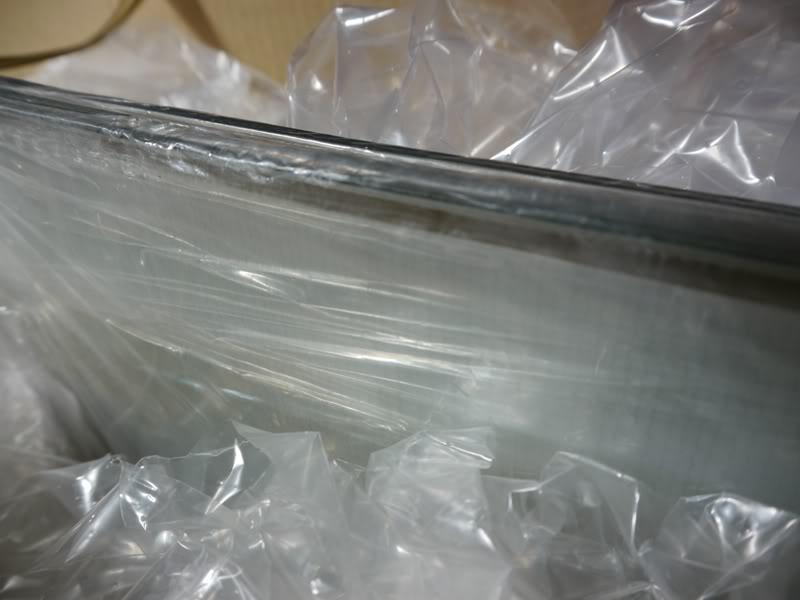

                        • Picked up some windscreens today.
                          Big logistical effort to organise these. They'd have to be the only MK1 heated windscreens in Oz.
                          (Before anyone asks, they're all spoken for.)

                            • Score, did you get them in the club gti group buy???
                              • Originally posted by alex g View Post
                                Nope, purchased direct.
                                I had a brief opportunity to score free and delicate shipping from the UK so I saved a heap on the freight/import.
                                I would have grabbed more but this was all they had in stock until the next production run and I had to move fast on the freight offer.
