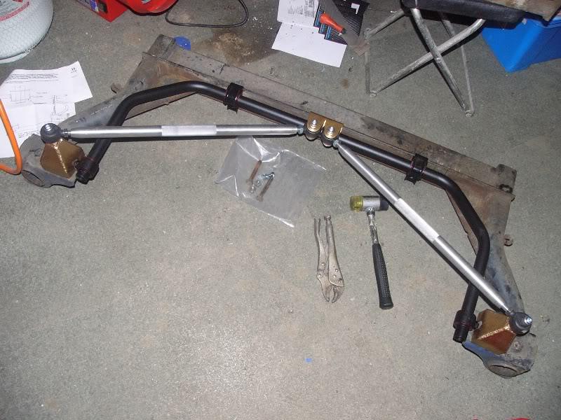

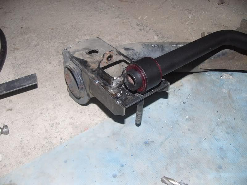

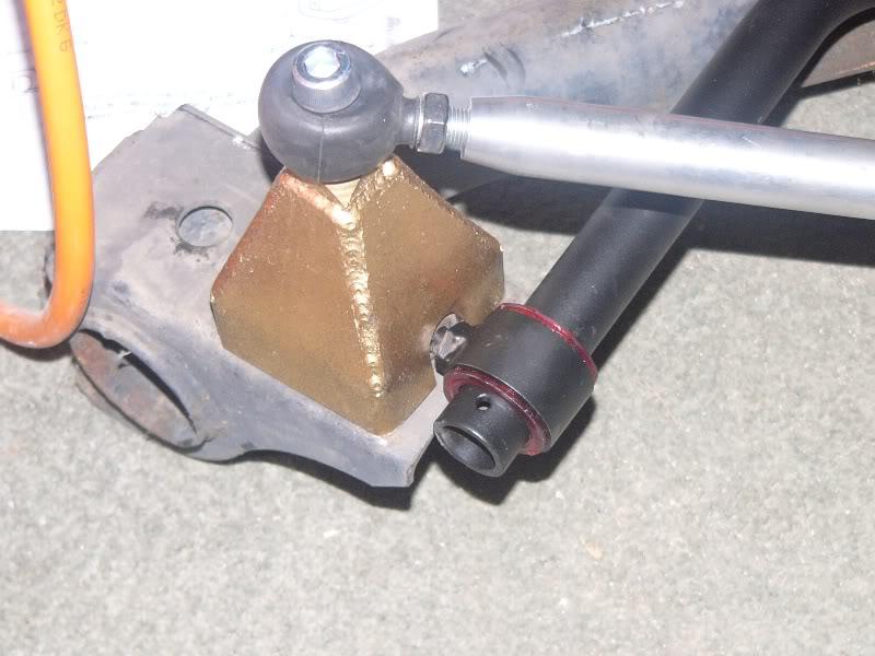

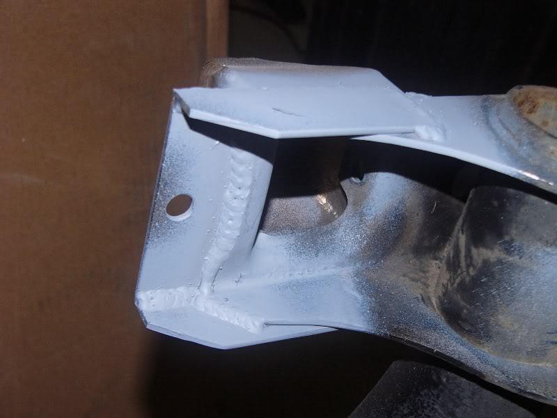

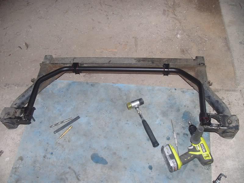

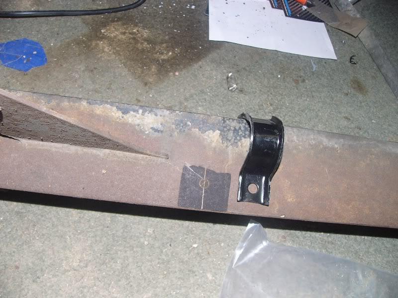

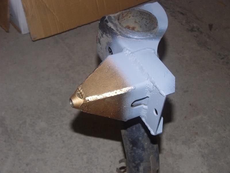

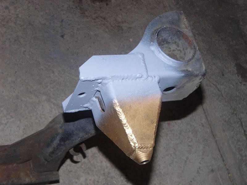

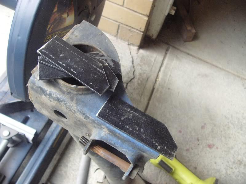

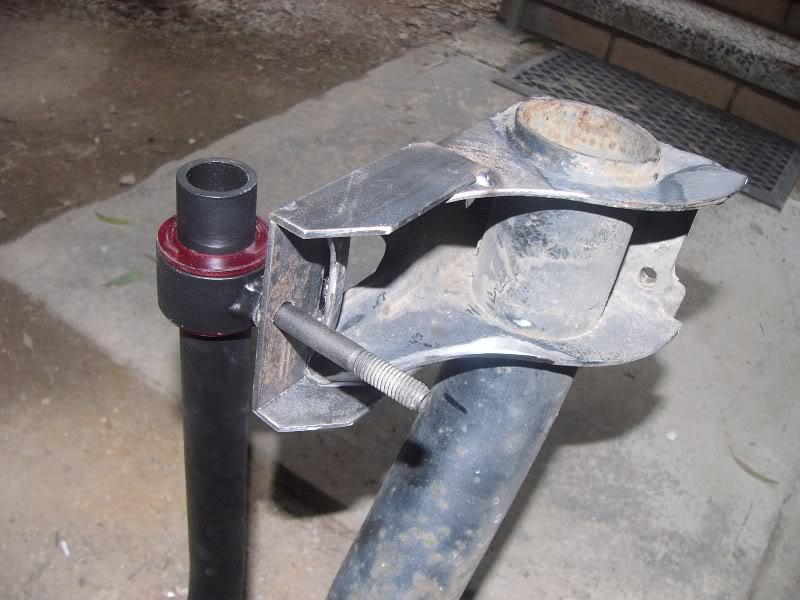

      • I had to set the welder up for heavy gauge stuff this weekend to put another jerry can holder on the trailer so I thought I'd do a bit of work on the rear beam.
        Once I've finished modifying it the plan is to get it sand blasted and powder coated.
        I'm not done yet, I need to find a piece of 6mm plate to make another bracket out of.
        I extended the shock bases so I can mount sway bar mounts 90° rotated rather then use them as shock bolts as the designer intended.
        They had to be done like that or removing the shocks would mean removing the entire sway bar every time. This way I can just undo the ends and rotate it out of the way.
        Shock bolts will remain a bit fiddly, I'll have to use socket headed bolts.
        Here's some progress shots

        • Good to see you got it done, once i got out of your way! haha
          Welds look great.

            • That rear beam is gonna be super stiff with the combo of the two.

                      • Is there any advantage in moving the sway bar mount further forward so it doesn't foul the shock bolt? Looks like you've got a bit of room to play with.
                        Originally posted by Peter Jones View Post
                        • Originally posted by sports racer View Post
                          I set the mounts as far back as possible for maximum leverage. I could move them forward a bit but the bar itself will still be in the way of the shock bolt.
                          I've now threaded those bolts all the way down and I'll cut them to length.
                          The mount doesn't foul the bolt as such, it just makes access to it a bit fiddly. It's further complicated by the drop towers for the diagonals.
