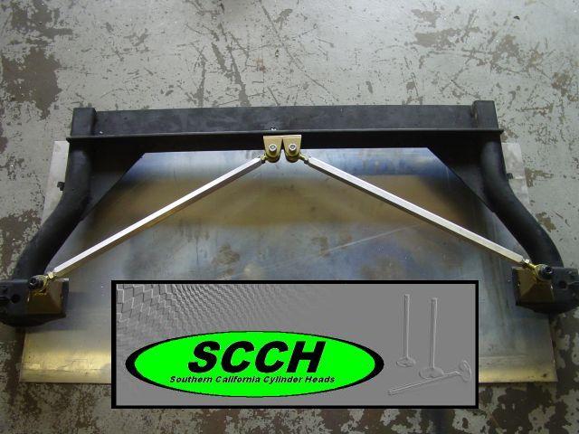

          • i'm just trying to figure out how thsoe rear toe rods work? i'm guessing they work in conjunction with the sway bar to stop movement in the rear beam? These would be common in a car with independent rear suspension?
            • They stop camber & toe in changes in the rear axles under heavy corner loads by preventing the trailing arms from twisting.
              Southern California Cylinder Heads
              The VW rear torsion beam is a fast and effective way to get the rear of these front wheel drive cars rolling,unfortunately when subjected to sever lateral g forces it has a tendency of flexing inward or outward causing unwanted toe changes in the rear end of the car which leads to a more unpredictable driving environment.
              A young italian Mechanical engineering student who was using his Golf MkI to compete in local racing events realized the unwanted effects of the tow changes in the rear of his car, After some thought he came up with a simple yet effective solution to fix this problem. Thus was born the rear torsion beam toe stabilizer bar!
              SCCH is proud to now offer the SCCH/Cavedoni Mk I Rear Beam Toe Stabilizer Kit.
              The Toe rods are constructed out of 6061 aluminum, while the drop towers use 1/8" steel before they are TIG welded together. In addition SCCH uses only the finest PTFE lined rod ends seal it washers and hardware to hold the kit together.
              NOTE: Some welding is required to install the SCCH/Cavedoni Rear Beam Toe stabilizer kit to your car and the modification is permanent.SCCH recommends you consult a certified welder for this application.

              • Originally posted by Peter Jones View Post
                ah k yeah nice...geese mine handles extremely well with gti sway bars & vw motosport strut braces...this is just going to be something else! i can't imagine what it would be like, keep it up pete! a serious race car this will be

                  • The tie rods only really need to be fitted if you have enough grip to bend the rear arms in during cornering.. On an everydayer or a weekend warrior car like mine will be I doubt they'd make much difference.

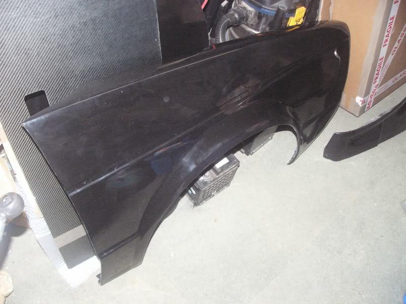

                    • More parts of the puzzle have arrived over the last couple of days. A lot of long term planning is starting to come together.

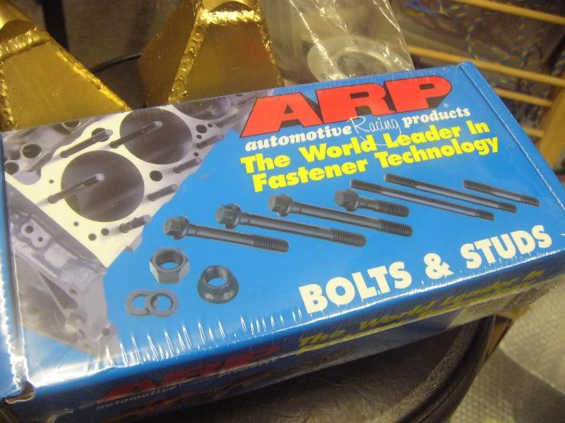

                      Head studs for the ABF from Valver. Bit premature for these yet, I'm trying to keep my focus on the body work, but they became available so I grabbed the opportunity.

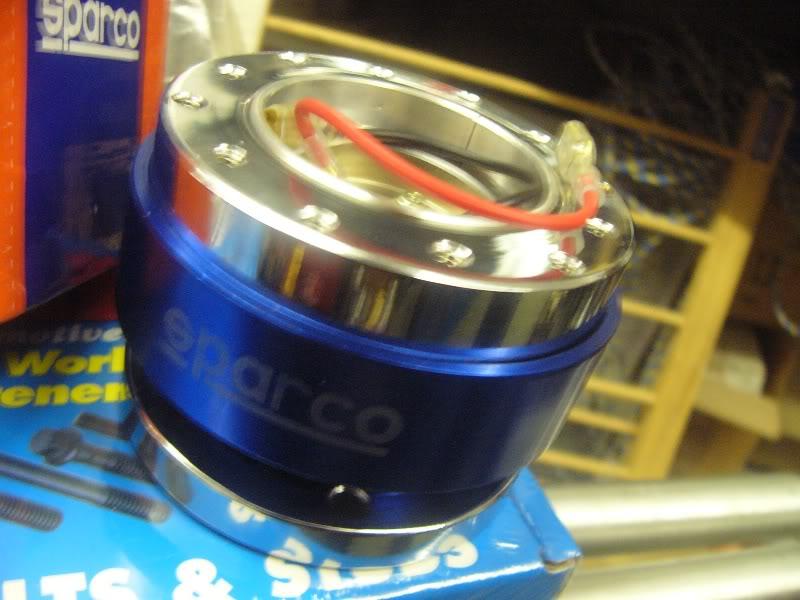

                      Sparco steering wheel quick disconnect. Need this to figure out seat and control placement in the cabin. I'll need to get the seat mounts sorted soon as I'm rapidly approaching undercoat stage.

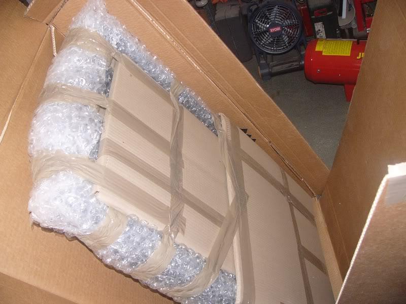

                      And a big box from Performance trim.
                      These guys do a nice job of packaging.

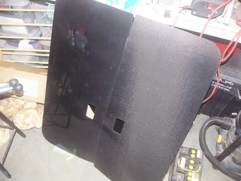

                      Door cards, only 600 grams each.
                      I'm required to have door cards as a safety measure, this seemed a reasonable solution.
                      Fibreglass front guards, 1.6kg compared to 4kg for an unpainted steel one.
