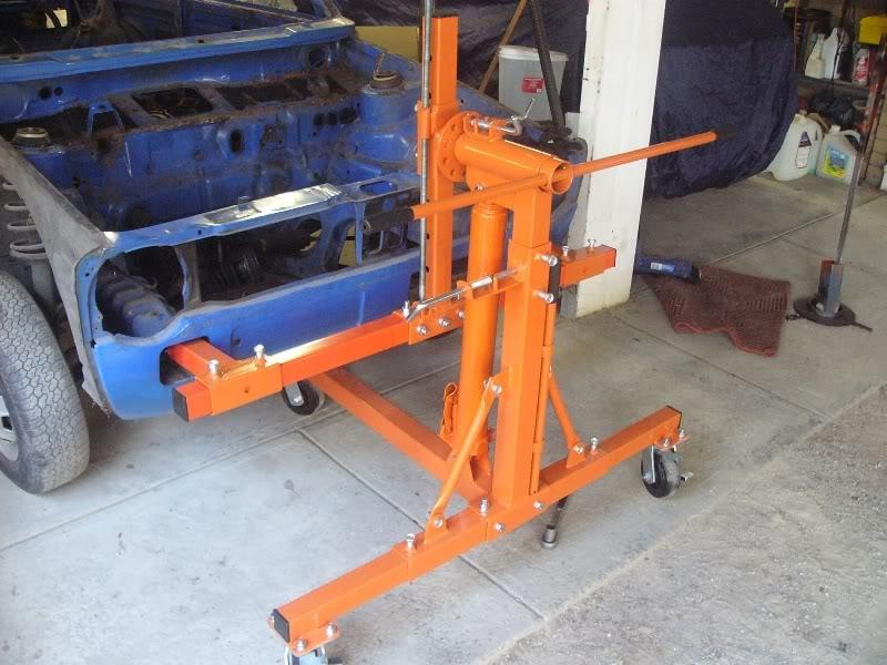

        An excellent tool Pete, and your right, buying one definately saves time and energy.
        You will pretty well be able to do all the welding in the optimum position, well worth the investment.

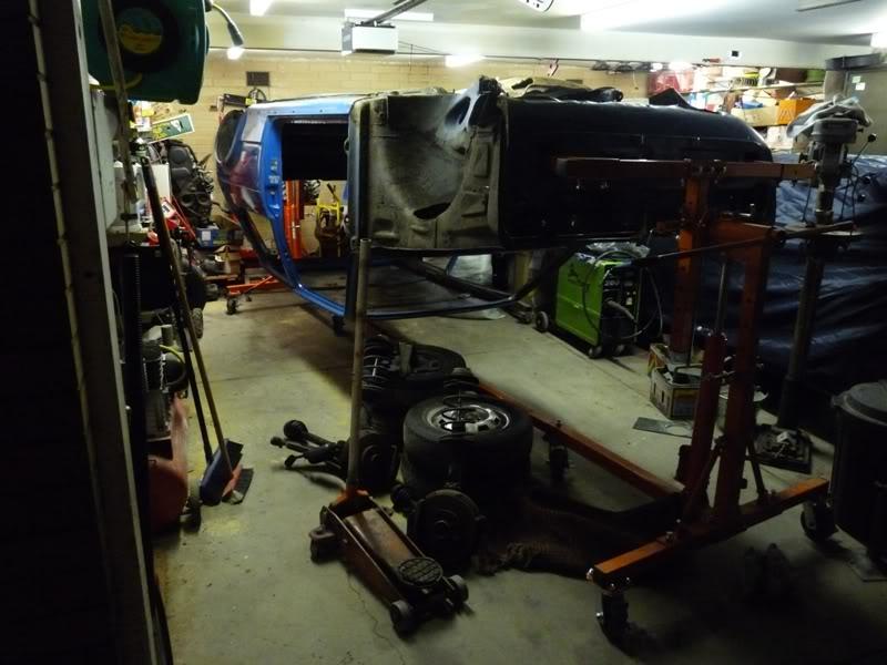

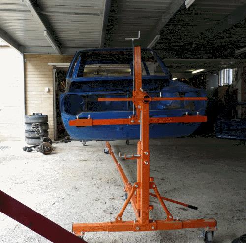

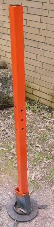

          Bought some steel today, drilled some holes in it and painted it orange.
          Bolted it up.
          and up she goes.
          Tomorrow I'll pull the suspension out and have a go at flipping it over

          • #95
            Colour matching skills are lacking...
            • #96
              It's not Red! is this a new direction Pete? i doubt it! hahah
              can't wait to see it's guts!
              • #97
                I must imagine how helpful the spit roast is when it comes to full restorations.
                Good work Pete, will be looking forward to see the final product.

                  Wheeeeeeeeeeeeeeee!

                    Nice!! That'll help no end for most jobs!!

                        • Very cool. As long as thats the only 'rolling' that car does!

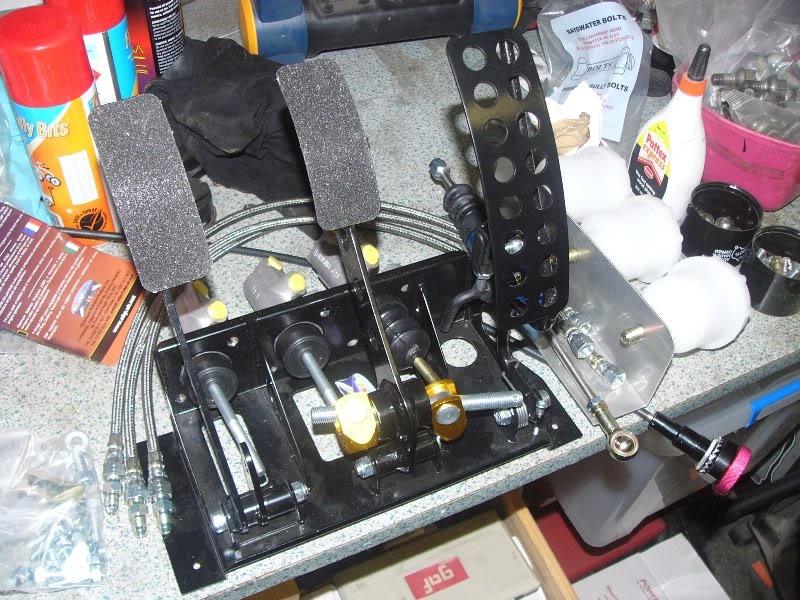

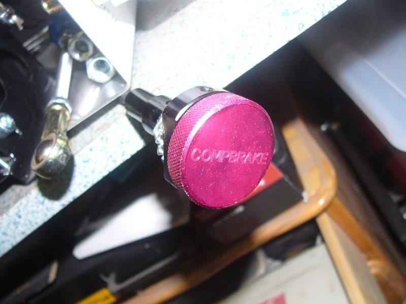

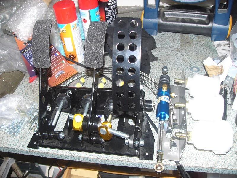

                          • As I get nearer to getting the cage in I need to make some decisions about where things go in the cabin. To do that I need the hardware.
                            With the dollar so strong at the moment it was time to go shopping.

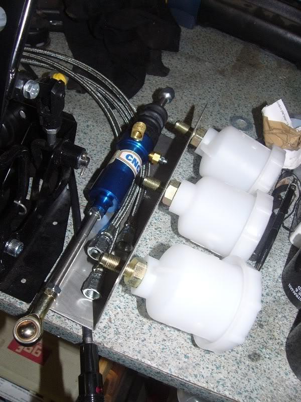

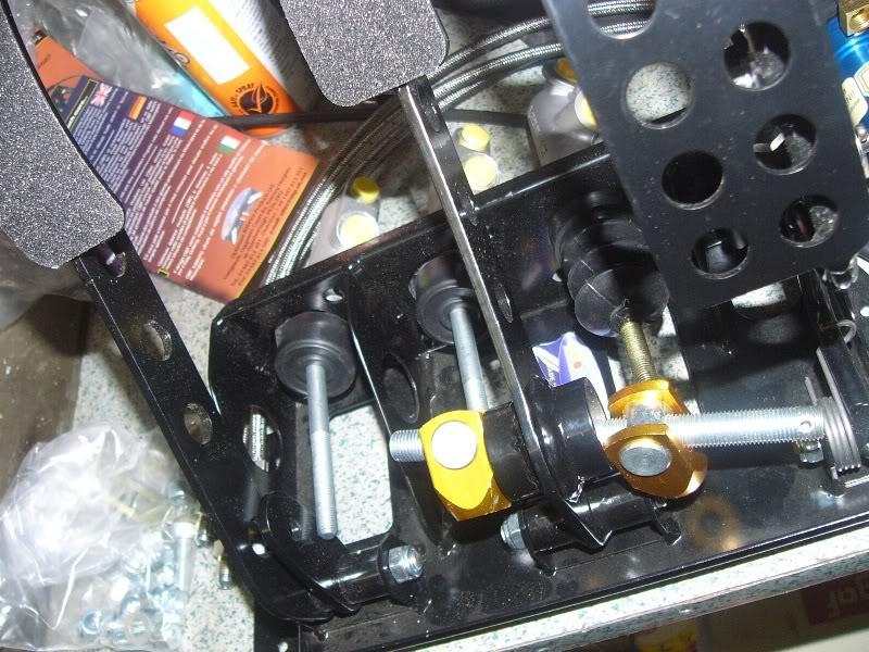

                            Pedal set is OBP with 0.750" cylinders for the Clutch and rear and a 0.625 for the front brakes.
                            Clutch slave cylinder is by CNC brakes, I'll continue running the 020 boxes for now so I'll need this to pull up the clutch lever. I need to go hydraulic as my knee is shot and won't take the abuse any more.

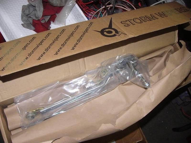

                            Wanted to sort the wipers too as I might take a bar across the scuttle in lieu of a strut brace bar. This is a storm wipers single wiper kit, I'll be adapting a MK3 wiper motor to a MK1 frame and then applying the single wiper conversion. It'll be mounted dead centre and parked upright.

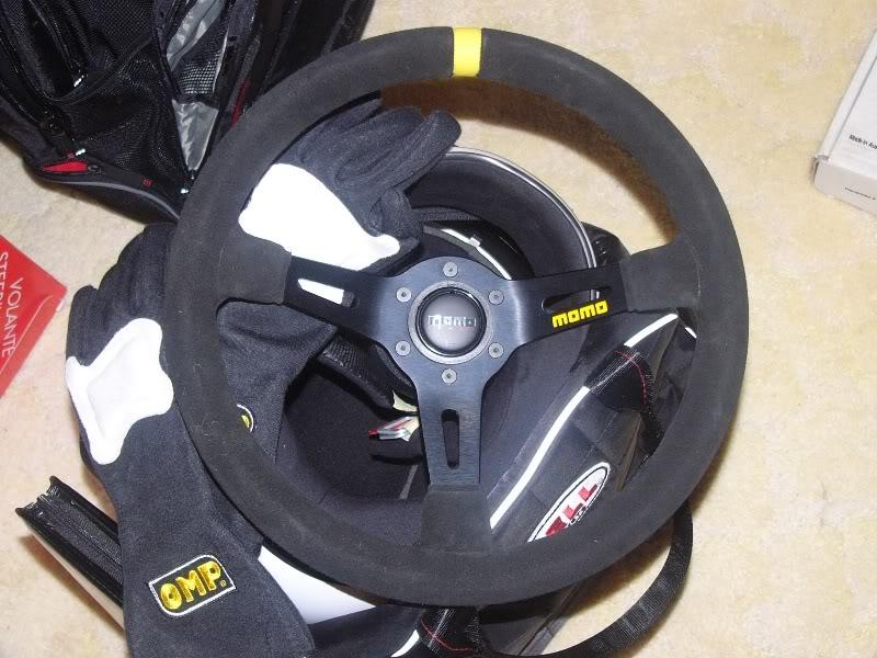

                            By sheer luck I managed to pick up a bargain steering wheel on the weekend too.
                            It's a suede 350mm MOMO Deep Dish Volatne wheel. Here it is mated up to a matching MOMO hub I scored months ago for $10 off e-bay.
