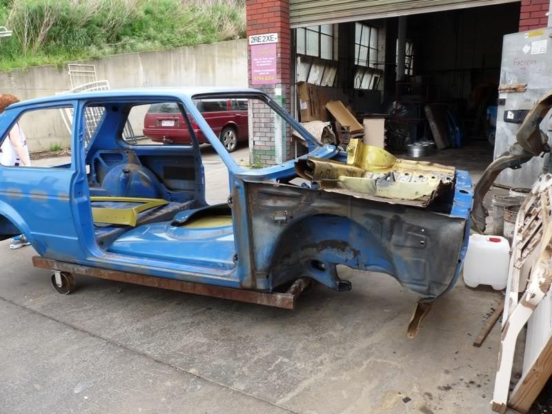

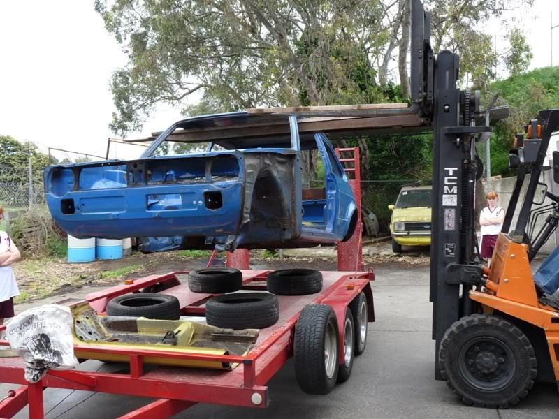

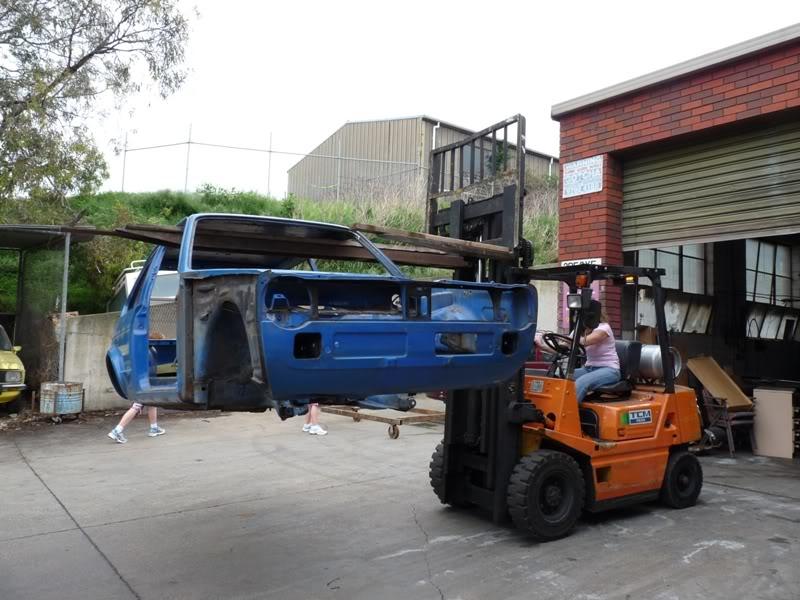

    • Dropped the shell and panels off for paint stripping today.
      It's getting tanked, the process will take about a week and it will remove all the paint, bog, seam sealer, glue and body deadener all in one go.
      The body goes in a caustic tank which then gets heated up and stays in there for about a week.
      The loose panels go in the same tank, but go into a de-rusting solution too as a second step.
      Off for a bath.
      Left the roof bows in until the last minute.
      Ever wondered where the centre of gravity is on a 2 door shell?
      Bath time!
      With cup day next week it'll probably be bout 2 weeks before I get the car back completely naked, in bare metal.
      The goal is to get the rust repairs done the minute it gets back and get all the seam welding done asap so I can work on the bare metal before I have to undercoat it.
      Once that's done it'll be off to the roll cage shop.
      There's pros and cons to chemical stripping vs media blasting. This isn't for everyone and not something you'd want to do to a street or show car.
      I should end up with the lightest possible starting point for a racing body shell.

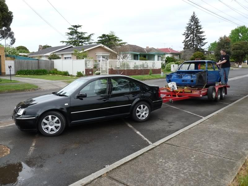

                  • Just got the news that the car will be ready for collection either Monday or Tuesday.
                    I've tee'd up some help to do the rust repairs to the floor and A pillar during the week and then it's off to Brown Davis on Friday for a rollcage.

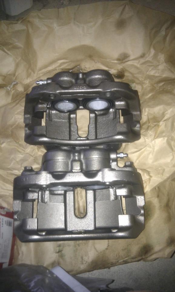

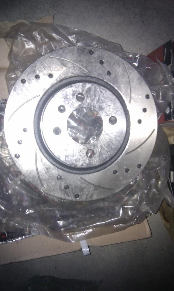

                    In other news, the brakes arrived today. With the dollar so strong the timing was good to bring these in.
                    These are Corrado G60 twin pot calipers and will bolt straight up to the 16v MK2 hubs I'm going to use. The calipers are enormous!

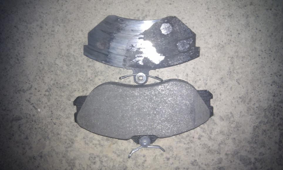

                    Here's a pad compared to the pads I run now (16v Scirocco.)
                    280mm Discs to suit.

                    • What wheels have you got planned to fit those brakes? Are they GAP discs?
                      • Wheels will have to be at least 15" to clear. I have a set of Corrado steel wheels that will work but there's a lot of other considerations before I settle on which wheels I'll finally use.
                        I didn't get these discs from GAP but GAP do sell this size. GermanAutoParts.com

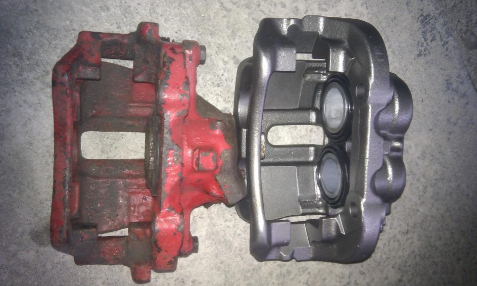

                        • Here's a side by side shot of a G60 calliper next to a MK2 16v calliper. (The MK2 calliper is the same as MK3)

                          • they're some big calipers! IF they dont stop her, I don't know what will!
                                Where did you get those calipers from Pete? very nice bit of kit
