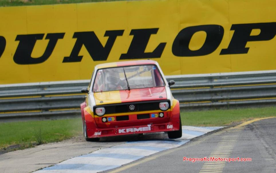

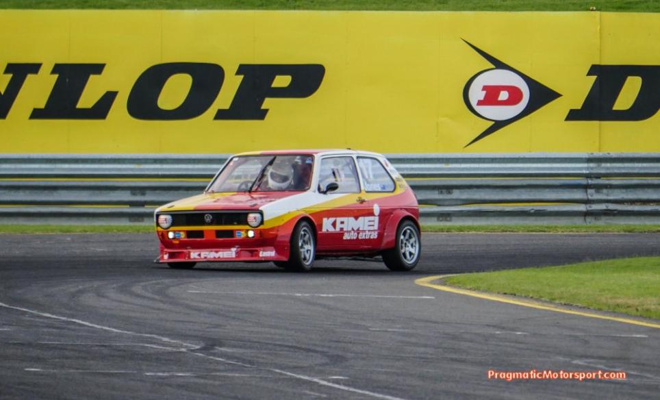

    • Great day today, crazy hot but getting back in the groove. Still trying to re-hydrate.
      Best time was a 1:31
      Here's some track side photos.

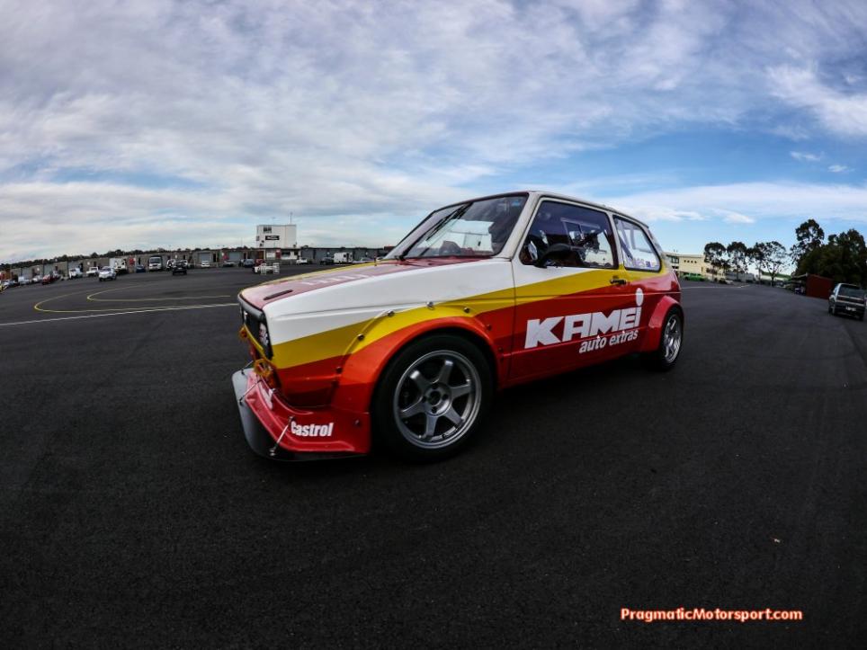

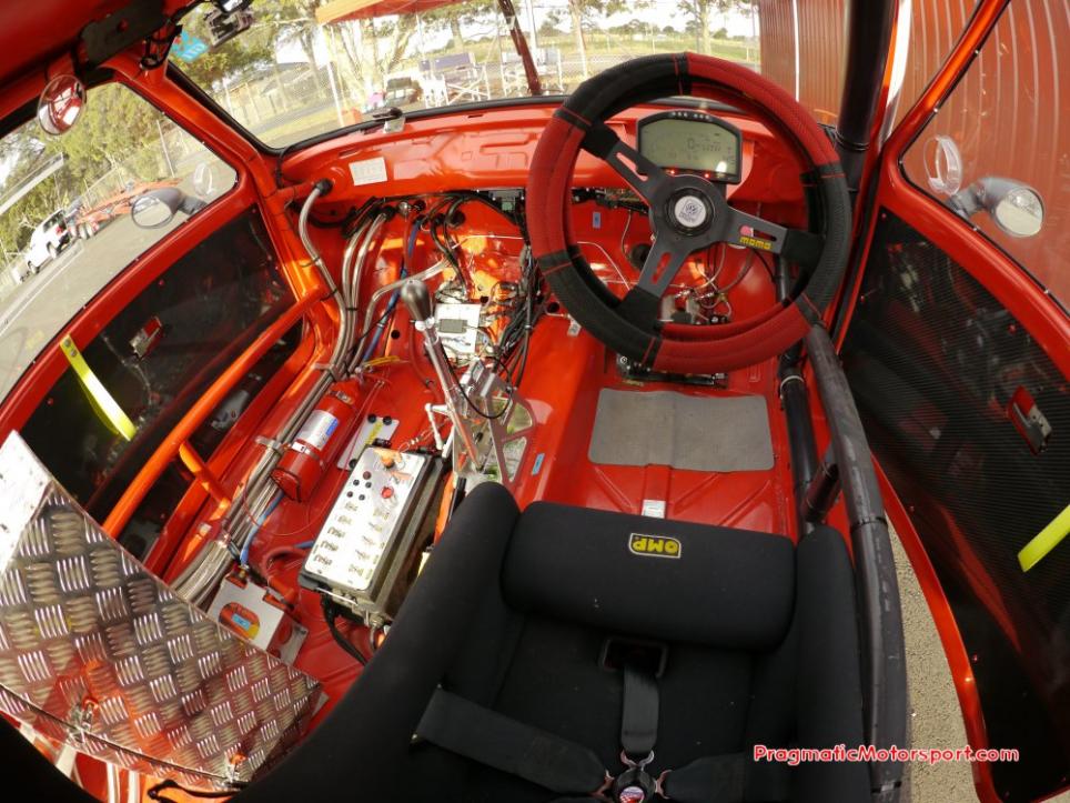

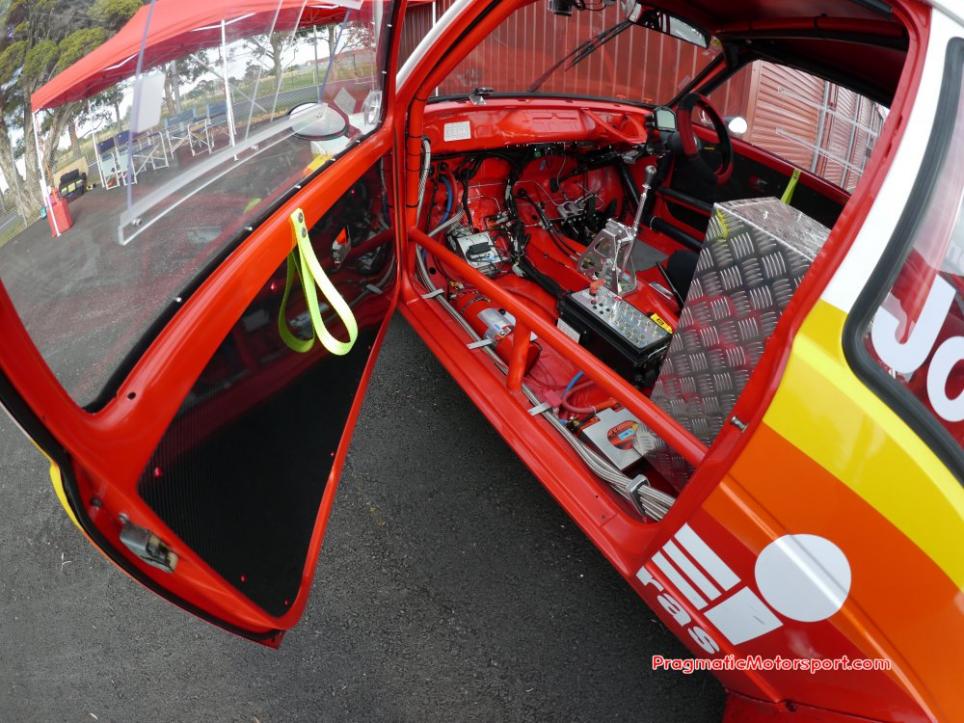

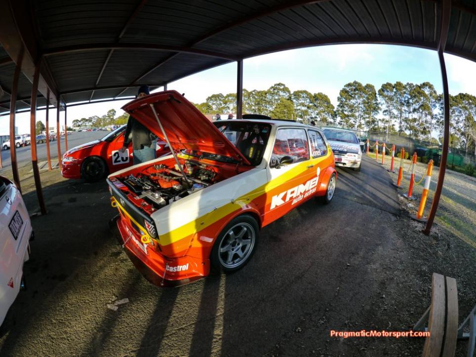

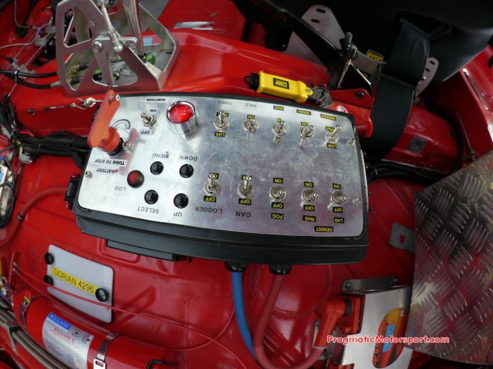

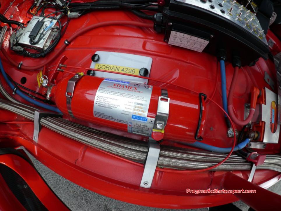

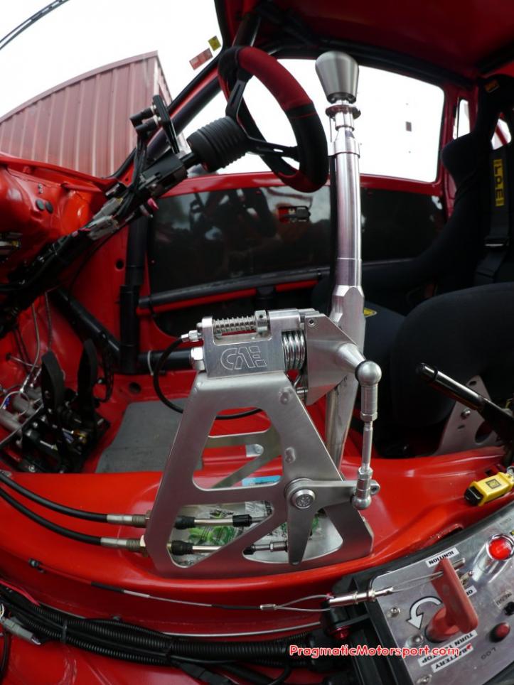

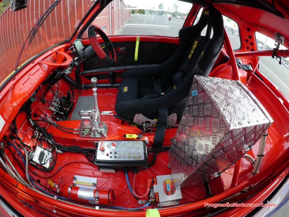

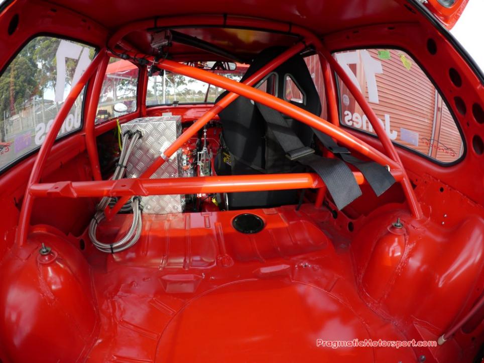

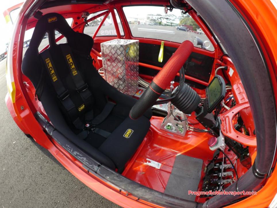

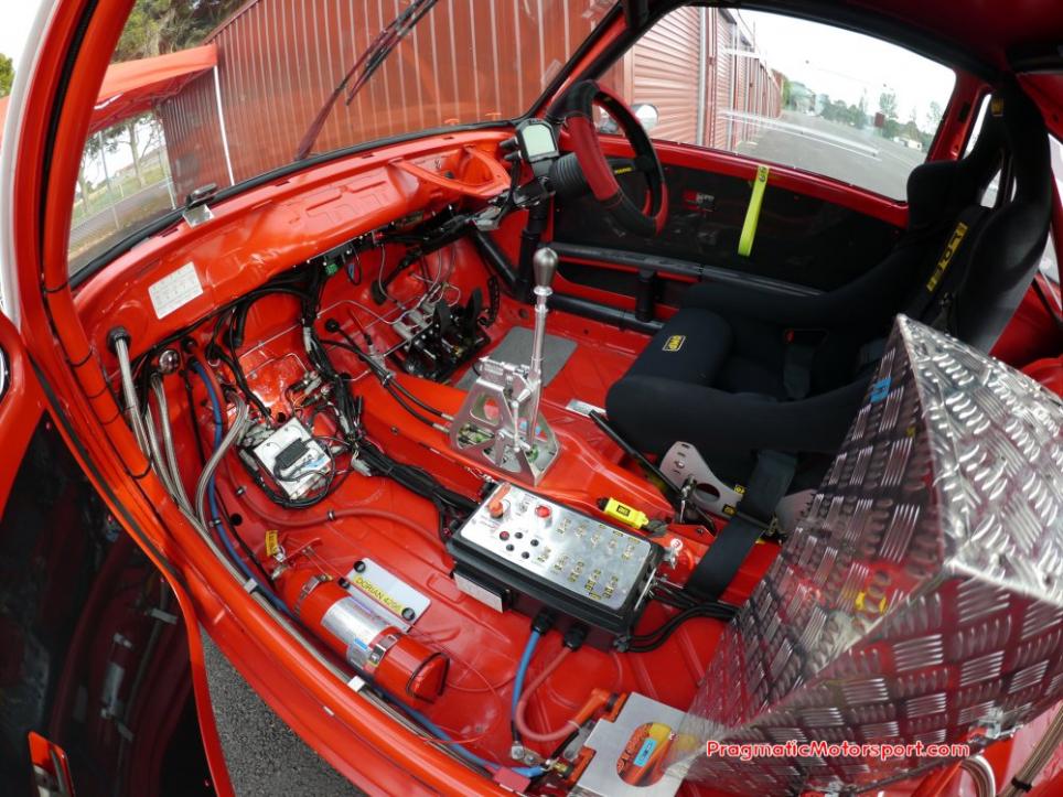

      • There's very few interior shots in the thread and I can never find one when I want one so Jodie packed the 8mm fish eye lens today to grab a few shots.

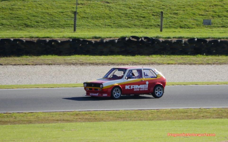

        • Round 2 of the VSSC Championships today.
          Car was going great haven't looked at the times yet.

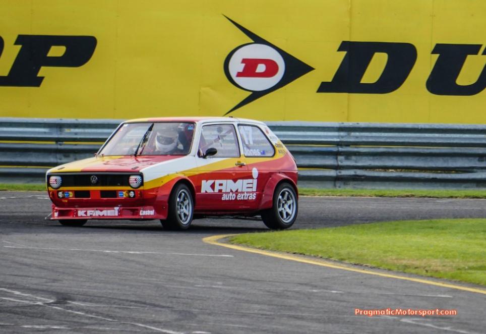

                            • Went out to Sandown today for round 3 of the Vic Super Sprint Championships.
                              I've just had the head off for reconditioning and only just got it back on in time for today.
                              Compression was down on no3 a bit, this turned out to be damage to the sealing face of the valves.
                              In all 5 exhaust and 2 inlet valves had to be changed. Most likely cause is foreign body ingestion.
                              Either track debris on the one occasion when I ran without an air cleaner, or the multiple spark plug electrodes I've burnt off.
                              Car is fast again now. Conditions weren't the greatest today, best I managed was 1:31

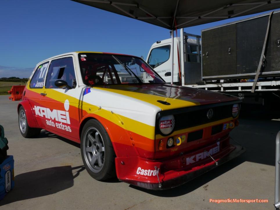

                              Pit crew at the ready
                              Scrutineering queue
                              Scrutineering
                              Warming up in the morning sun
                              The sun didn't last long

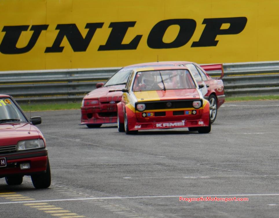

                              V8 Supercar chasing and not appearing able to pass.
                              (I don't think he was trying very hard.)

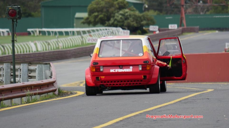

                              By 3:30 the day had gotten pretty dark and the track cooled rapidly. Combined with fierce winds I really couldn't push like I had earlier. The car was really unsettled into the high speed braking areas.
