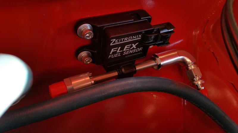

              • Starting to collect stuff for the eventual e85 conversion. Probably wont finish it off until the end of the season.
                Here's what I'm up to.

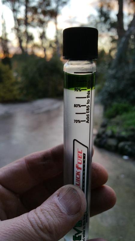

                This is an e85 tester. It tells you the % of ethanol in the fuel. It appears my local United is closer to being e90.
                I'm wiring a flex fuel sensor into the data logger. This measures the ethanol % and fuel temperature. This will let me log the fuel quality so I can review it should I suspect a fuel issue. I'll plumb it into the return line to the tank. That blue hose will be cut and terminated to run through it.

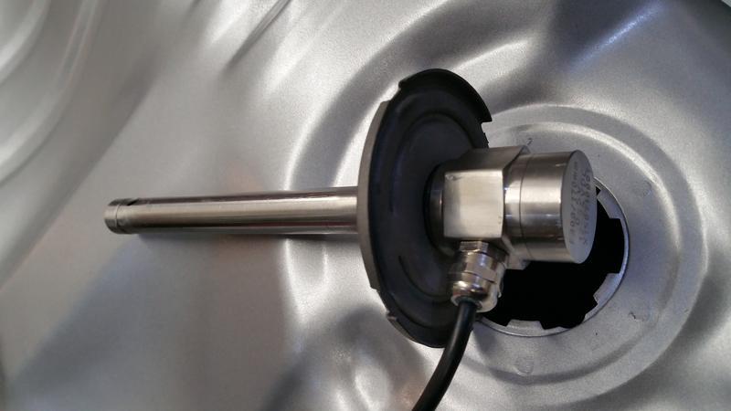

                This is an e85 proof fuel level sensor. It works on capacitance and has no moving parts. This will allow me to run foam in the tank. I had this custom made in China for about $150. A local sensor company quoted me $1600 for the same thing.
                I mounted it in the top of an old sensor which I'd gutted. The thread is M20x1.5 so I was able to modify a CV nut and braze it to the old top for the new sensor to screw into.
                This will be wired into the logger too, it's main function is simply a fuel gauge so I know if I need top up between rounds.
                You use up to 30% more fuel volume with e85 so I'll be keeping a close eye on consumption.

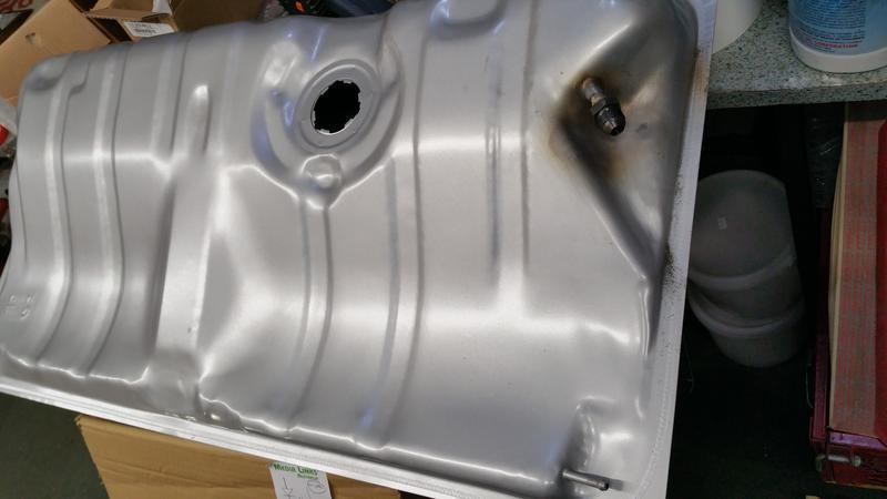

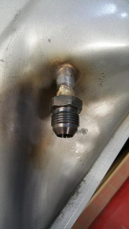

                This is a brand new tank from the UK. It has some differences to the OEM tanks that will make this thing possible.
                In order to make the tank proof against e85 I will line it with a POR-15 product designed to seal fuel tanks.
                POR-15 Fuel Tank Sealer
                There is no trap door on the filler and there's not the plastic surge tank/filter holder that the OEM tank has. Both of those would have made using the sealer very difficult.
                Because this is a brand new tank there's no safety issues with brazing AN fittings onto the pipes for more secure hose work.

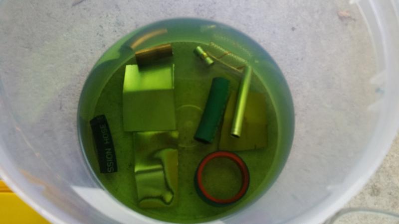

                I'm doing some very amateur science here and chucked a bunch of different metals and hoses in some e85 to see what happens. I've got one bucket where they're all submerged and another where they're partially submerged. Just curious to see if the horror stories are true.

                      • I have one of those simple eBay testers, and ave also found around 90% is normal I know people who use the flex fuel sensor, but I don't have the capacity with the Autronic
                        Apparently United is pretty consistent , Caltex is a lot more variable (E70 to E90)
                        My experience is 22% at WOT, less as an average
                        Your "bucket of Fuel" is exactly what I did!
                        • Good to know that United tends to be consistent.
                          From memory I think Caltex makes their ethanol from waste and United is from wheat/sugarcane?
                          22% is OK for the racing I do. I tend to use fuel as ballast if I've got traction issues and I'm still running a full sized 40L tank.

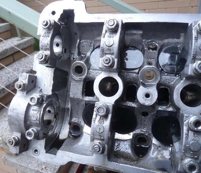

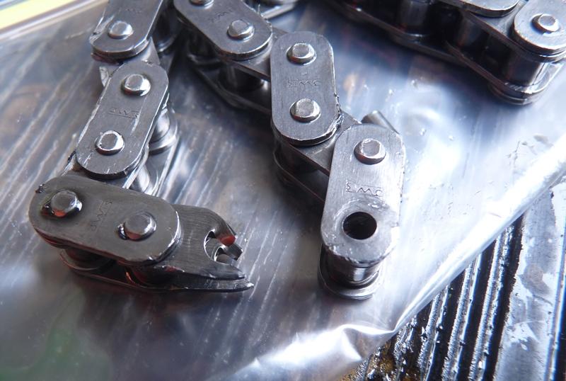

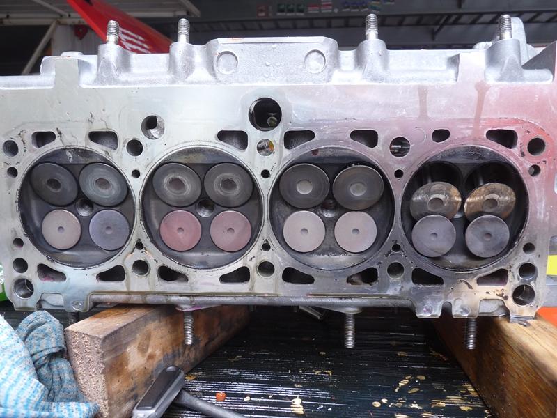

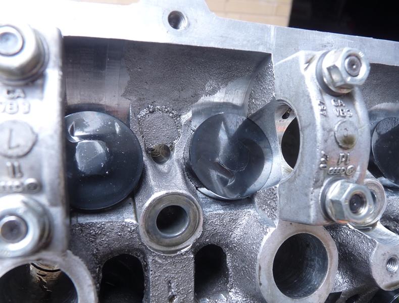

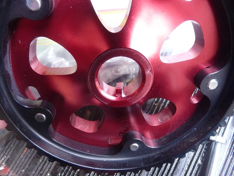

                            • Dramas yesterday out at Sandown.
                              Was going pretty well cutting 1:29 laps in the second round when I snapped the timing chain.
                              Bottom end should be OK. Head is off to see if it can be salvaged and what parts it's going to take.
                              Probably need to have all valves and buckets replaced as well as several of the guides as a bare minimum.
                              Should be enough time to get it fixed before the next round.
                              7? MK1 Caddy
                              79 B1 Passat Dasher Project
                              12 Amarok

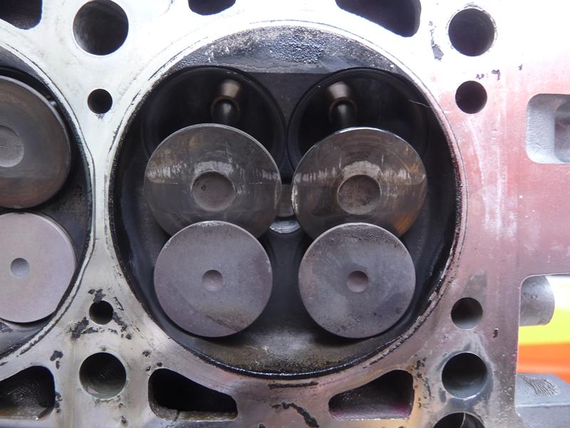

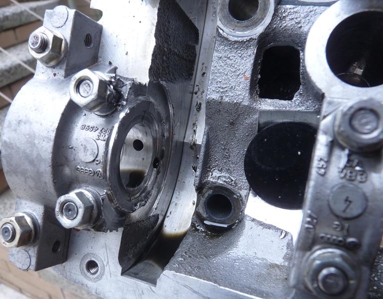

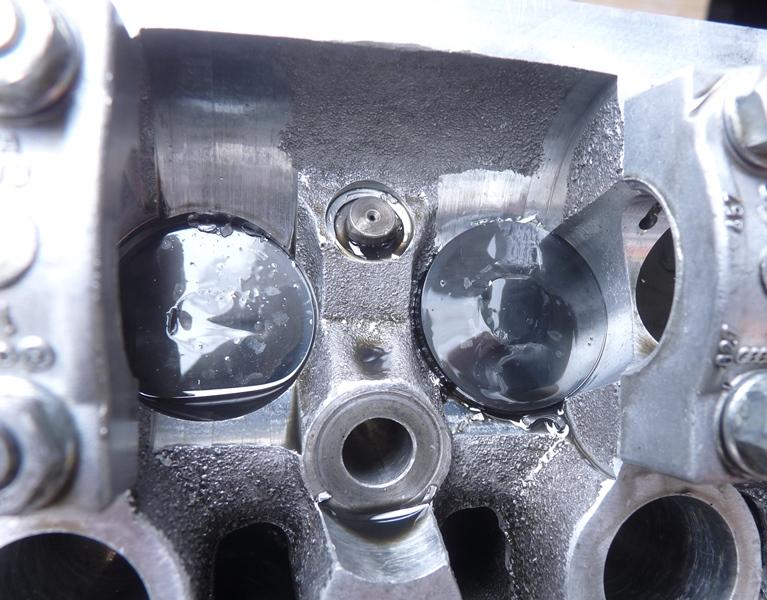

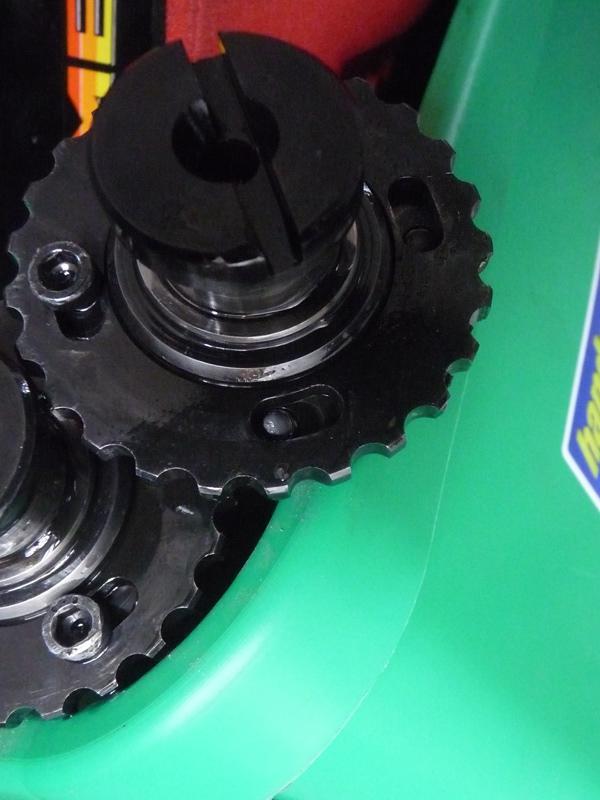

                              • The bolts on the adjustable cam gear sheared off and did a lot of damage around the bearing saddle nearest the dizzy.
                                Broken chain. Might have been the cam pulley bolts that let go first. Hard to tell which was the cause.
                                This was only the second outing on this pulley. It's stuffed now.
                                I don't think this is what's meant by valve overlap.
                                Inlet buckets got smashed up.
