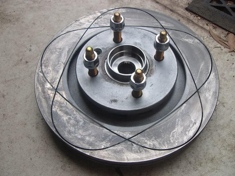

        Just setting up the rear discs to take ARP wheel studs, The fronts are a lot easier as the back of the hubs are already flat.
        ---------- Post added at 10:28 PM ---------- Previous post was at 10:05 PM ----------
        Also I'd like to point out that I do realise that's not the right way to hold an end mill, but it's all I've got and I'm not about to go and buy a bunch of collets and a MT adapter to make it work properly.

        • dear lord that an interesting way to spot face something. But hey, better than paying someone to do it!

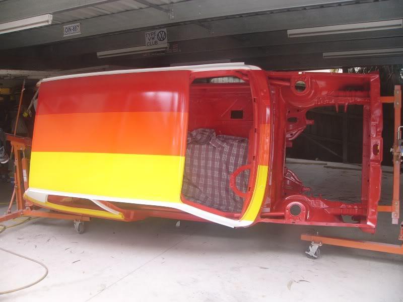

          • Got the final coat of clear on today.
            Now I can start putting it back together!

                • Now thats the way to paint a roof.
                  Great work pete looking really awesome.

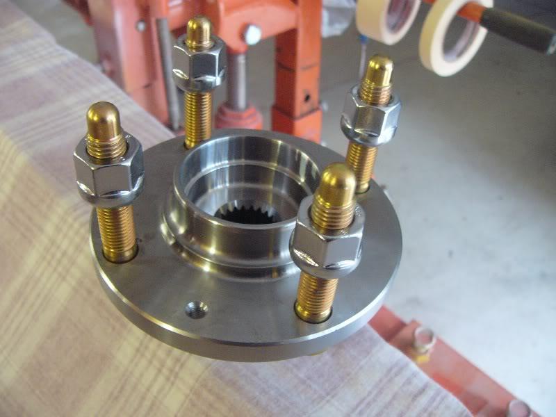

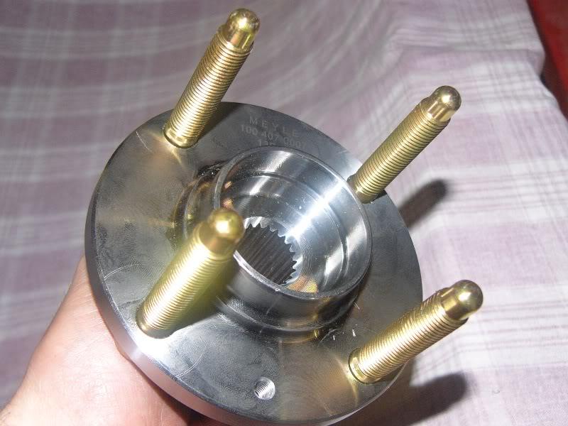

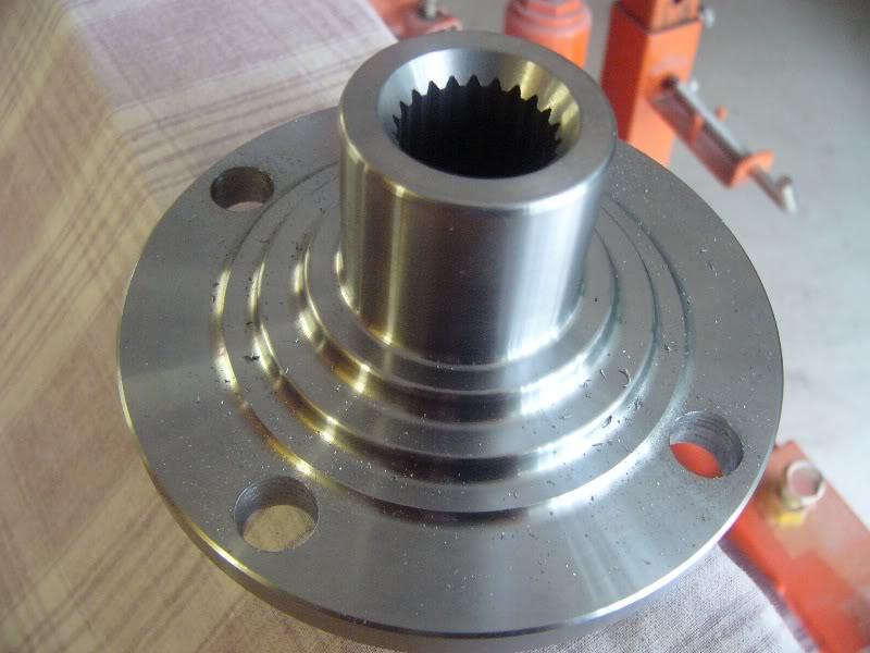

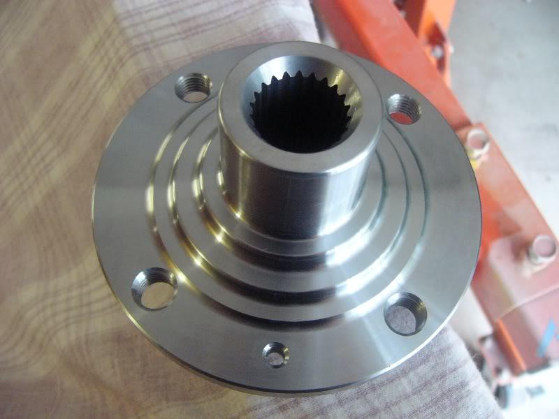

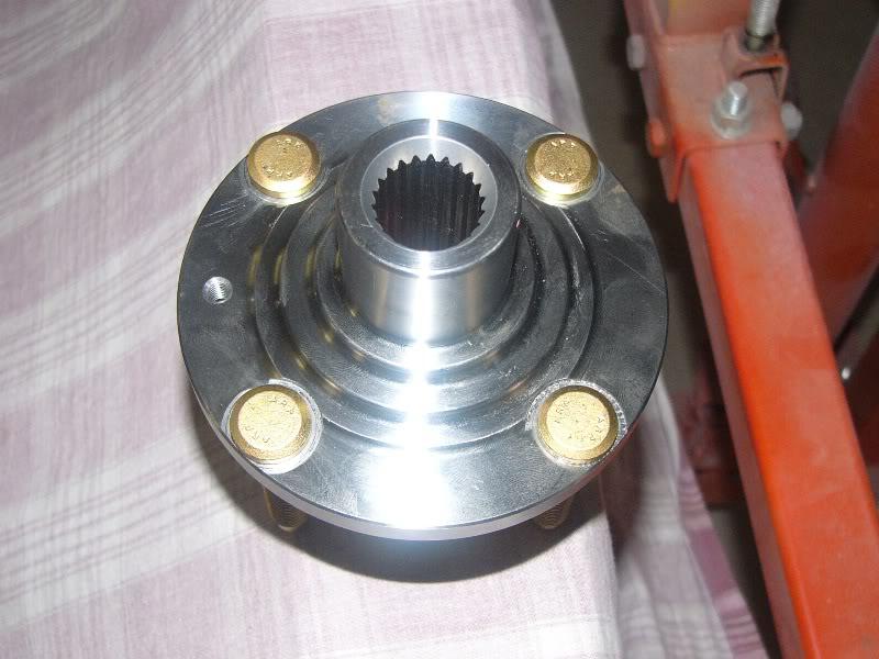

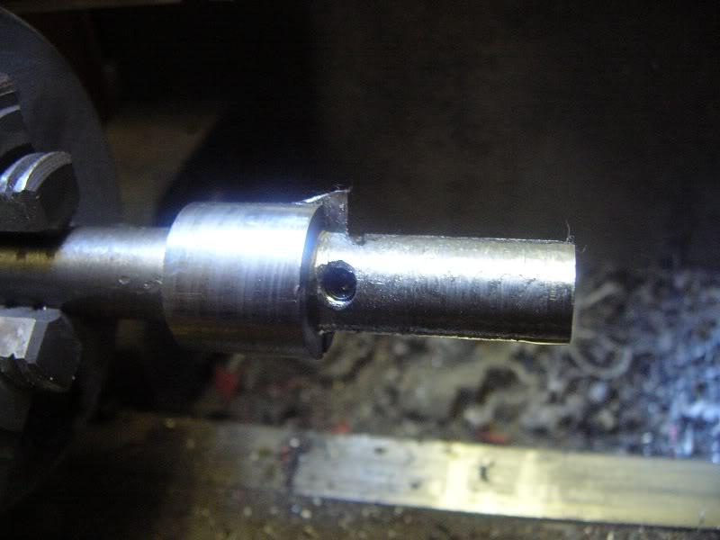

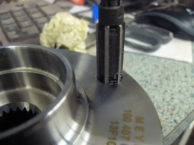

                            • More madcap machining adventures.
                              Been working through some front drive flanges today.
                              I chose ARP studs part number 100-7719 they're listed for Mazda race applications.
                              Wheel Stud Style Press-in
                              Wheel Stud Thread Size 12mm x 1.50 RH
                              Knurl Diameter (in.) 0.507 in.
                              Underhead Length (in) 2.750 in.
                              Knurl Length (in) 0.335 in.
                              Quick-Start Nose No
                              Quantity Sold as a set of 4.
                              Notes Designed to fit Mazda front or rear 1990-93 applications
                              and front only on 1994-2005 applications.

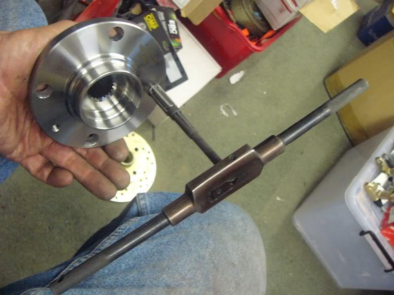

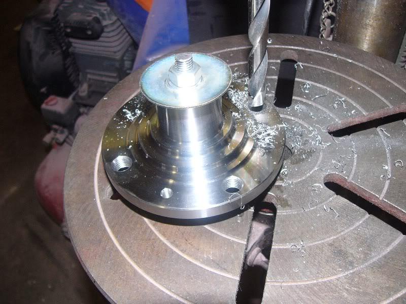

                              The knurl diameter is pretty small and doesn't need a lot of metal taken out. I drilled the threads out to 12.5mm and them reamed the holes to 12.75mm. (After checking with ARP
                              Pressing them in is a nice tight fit.

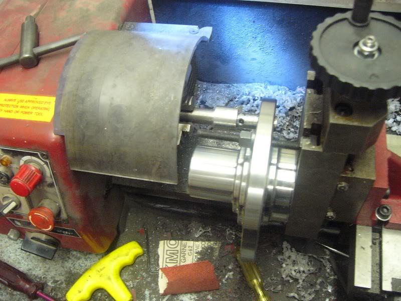

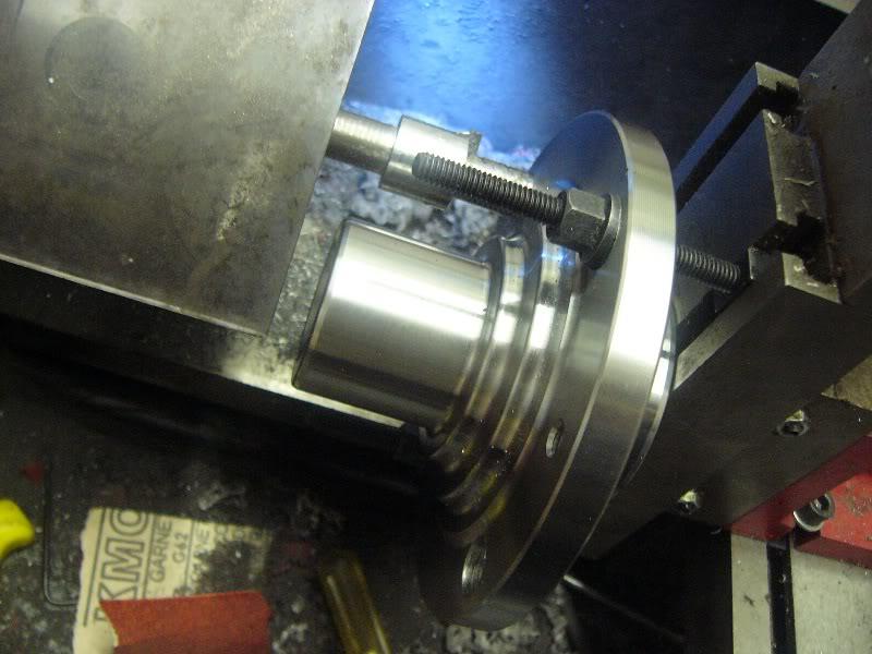

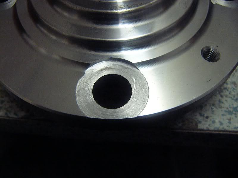

                              I made this tool to spot face the back of the flange, it's a bit rough but seems to work OK.
                              I'm still figuring out all this machining stuff.

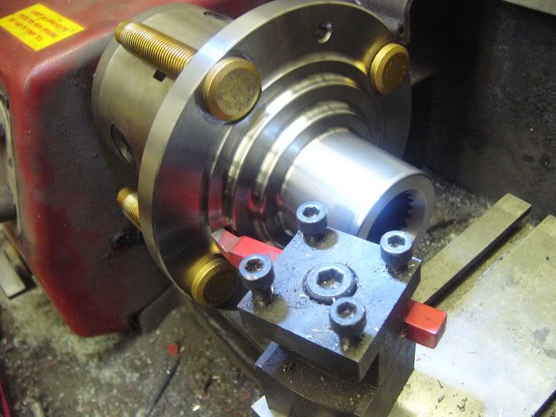

                              Here I'm just trimming a little off the inner edge of the stud heads so they don't foul on the hub.
