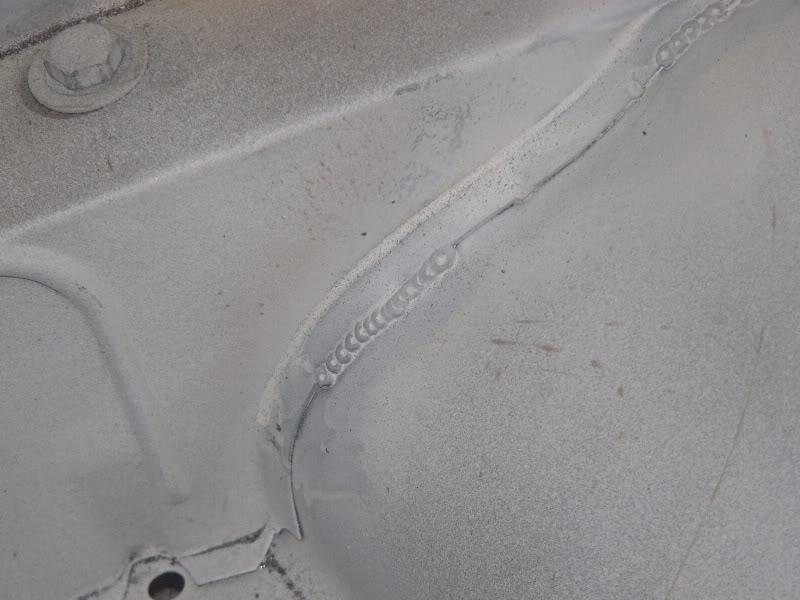

    • Still welding away. Nearly got around all the seams now.
      Starting to get into some of the mods.

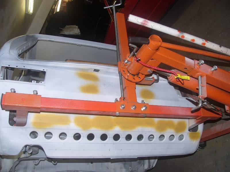

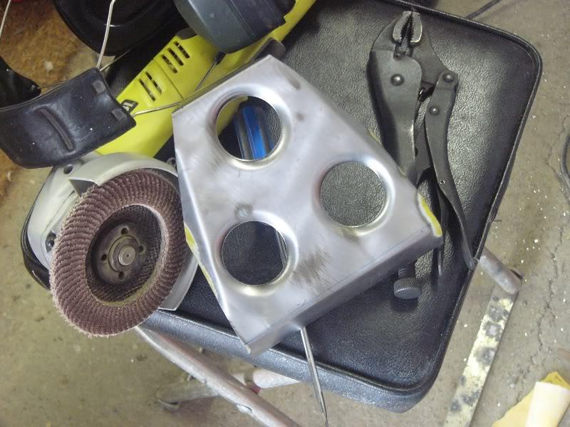

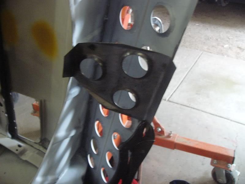

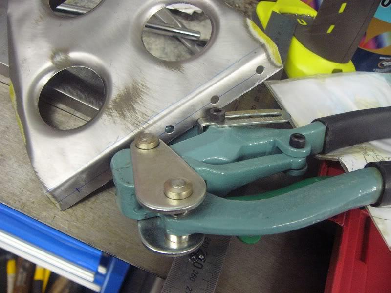

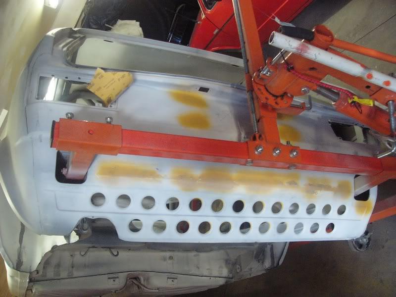

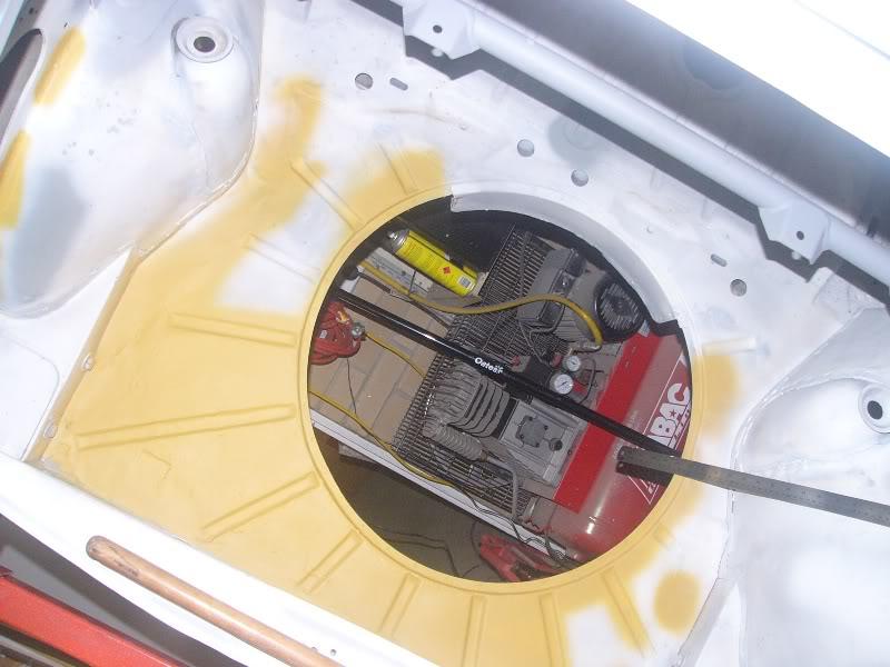

              • Did some more work on the rear apron today.
                With the spare wheel well gone I needed to make a new brace for the rear apron as well as finishing off the second row of speed holes.

                • coming along nicely Pete, holes are looking the biz for sure !!

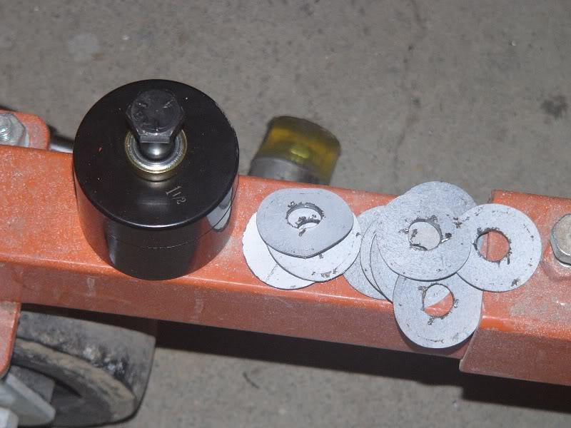

                  • looking very nice and professional there Peter, what are you using to pull those holes through

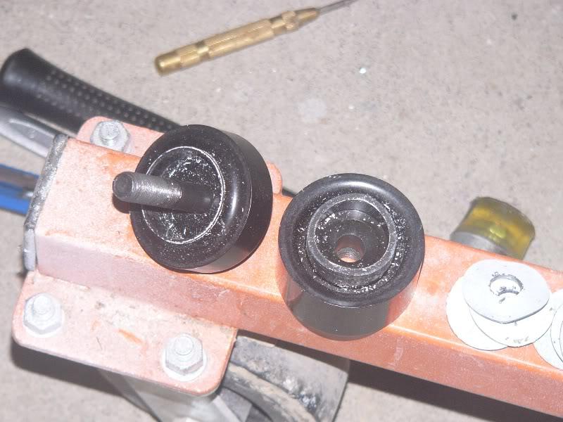

                    • Originally posted by Volksee77 View Post
                      One of these
                            As Grant pointed out the gadget is pictured earlier in the thread.
                            The device is a combined punch and flare. It's quite vestatile and can be used to punch a hole, flare an existing hole or punch and flare simultaneously.
                            They come in a range of sizes from 1 1/2" through to 2 5/8". These holes are 1 1/2" but the diameter of the flared section is about 2".
                            Here's a link to the manufacturers site. You can buy them off e-bay or places like Summit racing.
                            Allstar Performance - racing and high performance car parts, accessories and specialty tools.
                            Summit Racing
                            As well as removing weight, flaring the edges of the hole stiffens the panel, making it quite rigid.
                            My reasoning behind perforating the rear apron was to reduce drag, With the wheel well gone it's just hanging in the breeze.
                            I could have removed the apron entirely but I wanted to keep the shape of the car.
