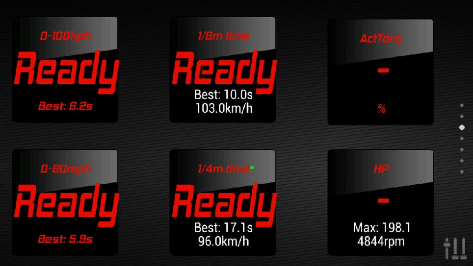

now that I have an obd2 tool, I decided to find out what my actual 0-100 time was.
run 1 = 6.78 secs
run 2 = 6.2 secs
run 1 was in 'D' mode.
run 2 was in 'S' mode with launch control.
hp figure is "atw". I wonder how accurate that is.
will b interesting to see what difference, if any, the dsg software upgrade (soon to b done - hp performance currently have my dsg file) will yield.

The max HP reading at 4,800rom will be wrong, as you car should still be making horsepower up until about 5800-6000rpm before dropping off. The actual max HP number of 198hp seems a little low, i would think more like 215-220hp considering your mods, but who knows.
And if you are doing 0-100kph in 6.2, then you should be doing something like 14.5-15.0 second 1/4 mile times, not 17 seconds.
The bit I noticed is that there's 0.3s difference between 0-60mph & 0-100kph. 100k is 62.1mph. 0.3 seems a long time to gain 2.1mph relative to the overall acceleration. Or am I just effed in the head?carandimage The place where Off-Topic is On-Topic
The car requires a change into 3rd gear at about 95kph, so the time difference is likely the change into 3rd to hit 100kph.
i didn't cover a 1/4 mile doing those runs. i backed off as soon as i hit 110-ish km/h.Originally posted by Lucas_R View PostThe max HP reading at 4,800rom will be wrong, as you car should still be making horsepower up until about 5800-6000rpm before dropping off. The actual max HP number of 198hp seems a little low, i would think more like 215-220hp considering your mods, but who knows.
neither did i take note of the gear changes. next time i'll take note.
regarding the hp reading at 4.8k rpm surpirsed me too. it was still pulling hard heading into the 6k rpms.
according to torque-pro, the best way to accurate hp & torque, is to "start from a slow rolling start (about 8 kmph to 15 kmph) and accelerate until about 88 kmph. This will give you the most accurate peak value for your vehicle."
maybe a few more runs to get a more accurate measure.
i wonder if its possible to download & analyse the logs of the torque pro tool.Last edited by dArK5HaD0w; 24-01-2014, 03:36 PM.MY17 Superb 162TSI, Business Grey, Tech+Comfort Pack, APR ECU+TCU Stg 1, SLA, Rieger Splitter + Side Skirts, Eibach Pro-Kit Springs, Hardrace Swaybar, TPMS
