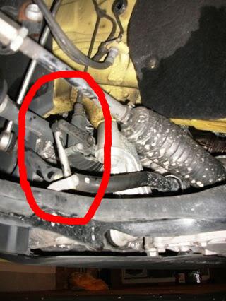

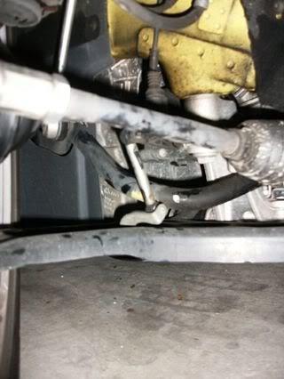

            here is a pic of the front self-levelling sensor. its on the passenger side. u can see it with the wheels turned to the right on full lock.
            notice how the arm is on an angle. thanks to the 30mm lower ride height up front, the sensor arm is compressed/bent more than its usual postion.
            the rear sensor arm is not compressed as much because it was a 20mm drop.
            but because there was already a 10mm difference between front & back before lowering, the end result is a 20mm difference between the two now. making the sensors think the front of the car is constantly on a "20mm" high speed hump.
            if the dealers can't realign the headlight the conventional way, the only other option would be to pop the arm off, and shorten it.

              thanks heaps mate, I'll add that to my list of tuner/mechanic questions when I'm there next

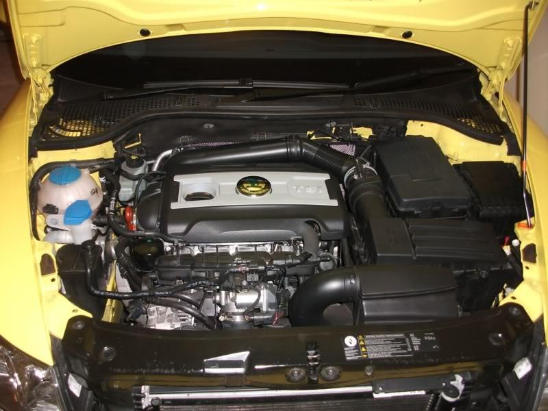

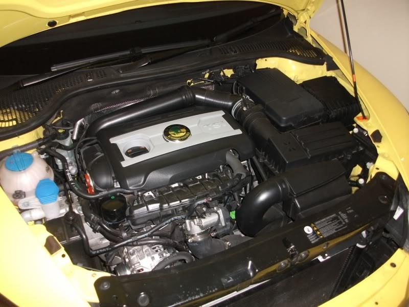

                  wasn't happy with the look of the skoda badge on my engine cover. so bought myself an 80mm badge off ebay and stuck it on.....

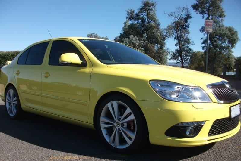

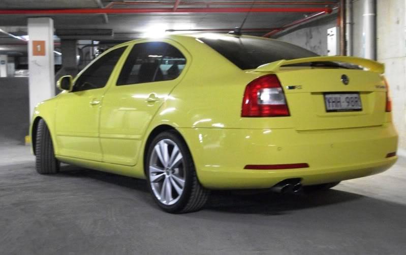

                            thought i'd take some pics....as this is it. this is how the outside will look here on......no more changes

                              very nice!
