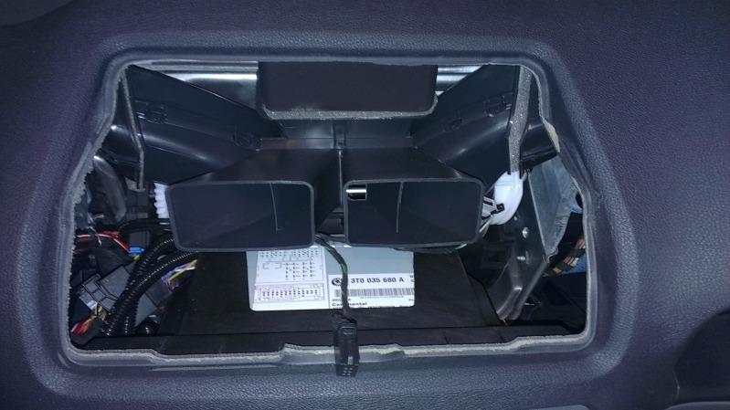

                      Also, any tips on how to remove the storage compartment on the dash?
                      Originally posted by dArK5HaD0w View Post
                      thanks to the Briskoda forum, i removed the top storage compartment
                          just the tune. no intake. was tempted, but pass....for now.
                          said nothing to worry about with regards to warranty......as long as i don't do repeated takeoffs using launch control, and drive it like i wanna kill it.
                          as for the storage compartment.....u'll notice two indents at the front in the image.....using a plastic spatula (in my case), push in & lift/pry in those approximate areas. this will allow u to lift the storage compartment from the front. the back just pivots off.
                          very easy compared to removing any other trim panels.
                          the only tricky bit is the hazard lights button. the wire is very short (front of image). u'll need to unclip it if u want to remove the storage compartment.
                            Thanks.

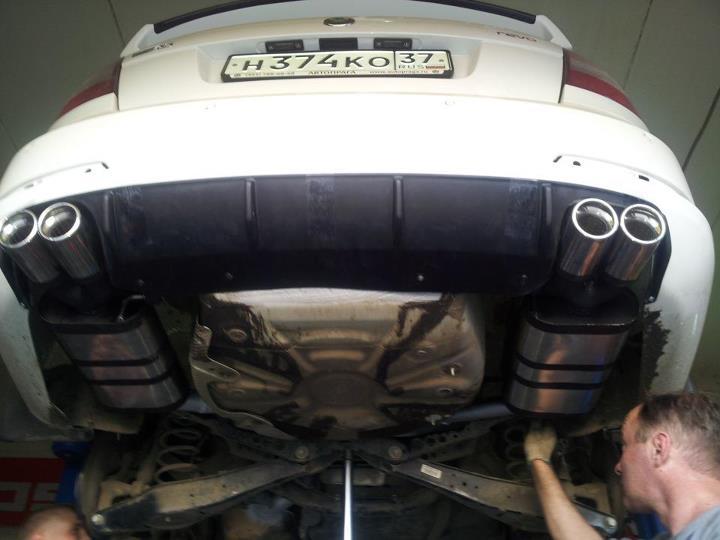

                              i want a pair of these.........
                              looks like "custom-made" is the only option.
                              MY17 Superb 162TSI, Business Grey, Tech+Comfort Pack, APR ECU+TCU Stg 1, SLA, Rieger Splitter + Side Skirts, Eibach Pro-Kit Springs, Hardrace Swaybar, TPMS
                              • #75
                                I'll have a talk to the guy at Liverpool Exhaust if you like?
                                Thats where Lex (Speedfighter) got work done on his vRS, and a custom job (tips and all) done on his girlfriends MX-5. I'm going to head there as soon as I have some tips and a spare $450.
