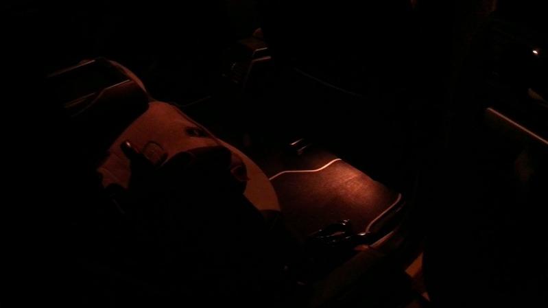

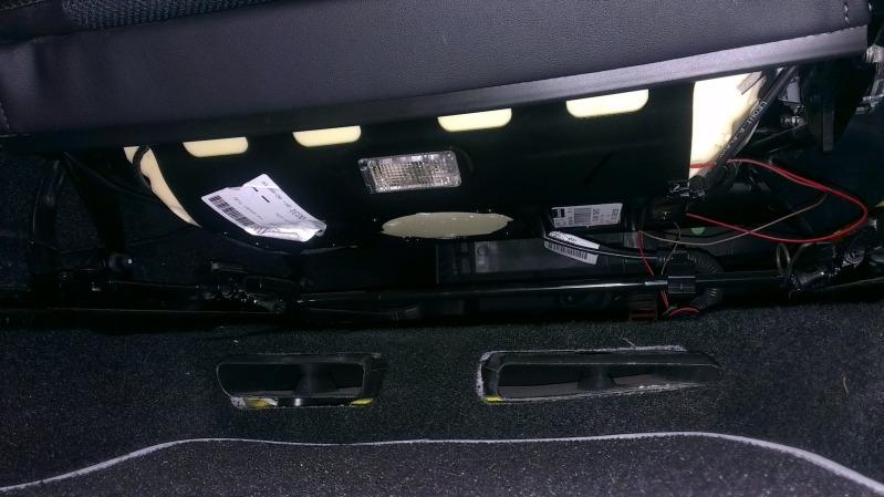

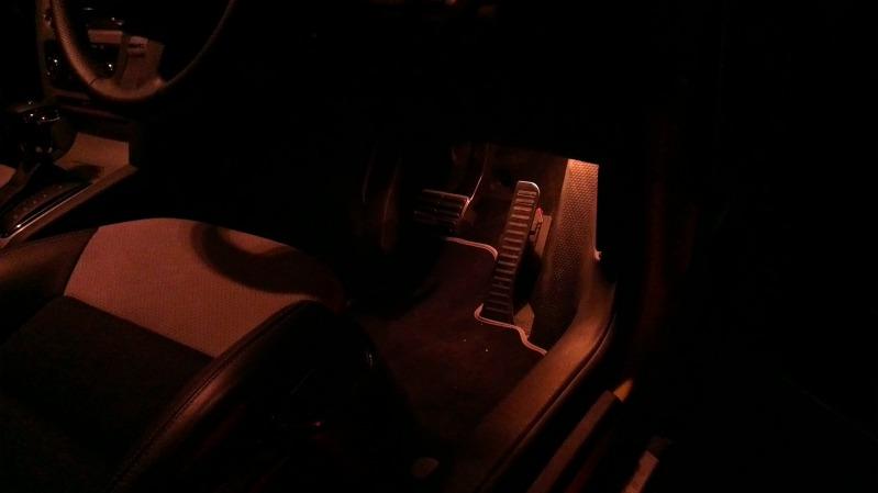

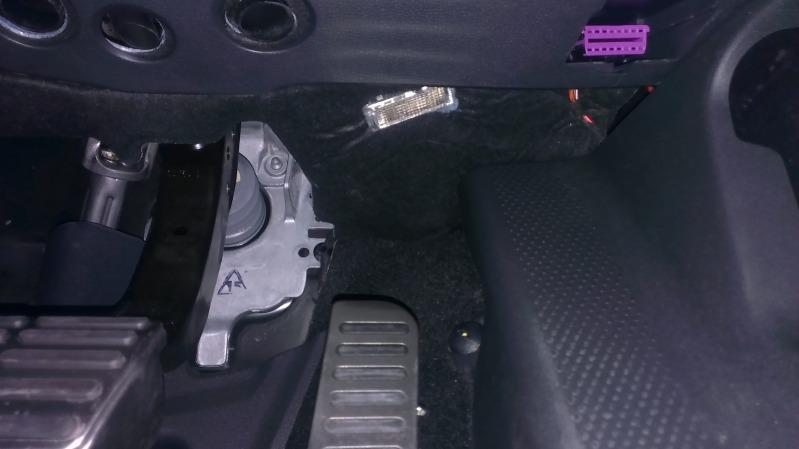

        unfortunately i've been sick all last week & through the weekend, so i didn't get a chance to have a good crack at it.
        what i did manage to do was install & wire up the footwells on the drivers side - front driver & rear driver side.
        i haven't hooked up the wiring on the passenger side. i do have the footwell lights in the spot, just not wired up.

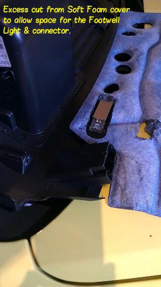

        i'm not happy with the way the drivers footwell lighting is sitting. because i cutout the soft foam, its actually bending, causing the footwell light to sit on an angle.
        next time i open it up, i'll c if i can cutout the hard plastic & re-fit it there.

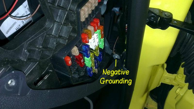

        after removing the bonnet lever, i was able to pry open, not remove, the door sill plastic. this enabled me to run the wire down behind the bonnet lever, under the door sill carpet, to the opening flap under the drivers seat. from there i routed the wire under the seat to the footwell location.
        installing the power source to pin #50 was much easier than i thought. literally, unplug the white CECM connector & plug the power wire in. it clicks in place nicely. cable tie it with the rest of the wires, and plug the CECM connector back in. the negative wire i grounded to a metal screw holding the dashboard frame.

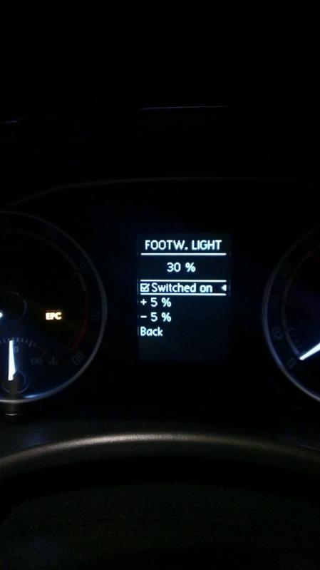

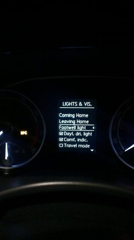

        i got the vcds cable tonight, and did the coding as per the instructions.
        central electronics -> long coding -> Byte-12: Tick Bite-5
        central electronics -> long coding -> Byte-20: Tick Bite-0
        saved the settings and bingo.....let there b light!!
        woOot.

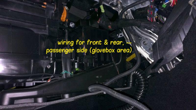

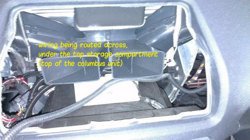

                alright.....things r looking positive now.
                thanks to the Briskoda forum, i removed the top storage compartment, and was able to see a clear path to route the wire across from the drivers side to the passenger side.
                i didn't attempt to do any wiring - was just having a looksie.
                so its all systems r go for the weekend.
                i just hope the wiring is long enough.

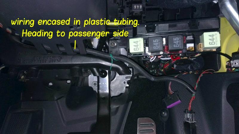

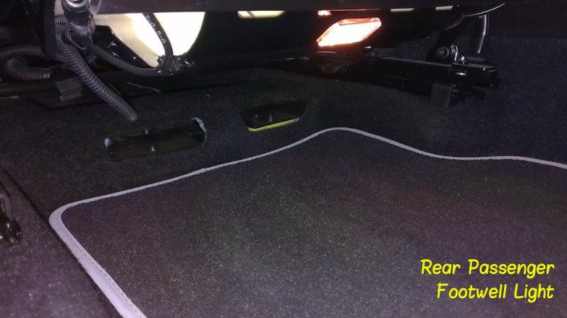

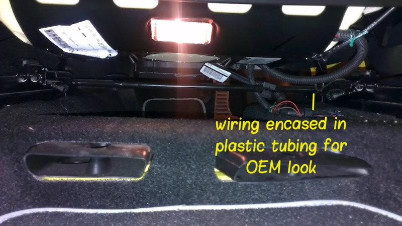

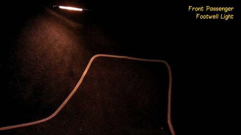

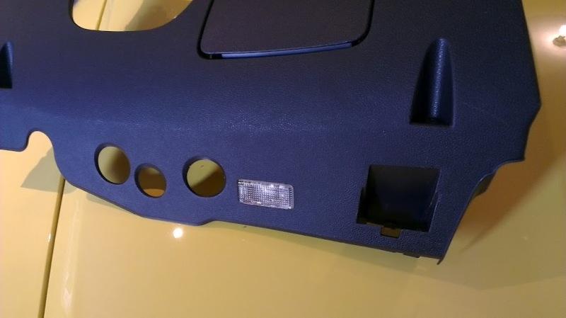

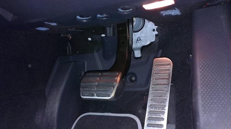

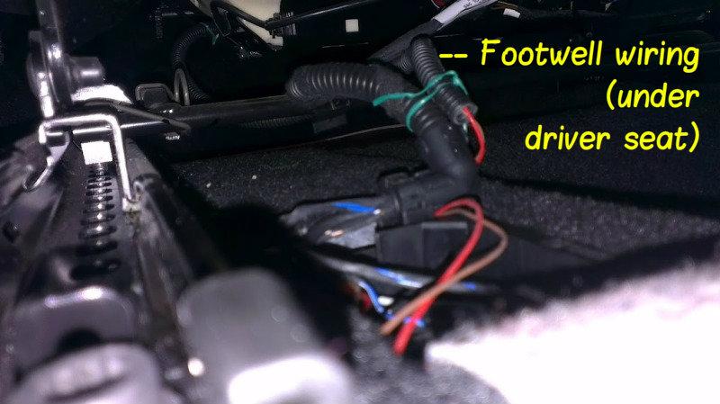

                  so i've finally finished wiring it all up - front & rears.
                  thanks to all ur help - definitely made my task easier.
                  for those buying the footwell lighting kit from boldsport, the wiring (routed via the door sill covers) is not of enough length from the front to the rear footwell. i had to cut & extend the wiring by another 30-40cms, to fit comfortable.
                  i got myself some plastic tubing and covered up the wires so it looks OEM.

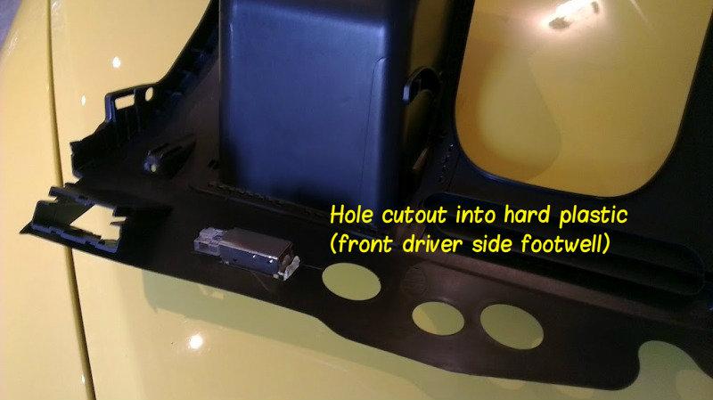

                  i also cut a hole into the hard plastic for the front driver's side footwell. now it sits flat & feels sturdy.
                  u can see the original hole i had cutout for the footwell lighting. the soft foam was bending in an unfavorable angle. so i cut into the hard plastic.

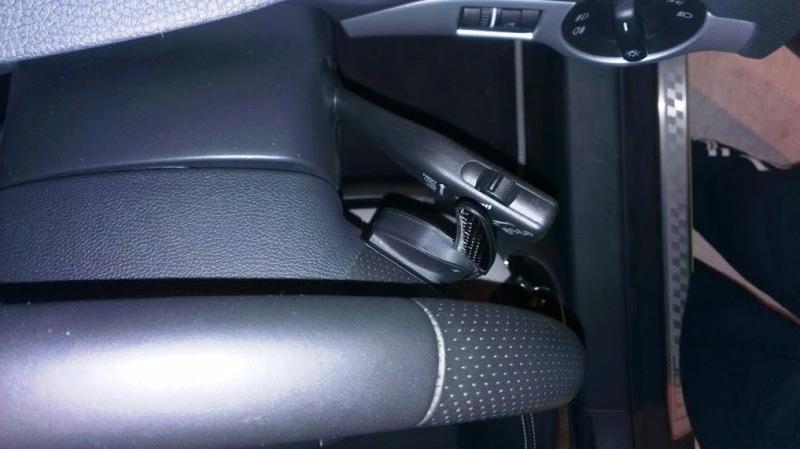

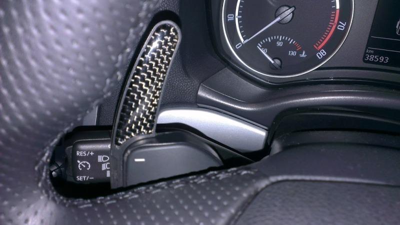

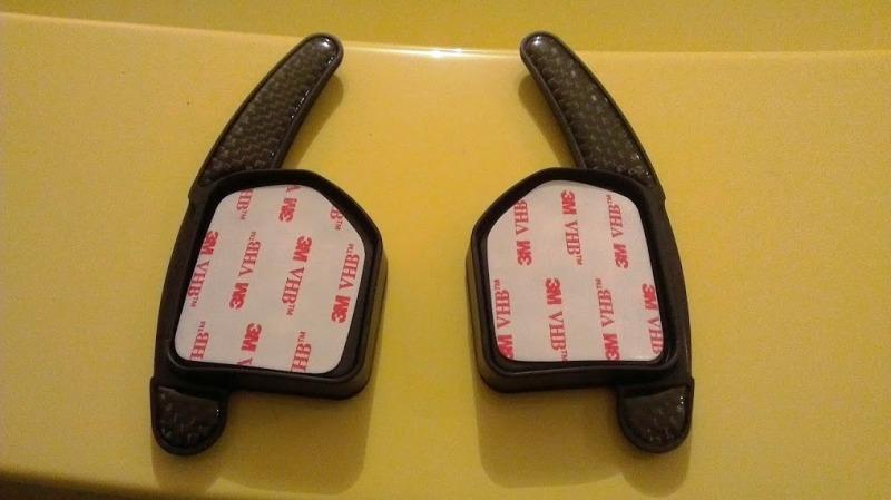

                        my latest addition - paddle shift extensions.
                        i couldn't justify spending $300 on st2p paddles (audi), or just as much on TID ones.
                        so i finally found these paddle shifter extensions for audi, at price i can justify - $45 delivered.
                        haven't driven with it yet, as i just put it on. gotta leave it on overnight to ensure proper contact.
                        happy with the fit and finish. hope it lasts.........

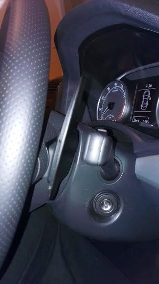

                                So I went for a drive to get a feel of the paddle extensions - in summary I'm glad I only paid $45 for them!
                                Basically pressing the tips don't trigger the shift. There is flex, however not from the extensions, but from the original shifter itself. There is little give/flex on the shifter itself, and so putting the extensions only amplify the flex at the tips.
                                They respond up to half way up the extensions. Tips r useless.
                                At least it looks good
                                Guess the best solution would b to go with a proper replacement like the st2p paddles.
