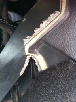

          • Had to remove the aftermarket Bluetooth unit as there is a problem with A2DP streaming.
            In the process of doing so I had to remove the glovebox. To my disappointment I found the source of my cabin squeak. When the dealer (who is now out of business it seems) had it installed, they managed to break off a mounting point for one of the screws
            Problem is this is part of the whole dash assembly so would be a major job to replace.
            I went to Rockdale Skoda to pickup the map DVD that the dealer didn't give me (v4.1 but at least it's original) an spoke to the service adviser about it. He is going to look into it for me.
            To be honest I don't want to have the dash replaced I would be happy with a metal bracket being fashioned and bolted onto the plastic where it can be safely attached.
            Will see what Skoda have to say about it...

                Realise its very difficult to tell just from one photo, but would you think a small metal 90degree angle bracket could be bolted safely to the intact plastic in order to re-mount the glovebox?
                • Originally posted by kamold View Post
                  Yes, that's how I would attempt a fix if the owner was in agreement and if there was enough material to attach to.
                  I doubt I'd use bolts - If I was doing it at home I'd fabricate a bracket & use rivets with washers under the head (stop it pulling through the plastic 2-4 each leg. I'd definately use some glue - liquid nails or similar. Something that won't dry out & crack.
                  But I'm a dodgy mechanic and went from cars to aircraft & had my eyes opened as to what craftsmanship is - the best person to ask would be an aircraft structures / sheetmetal person. Those guys would have some brilliant idea that craps all over mine.
                  • Definately some good ideas there, thanks.
                    I told the service guy I would be happy with a repair of that nature rather then a dash replacement (which is likely to just introduce more squeaks) so I'll see what he says.
                    If I have to just cop it sweet then there may be a case or two headed your way brad if you're interested
                    • IMO if there is something broken under warranty, it should be replaced, or repaired to an as-new condition - which would probably mean replacement
                      dashboard replacements arent THAT big a deal, mostly they are a skin over a metal brace anyway. and yes the manual helps
                      • Originally posted by zei20t View Post
                        I see your point but my perspective is that if the mechanic is not as dilligent as someone such as Brad, the potential to end up with more problems than before a dash replacement is real. As I can see exactly what the issue is and a potential way to fix it permanently I would prefer that option...
                        • fair enough, and its your car
                          • +1 for repair. I've had to have dash out repairs on my Octavia and yes, it introduced rattles that are there to this day and probably always will be
