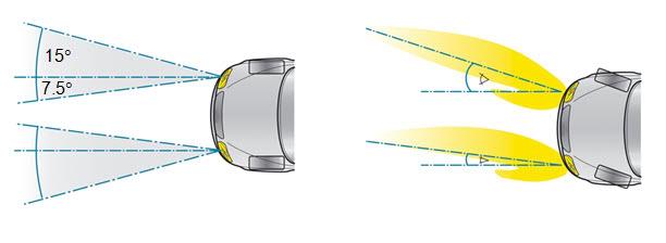

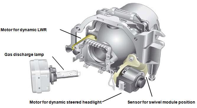

The stock Xenons are the AFS type. (Motors inside the unit that make it turn side to side, as well as up and down.)Originally posted by zei20t View Posti agree the standard halogens ARE awesome. compared to a 1981 corolla.

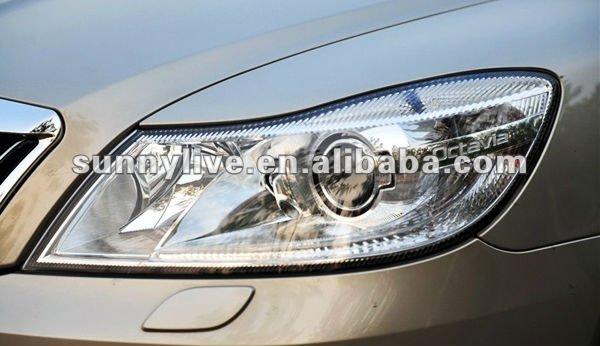

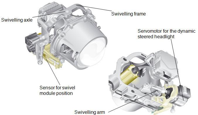

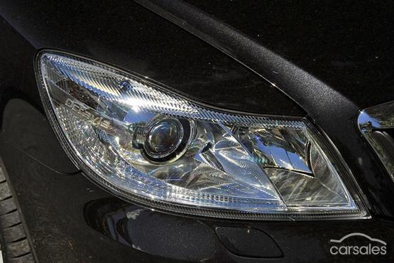

there's a big difference behind the scenes, between an afs xenon headlight & halogen projector headlight.Originally posted by zei20t View Postquoted for truth
also, didnt realise the motors were on the headlight unit. i wish i could see one too!
here's some mechanics about the afs xenons - its motors & sensors.
u can also tell by physically looking at the headlight cluster - with the xenon afs ones, there is bigger visible gap between actual projector & housing. this enables it to "swivel". there is also a indent/cut where it says "octavia"
a halogen projector headlight cluster won't have this indent/cut.
xenon afs
non-xenon
