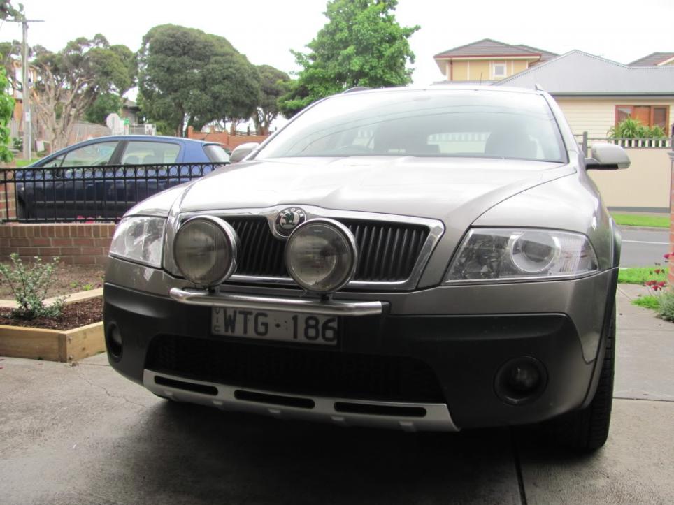

      Yes. I'd like to see photo's. I saw some light bars in Supercheap yesterday (and they weren't so super cheap). What sort of light power do they have? Can anyone equate it to normal driving lights? Is the colour of the light white or a bit yellow like normal lights. The beam spread?
      Oops! Cocked that one up.
      When I started talking light bars, I took them to be the bars to which lights are mounted rather than these LED units that people speak of.
      Anyway here's a pic of my set-up for what it's worth.
      Cheers, Ivars
      • Still interesting to see as that's pretty much what mine would look like if/when I put my dual beam driving lights on (I have the same bar).
        How have you wired them up? There's a good source of power to the right of the battery where the postive cable from the battery is terminated. Where did you put the switch?

        • Power is taken from the +ve bus on the fusebox which you've seen. This was done via an original fuse/fusible link. The lights are switched with a "transistorized" relay so as not to cause problems with the car's CANBUS as I've just spliced the switch wire into the high beam circuit.
          I thought I'd bring wiring into the cabin for a switch, but ended up being too lazy to do this. After years of using driving lights, I pretty much had them working all the time and the switches ended up being just for show. If I do need to disable the lights I have a switch behind the grille.

                    I've used a light bar successfully on my Scout. It has been braced to the steel bar behind the plastic bumper so shake and vibration are minimal, even on dirt roads. The install is Ver1.0, so next time the whole thing would be more refined.
                    Considering I used some old Cibie Oscar+ lights which are quite heavy, I'm quite happy with the result. Night driving is once again a pleasure.
                    Cheers, Ivars.
                    Did you need to space the light bar out much?
                    What did you use as a spacer (saw one on the weekend with a dozen ¼” washers……..)?
                    Did you purchase a loom or make up the transistorised relay yourself?
