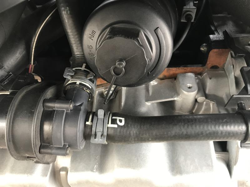

            for anyone who hasn't changed the oil before its very easy with the right gear, thought I'd take a photo at each step incase it helps others. this is the oil filter which is accessible once you have removed the under tray via the 8 torx25 screws (4 each side)...
            this is the filter housing after the dust cover is removed...

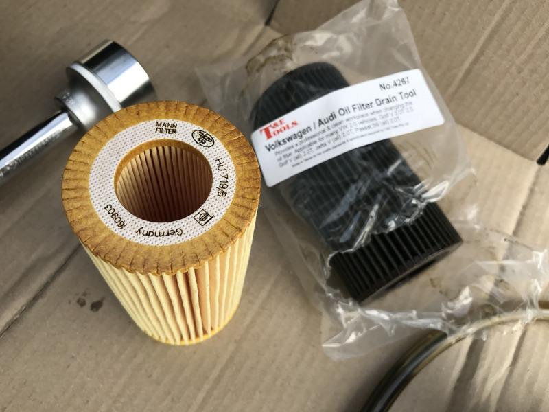

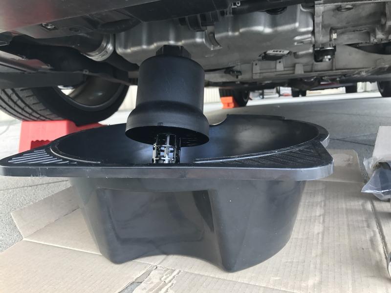

            and this is a new tool I bought for draining the oil out of the housing. you can use other methods but after years of working on cars saving money and making do with whatever tools I had, its nice to have the right gear. it makes it so much easier and cleaner process...
            draining oil from the housing...

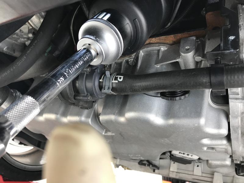

            36mm socket for removing the filter housing, rotate anticlockwise as usual...
            I sat the filter housing on the bowl while i went to get the new filter and some long nose pliers to remove the o-ring...
            pretty much all the tools you need to do the job...
            and the torque wrench if you're nervous about cracking the housing like me, 25nm for tightening torque...
            comparison between old and new filter colour...

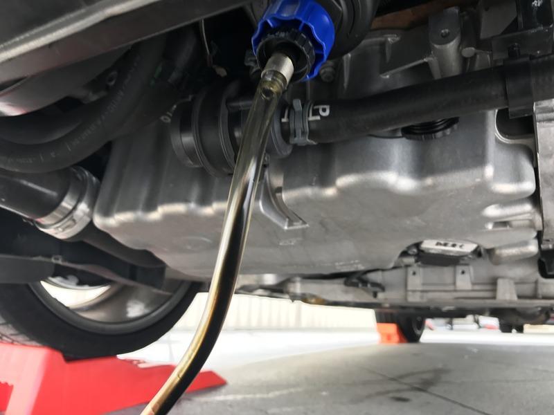

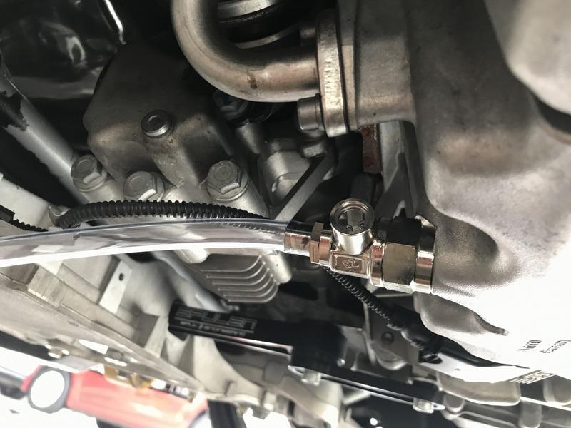

            and finally back together with an ezitap to drop the oil without removing a sump plug next time...

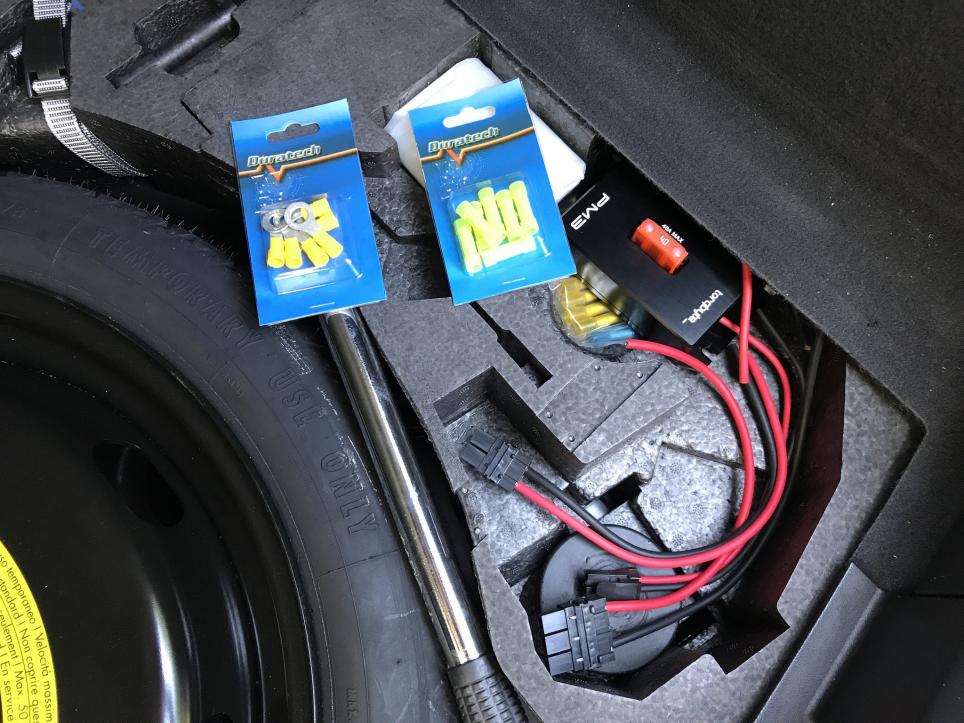

                  • no probs mate, all pretty easy so far it would appear. hardest part was getting all the wires through the rubber grommet and I thought I was on the home straight to having it installed last weekend...
                    then I realised I needed to take a power feed straight from the battery which stopped play until next Saturday. a trip to Jaycar for wire, crimp terminals and 40 amp fuse is on the cards and then I'm on again...

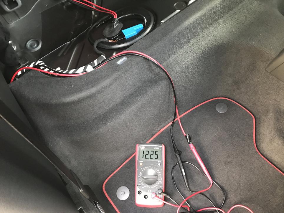

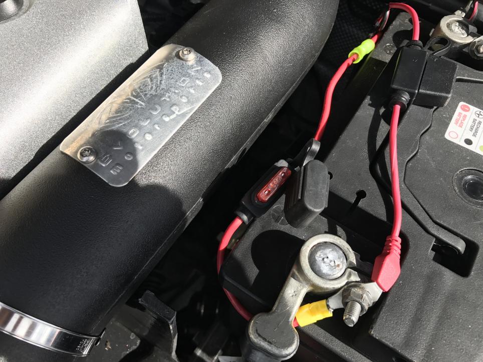

                              • a couple of steps closer to getting the pm3 up and running, hardest part ever getting a feed through the firewall...
                                installed a 40 amp fuse at the battery as per the destructions...
                                a few more connections to make and its golden...
