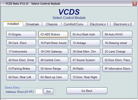

        • not much of an update but something i should have done a long time ago, i used vcds to set the hill hold control option...
          luckily i had the abs unit from the factory that means its a simple coding process without any need for hardware, first select the abs module...
          next choose long coding helper...
          finally select byte 16 which then brings up two tick boxes at the bottom, select "Hill Hold Control", save an you're all set...
          it might not be for everyone but it holds the brakes on for a couple of seconds when facing uphill so you don't roll backwards before the clutch is engaged. for me it helps make the stage 3 clutch a bit more manageable on the hill starts...

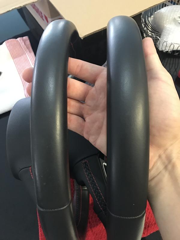

                    • s3 8v steering wheel arrived yesterday so thats the job for this coming weekend. it sounds like a quite an expense for not much visual change but i think the 8p wheel is too thin and miss the feel of the chunky wheel on the r32 i used to own...
                      I obviously don't need the paddle shifts but they can be unbolted as far as I know...
                      you can tell the wheel profile and thickness is slightly different in this shot...

                              • a few minor updates with some photos of the wheel swap I did recently, new for old...
                                some might wonder why I changed it but for me the slightly extra thickness of the wheel was worth the change...

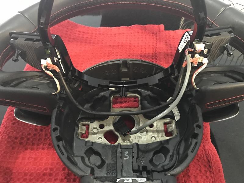

                                had to remove the paddles...
                                and repin the the connector...
                                but I reckon it was worth it...
