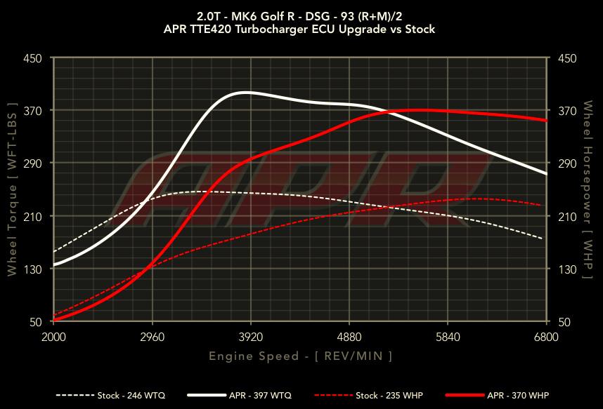

a fresh update, I joined the darkside and switched to an APR tune this week. I haven't picked it up yet but if the whp on 98 ron is as per the APR website it will be a nice increase. 295 nags at the wheels to 370 horse. no doubt the advertised numbers will be high but I'm looking forward to what the butt dyno reckons...

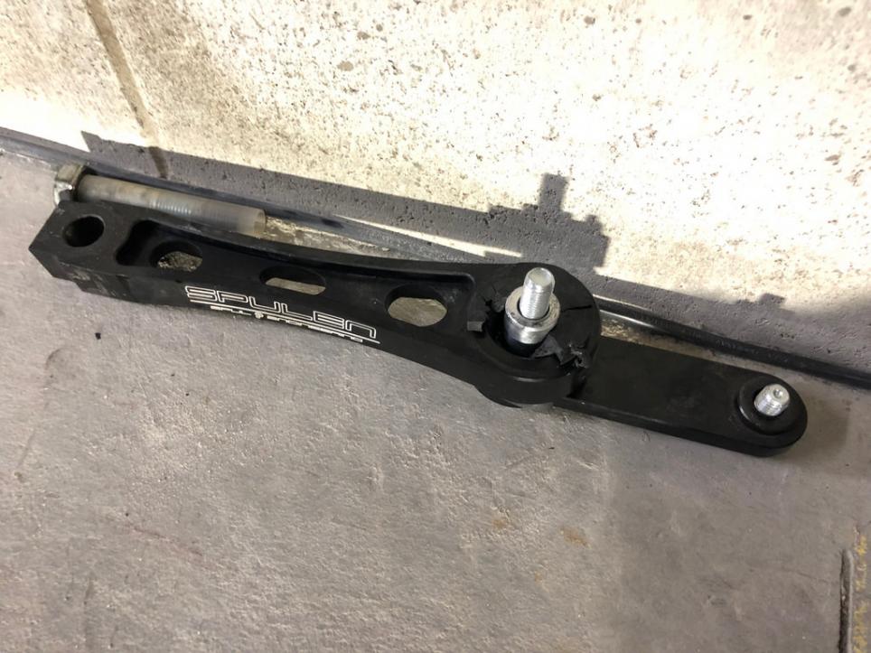

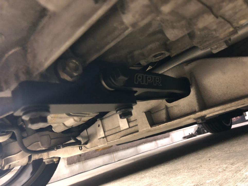

the guys noticed that the uprated pendulum mount was toast and gave me a heads up. in a strange way it was nice to know as I thought I'd heard a knocking lately and guess thats probably it...

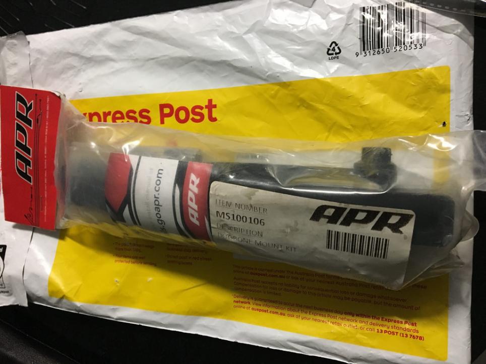

so now it has some APR on the car I didn't think it would hurt to go with one of their solid pendulum mounts. Surprisingly Ecotune had one in stock...
Swapped out the pendulum mount at the weekend. Hard to tell but the rubber bush on the centre bolt shouldn’t look like that...
Hopefully the new apr one will do a better job...

I had a racingline stage 1 loaded on the the mrs a5 3.0 tdi and was pleased with the results. I was surprised how quick your tt is straight out of the box so no doubt you'll be happy with the bit extra from stage 1, do you know what power is quoted?

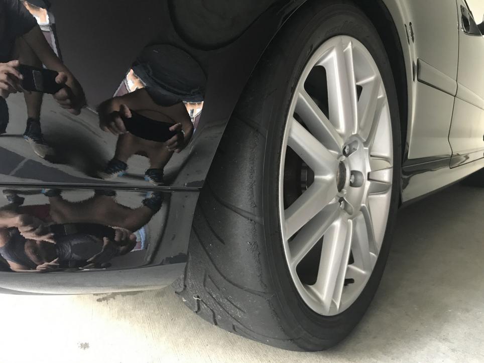

got some new wheels and rubber for the track also. not my first choice in wheel stye but I was struggling to get the right fitment so they'll have to do...
According to the Racingline site - stock 160-170kw, 350NM - with stage 1 234kw/450NM. At the wheel I'm expecting maybe around 190-200kw. I've got a Racingline cold air intake (R600) and a couple of other bits being added at the same time.BMW Z4 (2019)

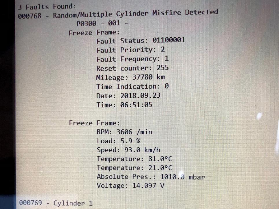

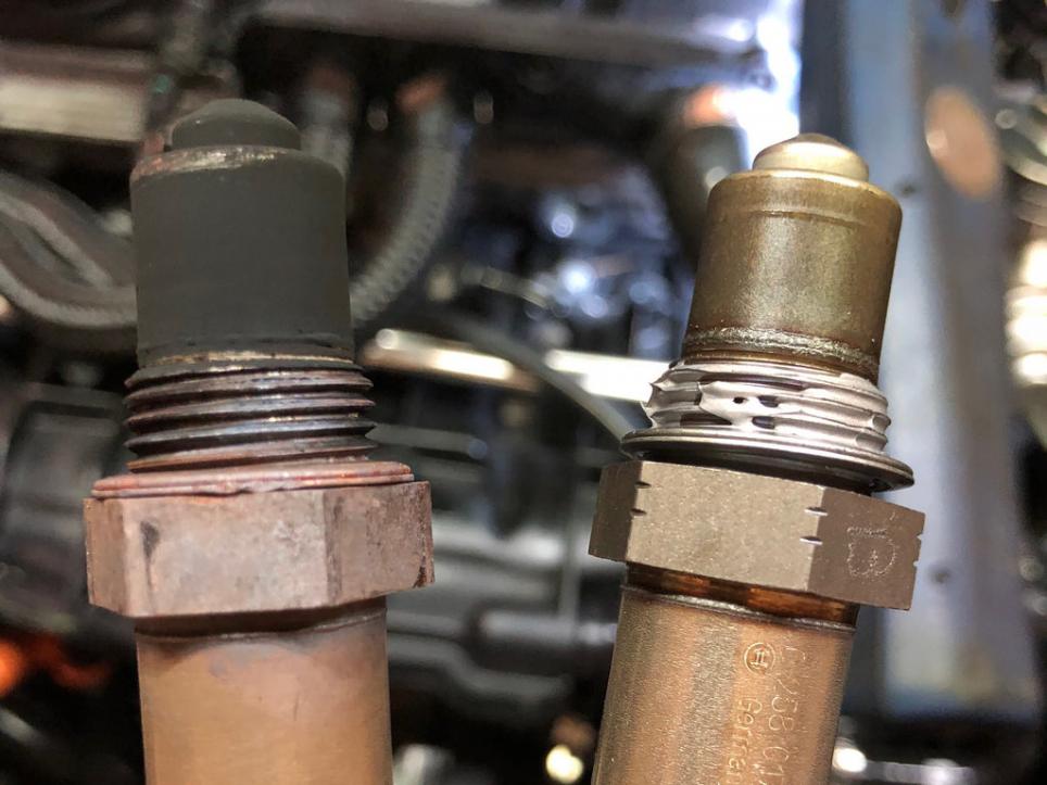

I found time on Friday to replace some service items as I'm trying to dial out some slight rough running issues. I changed the fuel pressure sensor, fuel filter, both oxygen sensors, cleaned the maf and replaced engine oil and filter. the oxygen sensor on the downpipe was loose so I'm thinking that wasn't helping things...
I had lots of fun Saturday on a small kart track, the S3 felt strong but still not 100%. room for a bit more oversteer and the motor back fired and stuttered on a couple of occasions. it still held its only with some relatively track orientated cars though...
I headed out for happy laps early Sunday morning and got half way there when the engine went in to limp mode; I traced this back to a fouled plug. looks like the shop didn't gap my BKR8EIX to 0.55mm which probably explains the rough running. I changed to some 7's that I had as spares and went for a quick spin. the car felt stronger than it did on Saturday; I'll definitely be carrying a spare set of plugs and plug spanner in the car from now on. looking back I don't know why I didn't change them on Friday when I serviced the other parts, gutted I missed hl...
