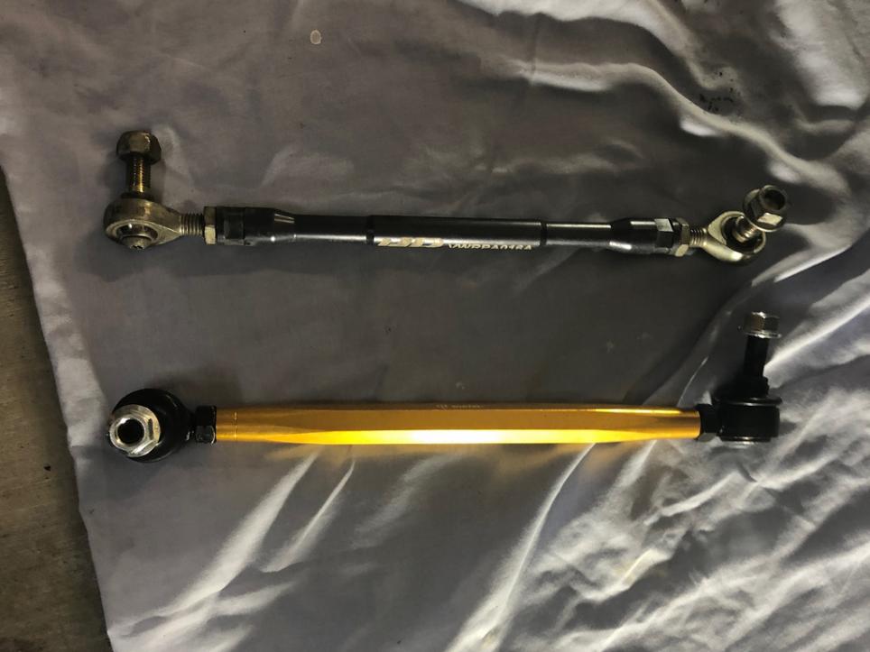

      I didn't go with the pillow ball joints this time; they were replaced with some whiteline items that I measured up against my old units. I also stiffened up the rear sway to try and achieve more oversteer...

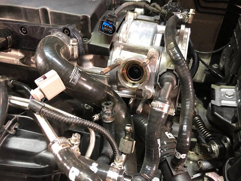

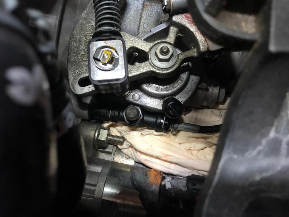

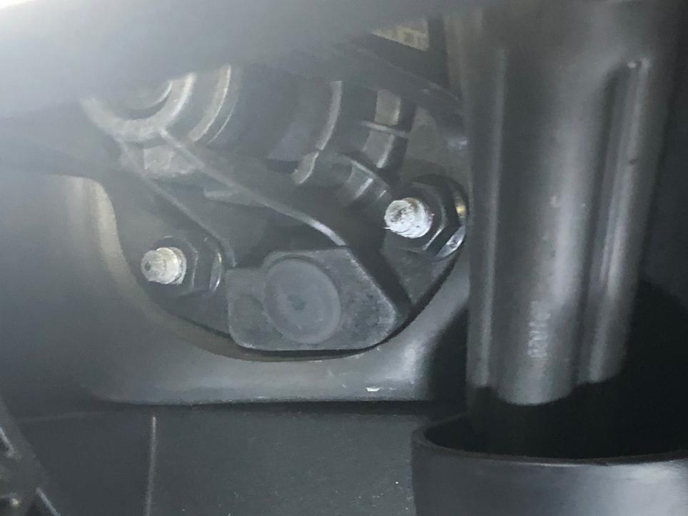

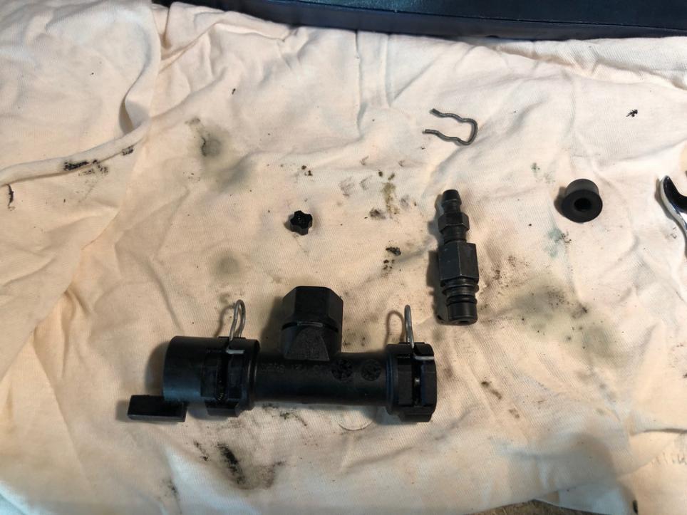

      the clutch has always felt unusual to me and on doing some reading I thought it may be to do with the hydraulic clutch valve so I decided to remove it. I put a cloth down to catch any dripping fluid...
      this is what it looked like removed from the car...
      and then this was it with the valve removed...

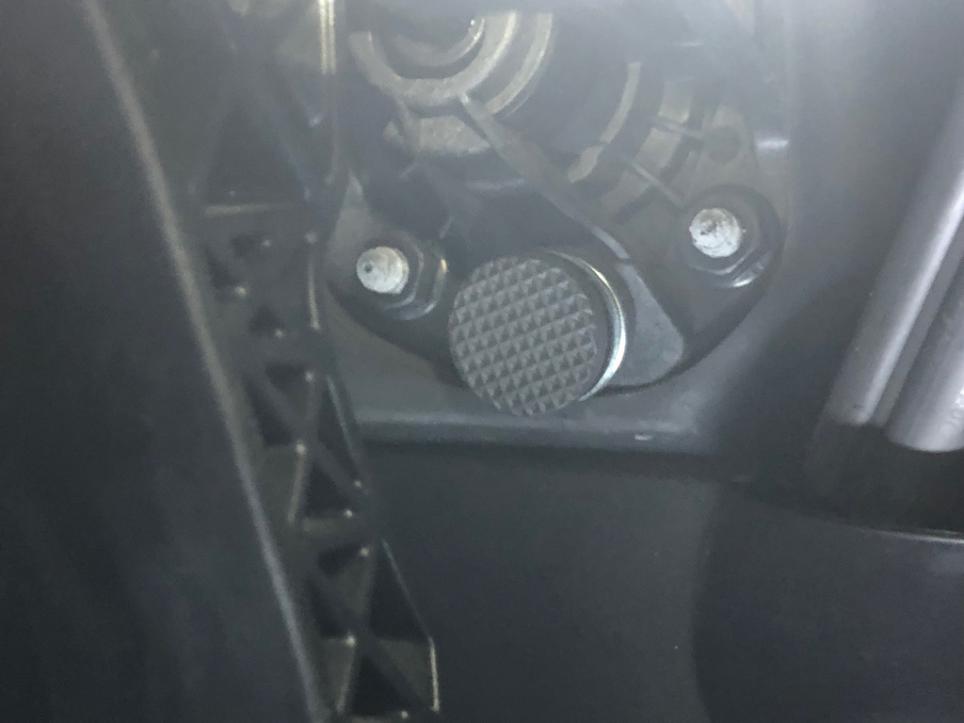

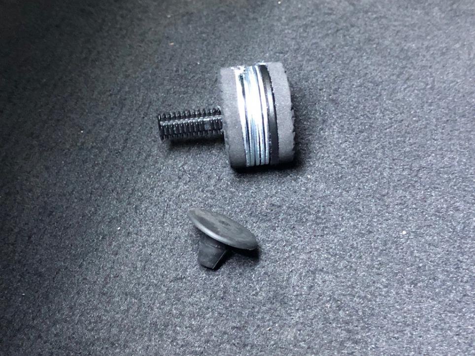

      then I decided to reduce the pedal travel by replacing the clutch stop; this is the old stop in place...
      this is both clutch stops compared...
      then the new one installed...

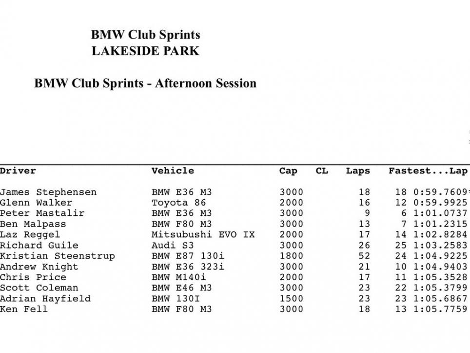

      • I had great fun at lakeside on friday, car definitely felt better and minor improvements from me also. I scored buy best lap time so far but still plenty more time to come off...

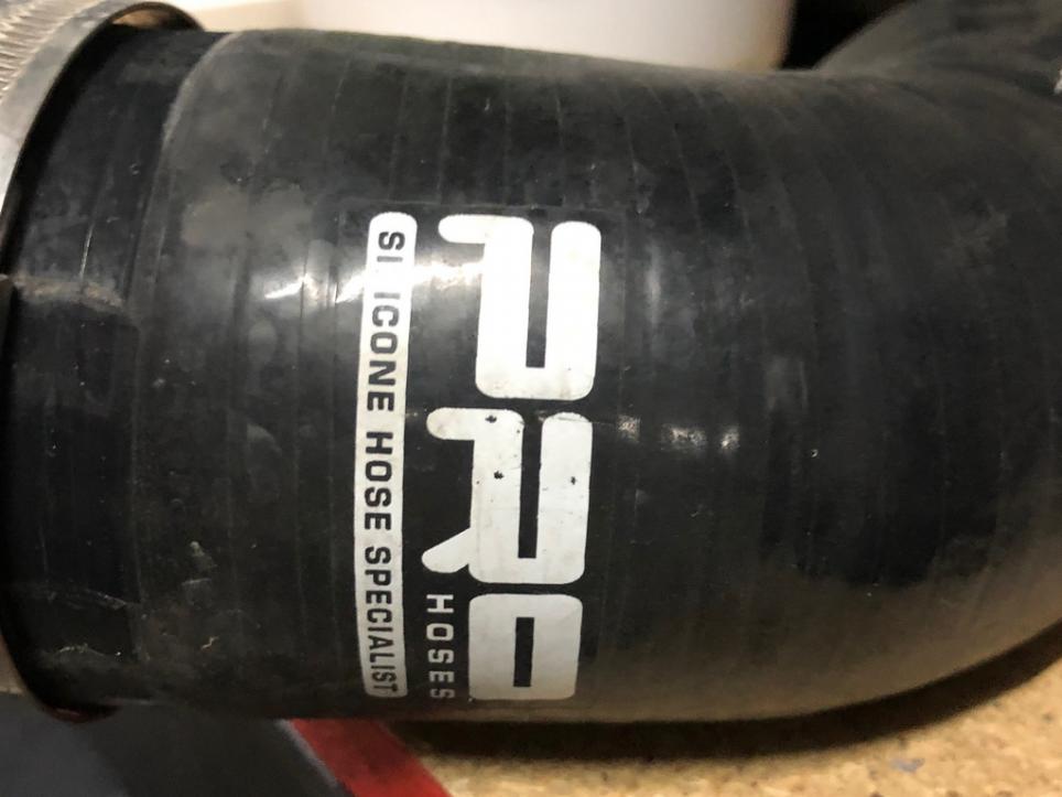

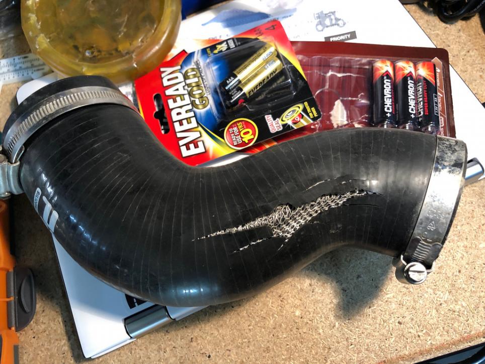

        the car felt down on power on a couple of occasions and it really wasn't happy on the way home even though I always cruise home to give the car and my licence a break. I checked it out and found the boost pipe issue in the photo below. considering my last too laps were my fastest and I'm fairly certain the pipe went on the track, I can hope for improvements alone with significantly more boost next time...
        this is the hose company, I need to wait a month to get one from the UK. not happy...

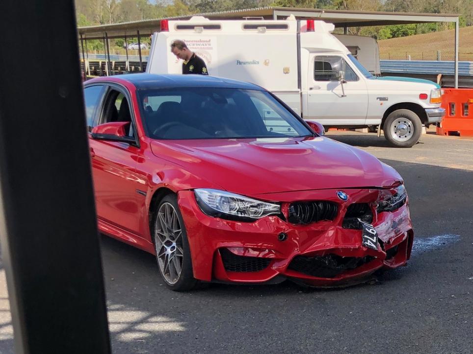

        at least my day ended better than this poor chaps. I felt pretty sorry for him, he must have been gutted...

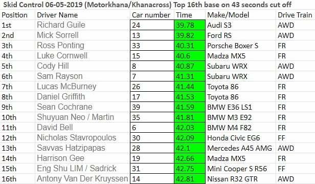

        • cars feeling really strong at the moment, I'm not really that competitive but I have to admit its a good feeling to get the number 1 slot...
          • Well done mate!

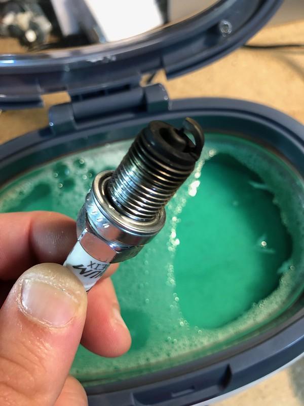

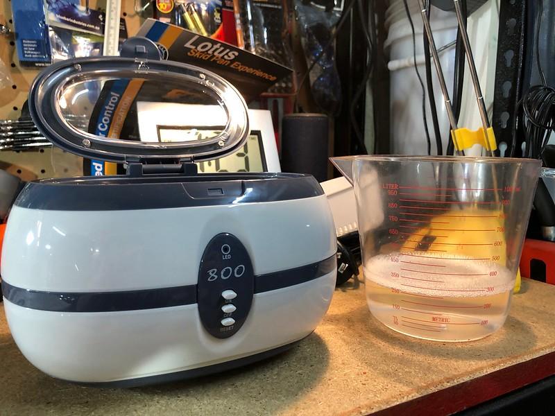

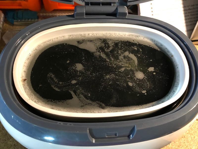

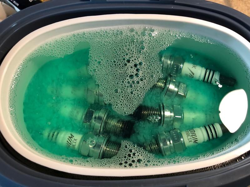

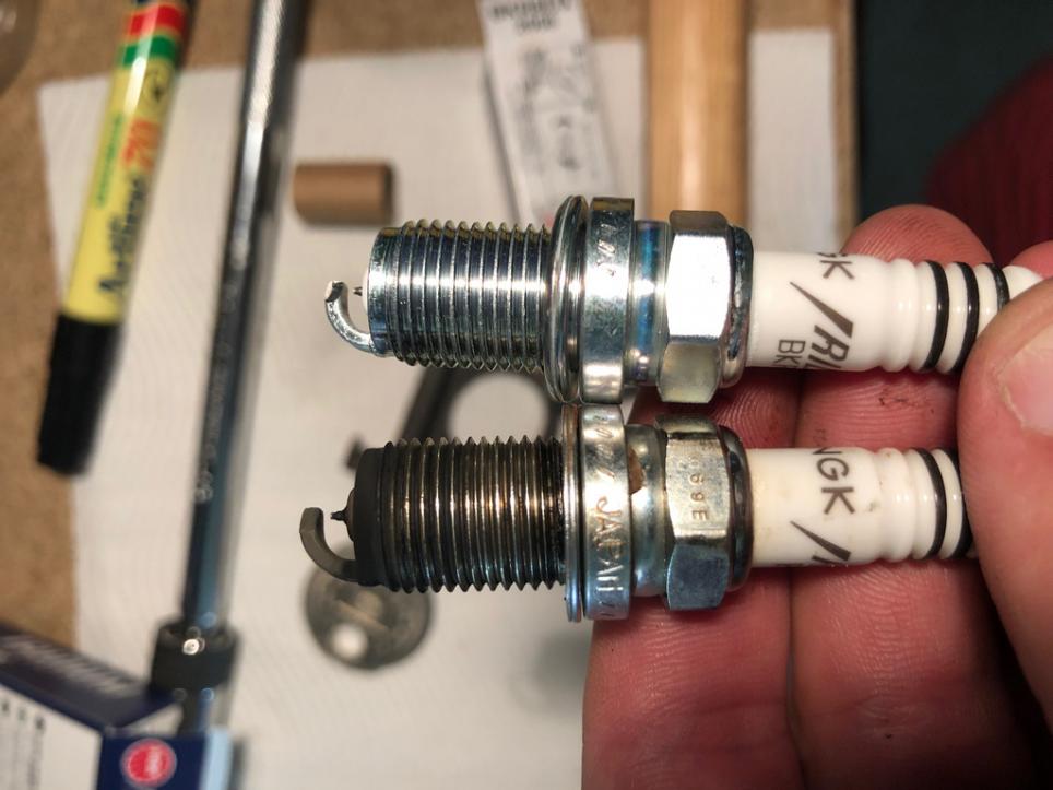

                      • the car wasn't running great prior to my track day so I decided I'd try to improve the ignition side and clean the spark plugs. they had only been on for 500k but I think they fouled due to the boost hose leak and the tune trying to correct the mixture. I thought this might happen in the future and didn't want to keep buying new plugs every 500k so I decided to try an ultrasonic cleaner...
                        I really didn't know what solution to use so I experimented with truck wash and water. turned out to be far too much truck wash; I've also heard white vinegar works well...
                        I cleaned 8 in one hit, 4 x 7's and 4 x 8's. the 8's foul in no time unless you're on the track...
                        the tips before they went in...
                        this is what they looked like as soon as they hit the cleaner...
                        and this is what the solution looked like after around 12 runs at 40 seconds. stupidly I forgot to take a photo of the end result but I will do that soon to show the comparison...

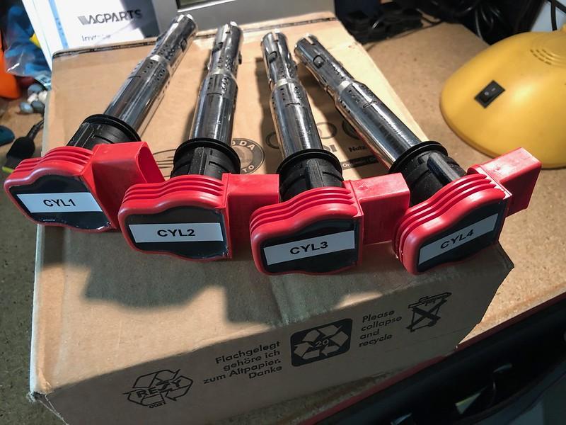

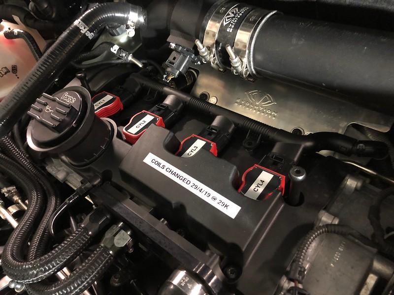

                          and more work on the ignition side by using the bling r8 coils, super extra horsepower...
                          I decided to add a label for when the coils were changed and will do the same for the spark plugs too (I need to change the label, it should be 39K)...

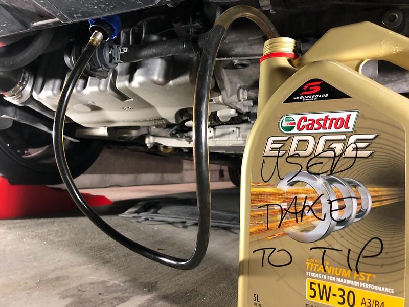

                          and also replaced the oil...

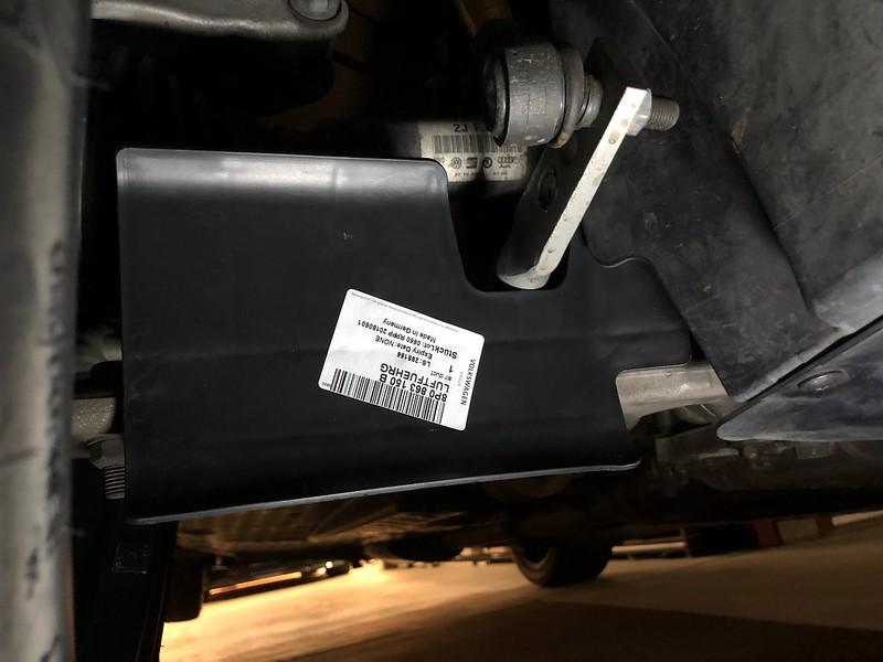

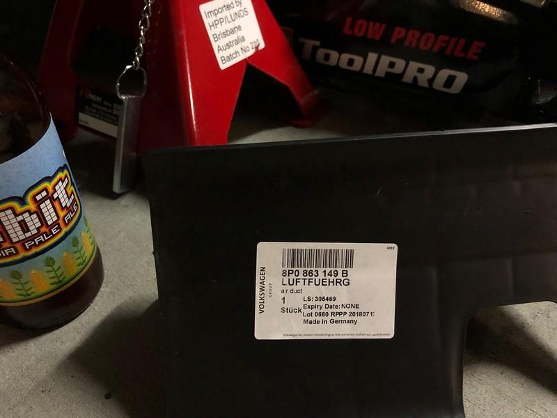

                              also purchased the ttrs brake cooling inserts...
                              they clamp to the control arms and direct air towards the rotors...
