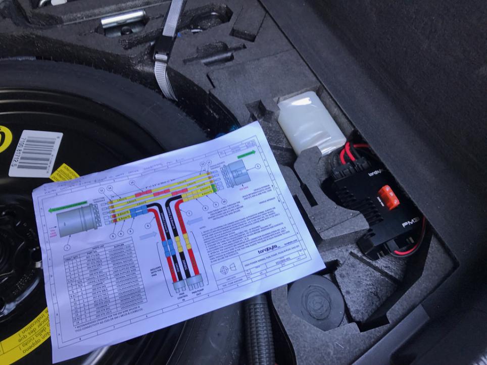

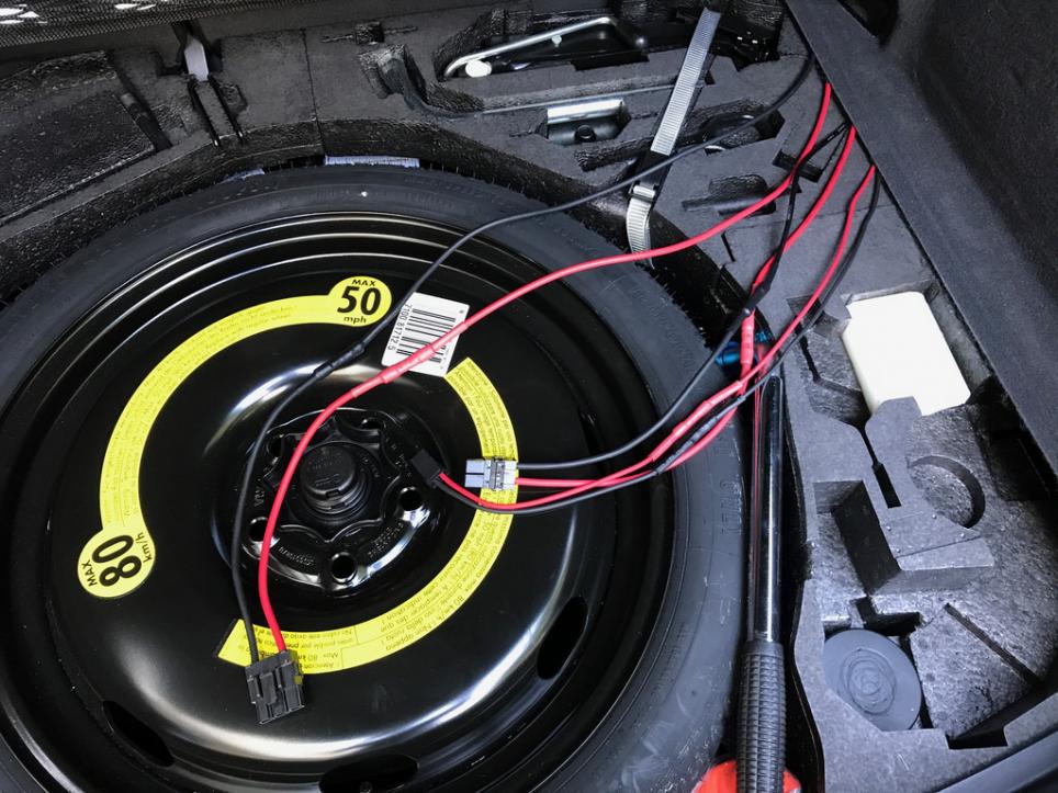

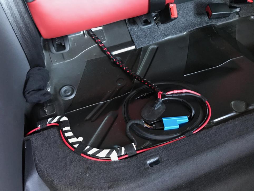

      • final wiring installed and heat shrink wrapped...
        all wrapped and tidy at the pump too, trying to keep it as oem as possible...
        all hooked up in the boot with the wiring diagram for anyone planning to do the same install. the destructions say not to keep it covered due to heat transfer put pretty difficult to find anywhere decent to put it. i'm planning t pull the boot carpet out on track days to let some air circulate around the heat sinks, i'm sure that will be sufficient...
        i took it for a steady run to the coast and back, no issues so i think i've installed it correctly. the real test is lakeside next month, looking forward to getting on the track and catching up with some of the regulars...

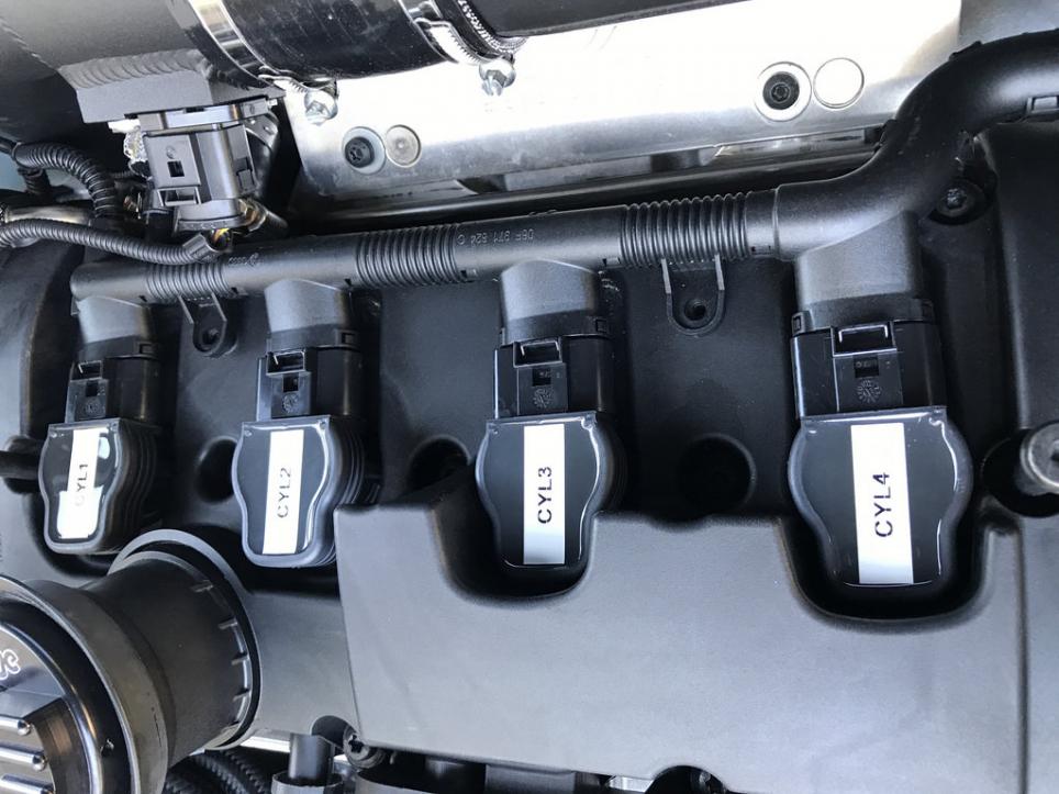

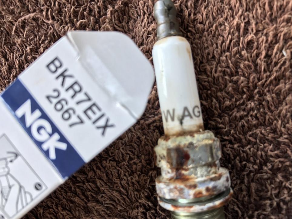

        • so i took it for a spirited drive to ensure it was ready for happy laps and the car was misfiring badly, i couldn't believe it and thought it must be something to do with the new controller. i disconnected the new unit and took it for another spin and the car was still misfiring...

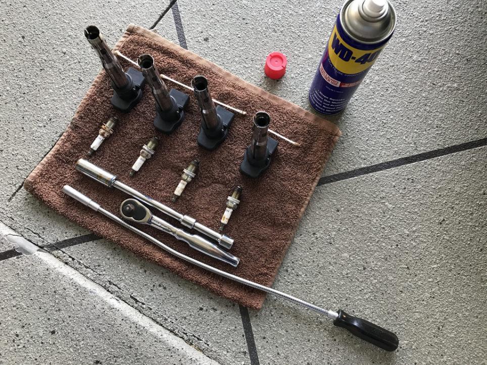

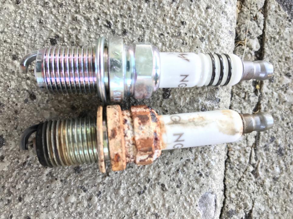

          i started with the basic and cheapest replacement part i could think of; spark plugs. before removing them my ocd took over and a labelled the coil packs. i know they are not the cylinder firing numbers but i'd never get that right, so just i just went from left to right. i'm a poet and i don't know it...
          looks like i got lucky with my second guess...
          i switched them for ngk's recommend for stage 2+...

            so i took it for a run after i put it back together and the car was misfiring badly, i couldn't believe it and thought it must be something to do with the new controller. i disconnected the new unit and took it for another spin and the car was still misfiring...
            i started with the basic and cheapest replacement part i could think of; spark plugs. before removing them my ocd took over and a labelled the coil packs (i know they are not the cylinder firing numbers but i'd never get that right, so just i just went from left to right. i'm a poet and i don't know it)...

            Did replacing the plugs defeat the misfire??
            Sent from my SM-G950F using Tapatalk
            • yes mate, all snorted...

              • Good work there mate. Always start with the easiest things. Those plugs looked pretty nasty. would probably have cleaned up and lived again but for a small cost. Replacement and doing it once is a good choice.
