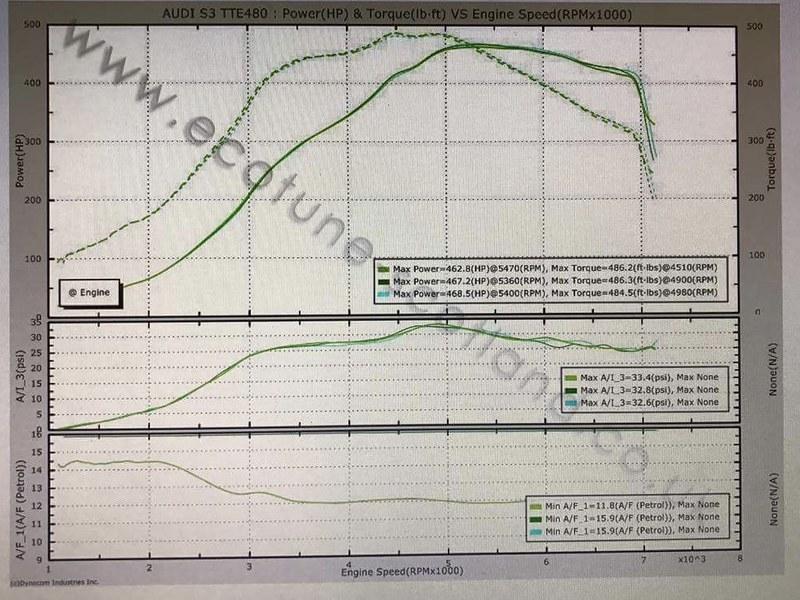

TTE are having a COVID sale so i was toying with the idea of upgrading to the TTE480. looks like a decent size wheel but i wonder if significantly more lag would be experienced...
see a dyno plot below from a uk tuned car...

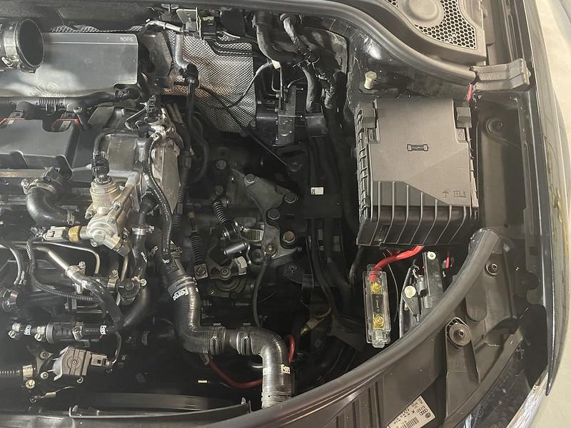

while generally checking under the bonnet in between sessions I notice this which was less than ideal...

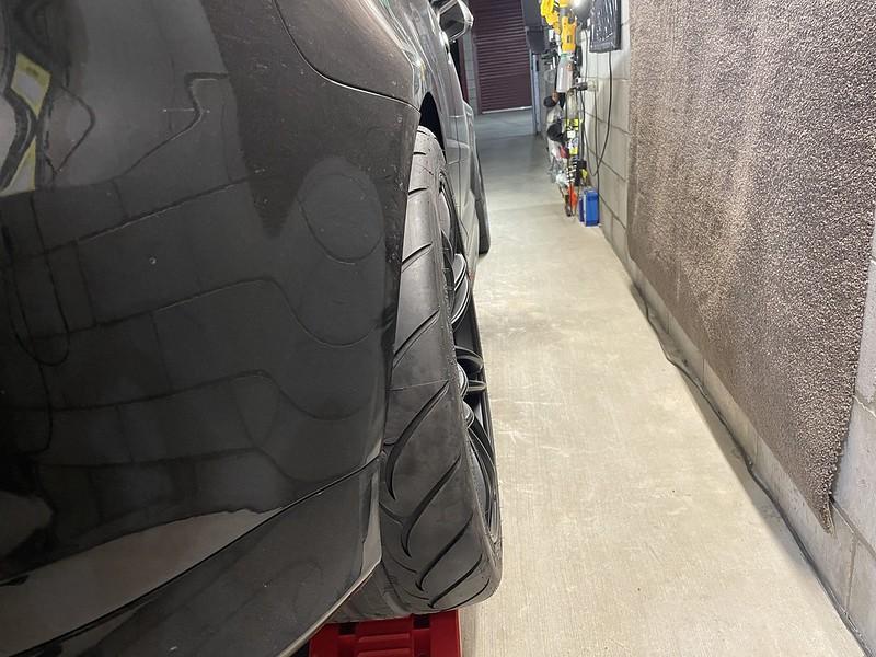

I've just ordered these rear brake discs and adapters. I'm not sure if they'll make an improvement but with the much improved braking force on the front I'm standing it on its nose so I'm hoping these might help to address the balance. if all else fails they should look the goods, I just hope they clear the 18's as the advert said 19's recommended...

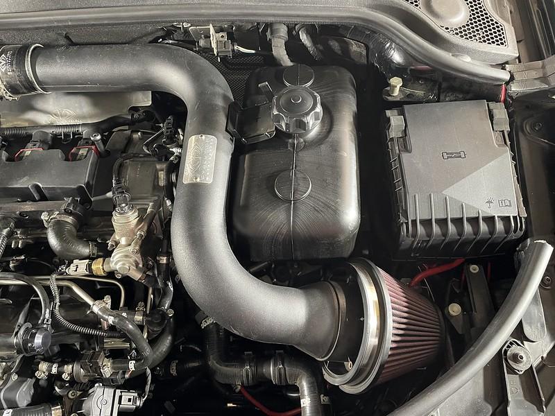

You will be surprised (if you have never used water/meth injection before) at just how quickly that tank will empty. If you are getting the ECU tuned specifically to take advantage of the water/meth then I suggest having a low fluid level sensor fitted so you know when to pit and top up.
Less of an issue if you are leaving the tune as is and simply using the water/meth as a cooling/octane boost effect. You could also experiment with 5-10L of E85 mixed in with Premium 98 to raise octane and give some additional knock protection.
I won't be getting it tuned, too scared of what happens if something goes wrong. I'm not keen for rebuild number 2...
I'll just use it on track to lower intake temps and may run a small amount of meth, probably 20/80 once I've done some more reading up on the best set-up...
