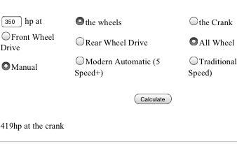

      although i said i'm not interested in figures my curiosity did get the better of me. a quick google and the rule of thumb appears to be gs / 0.8 which in my case is equal to 350bhp at the wheels. another google search and i found a converter to change the at wheels power to at crank power. the final result was 419bhp as shown below. it does sound rather inflated and of course i can't verify the figure but i'm going to stick with it as i think it's rather fitting that the new turbo is tte420...

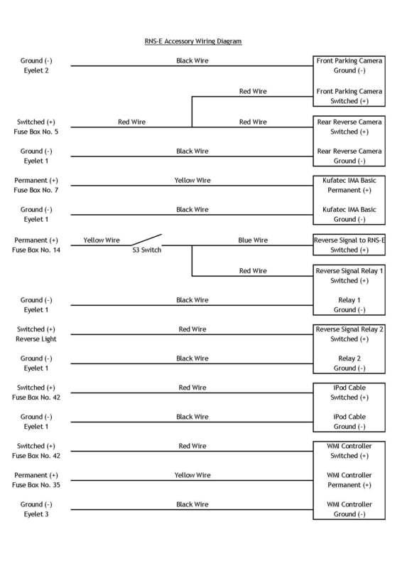

      • thought i'd make a note of my wiring plans for the front parking camera while i'm stuck at work...
        a little nice job for when i'm back home next. and for those thinking why do you really need a front/rear parking camera on such a small car, normally i would agree but it really helps with the tight parallel parking on my street. also i'm a bit ocd with not wanting to kerb the alloys and the camera really helps with the guide lines...

          thought you might be able to suggest the best place to take ignition power from???
          see wiring schematic mate in previous post with various options to take power from the fuse box...

            Thanks.I managed to get it sorted,Ive printed a copy of your diagram for future reference though

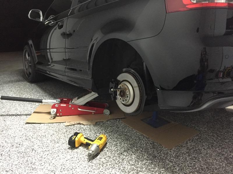

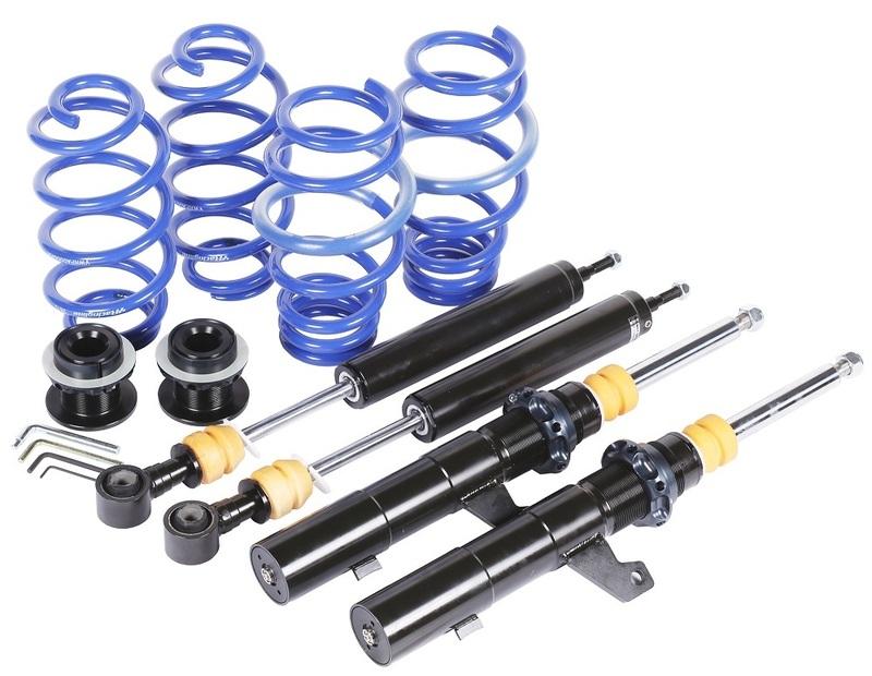

                    • after the last happy laps it was very aparent that the s3 was lacking in the handling department so i decided to upgrade the suspension. as it is a daily driver i didn't want anything too harsh, i read good things about the vwr gear so i picked up a set of street sport coilovers...
                      desperately trying to get them installed prior to next saturday's happy laps. so far I installed the rears over a couple of evenings this week. they took longer than i thought they would to install for some reason. i didn't have much room though so that probably didn't help...
                      rears are now fully installed and going to try and do the fronts over a couple of nights next week. fingers crossed...

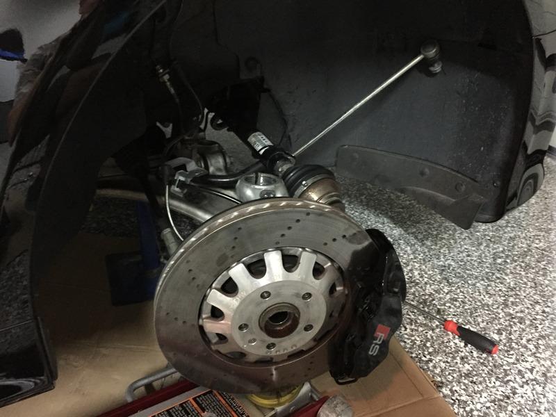

                      • If you struggled with the rears then the fronts will drive you insane....
                        • Originally posted by brad View Post
                          yep, already figured that out. i'm really looking forward to it...
                          • I'm surprised you thought it hard. It's no harder than the IC install.
                            Do you have the spreader for the front hub?
                            • i didn't find the ic install easy to be honest. yep, got the spreader socket and triple square so good to go on the tool front I think...
                              • by this point I was saying to myself, never again. then I realised I still had another side to do...
                                a quick reminder why cheap tools are no good, not for 200nm anyway...
                                and for future reference, I think I will need to go up to 22cm though once it's settled...
