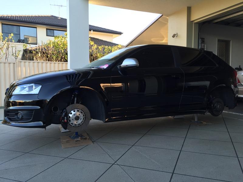

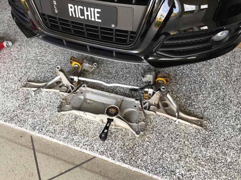

right, all done and ready for an alignment at 8.00am saturday morning...

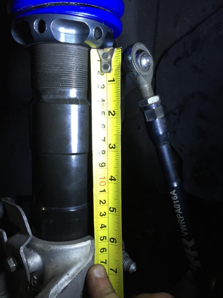

also installed the vwr adjustable drop links but i'll wait for the full suspension alignment to get these set up. i still have a front sway and subframe bushes to install before i take it to get it fully dialled in...
and another measurement for future reference. i hope i'm not too low for saturdays happy laps, i was rubbing a bit last time and this is roughly the same height but hoping its a bit firmer...

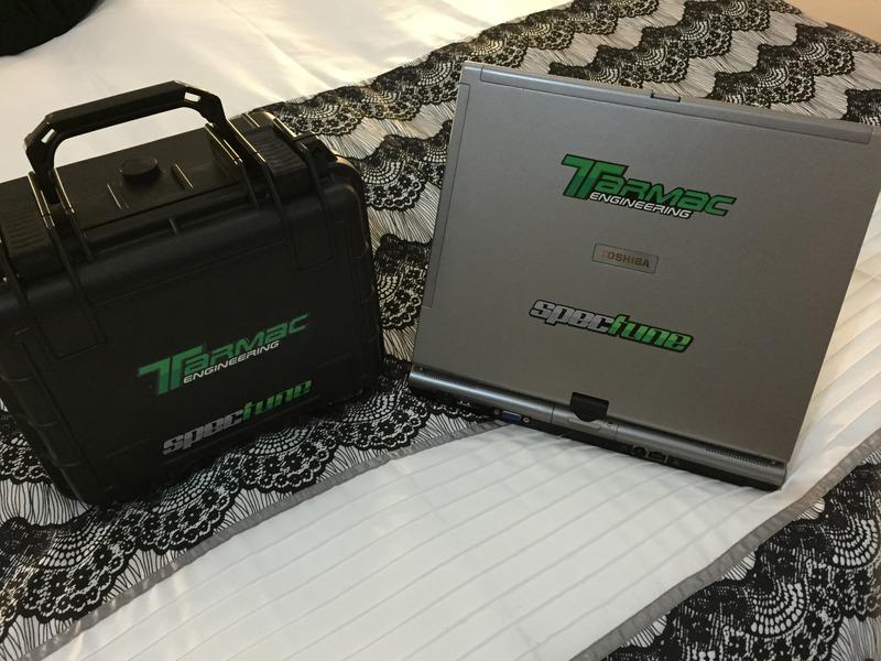

finally got around to sorting out my software for the car so its nice and handy each time i need it. just installed the new tune from Ben so hoping for good things on saturday, it also coded out my runner flap too which keeps my ocd happy...
the case is a bit bigger than i would have liked but at least it can hold my vcds cable, spectune controller and laptop charger...

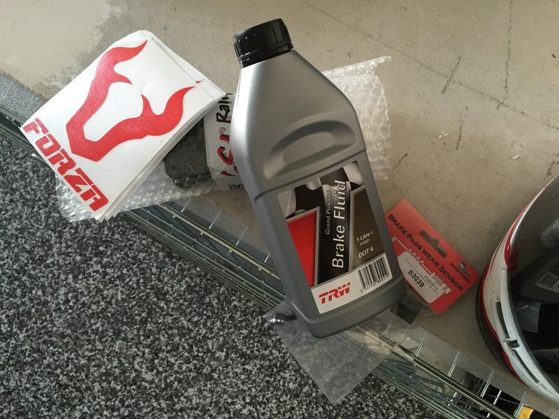

a bit more progress over the weekend, picked up some new front pads and race fluid from the helpful chaps at brakes direct. i can highly recommend there service...

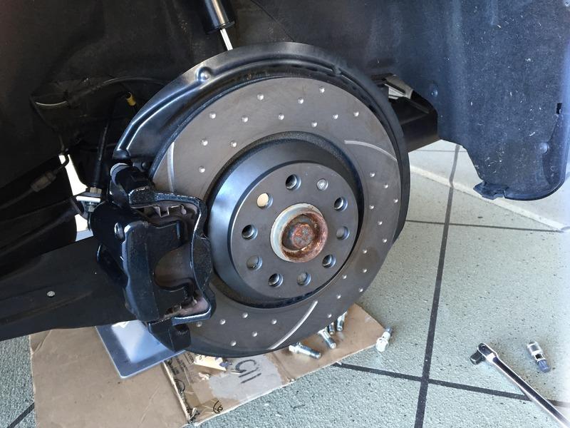

also got around to installing my grooved rear discs, before...
i'm not actually sure if they will increase performance and if i'm honest i mainly installed them to better match the appearance of the front discs...
also installed the rear braided lines while i was at it...
i still think it looks good without any wheels on...
