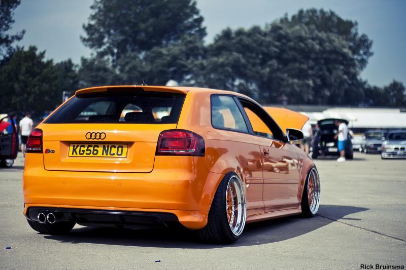

        a little shot of an s3 that got me thinking about some new shoes for mine...

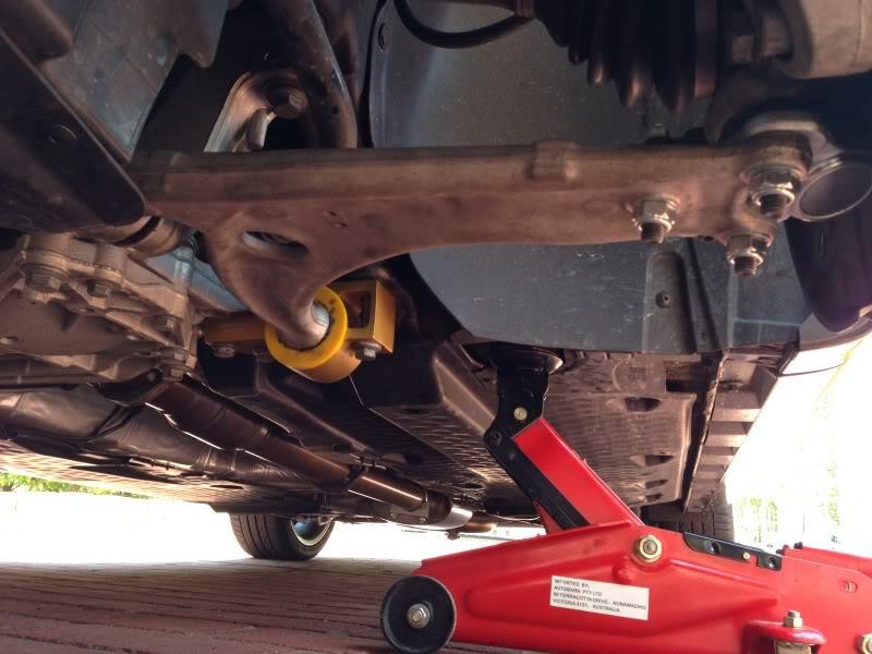

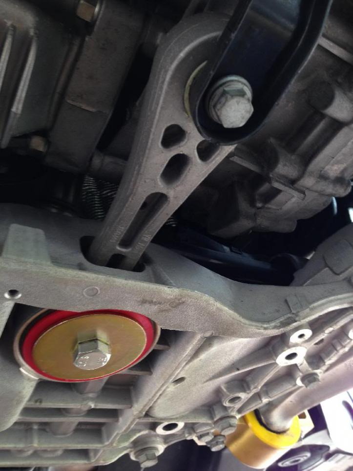

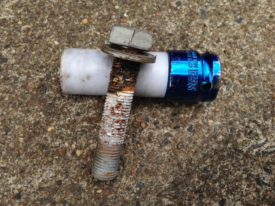

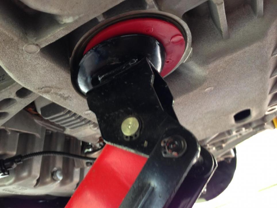

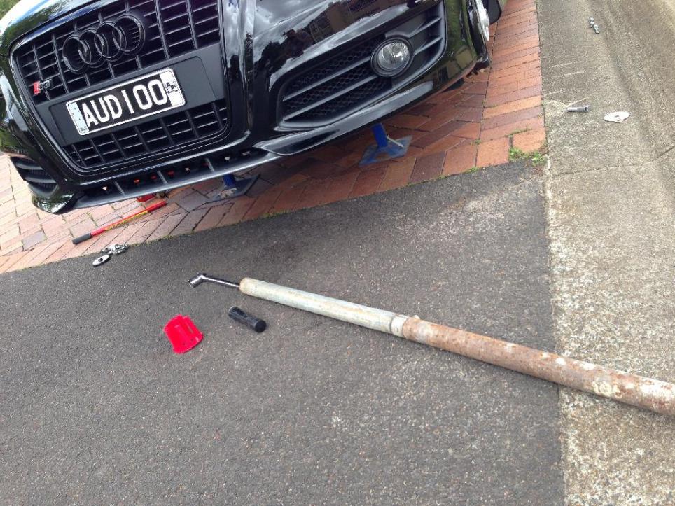

                  • added a few more bits at the weekend. the dog bone mount upgrade is one of the easiest and cheapest mods i've done; would highly recommend to anyone. the bolt was bloody tight to back off though, like the length of my persuader...
                    once greased up it was easy to slip in...
                    installed and torqued to f king tight...
                    surprised at the state of the original bolt, might explain why it was so tight...

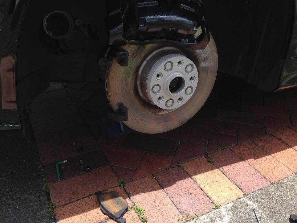

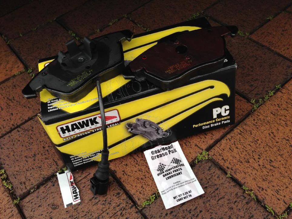

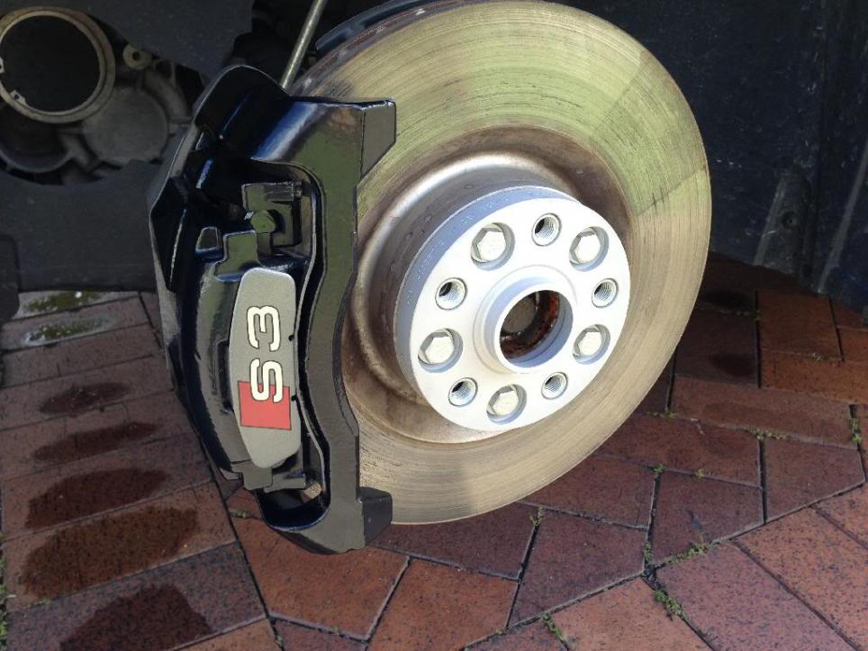

                    next on to the front brake pads, originals removed...
                    new ones fully lubed up...
                    and finally installed with a quick wipe down...

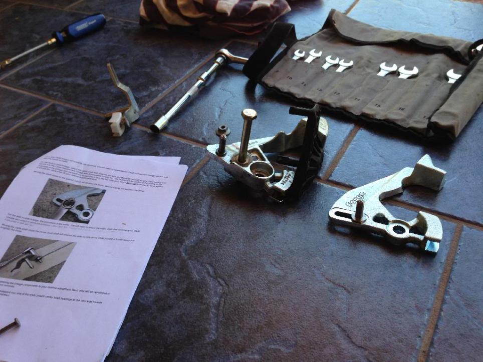

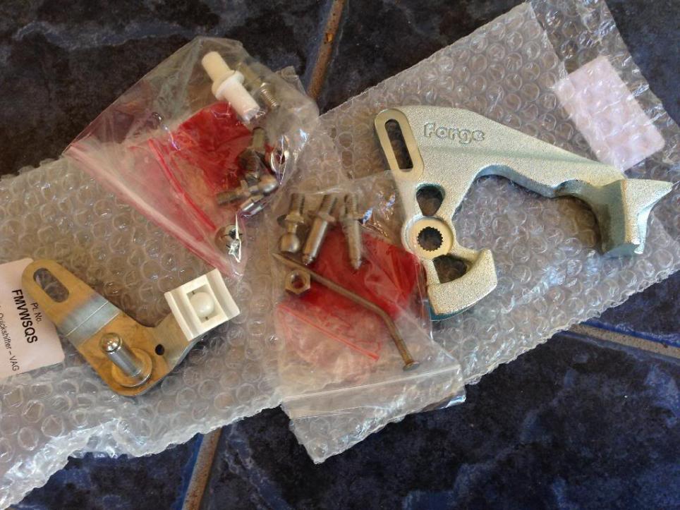

                        • The final piece of the puzzle showed up today, just hope they are as good as everyone reckons...
                          • got a few more bits fitted over the weekend…

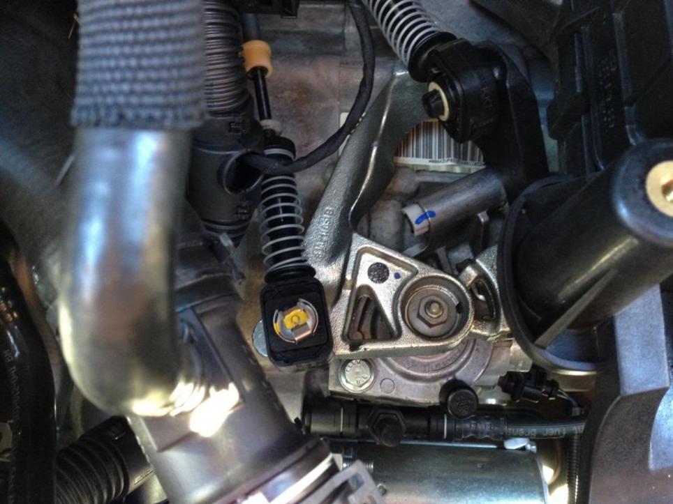

                            i took this shot for reference before i started…
                            the destructions reckoned you can just pull the original linkage off the splines, yeah good luck. after a bit of vigorous tugging i nearly put my back out and gave myself a hernia at the same time. i then decided to make my own jack off screw, nothing rude, i just used a bolt to jack the linkage off the box…

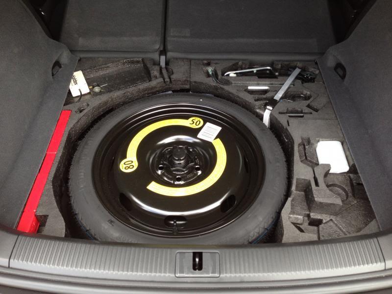

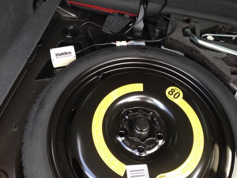

                            i also got the haldex on too. i didn't really want to cut the grommet in the boot floor but it appeared to be the best option and dropped the plug right in the location of the controller…
                            all hooked up and the boot put back together. fits in pretty neat and looks fairly factory…
                            and just so i can remember what controls what…

                                And how do you like the Haldex upgrade? Have you had a chance to test it out yet?
