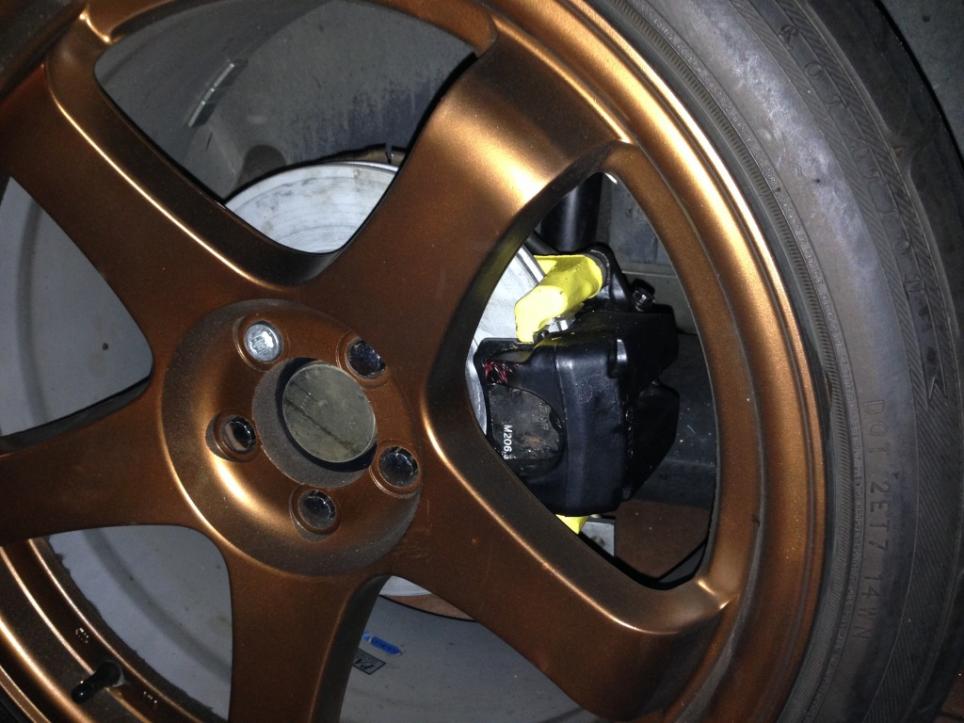

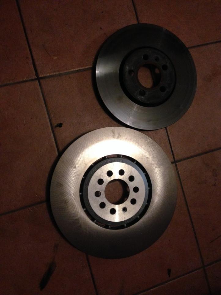

        • Rears are on
          Gonna do the fronts tomorrow. They are soo much bigger haha
          • wow that is a huge difference!
            so what are these brakes from??
            • Originally posted by blackers10 View Post

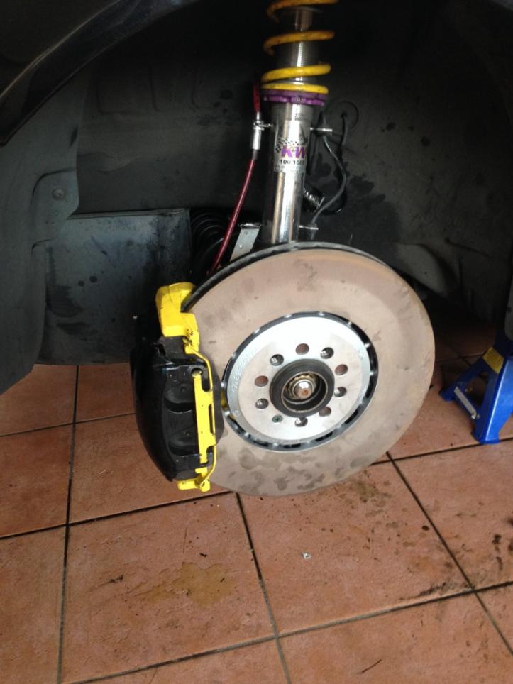

              They're off the r32 334x32mm

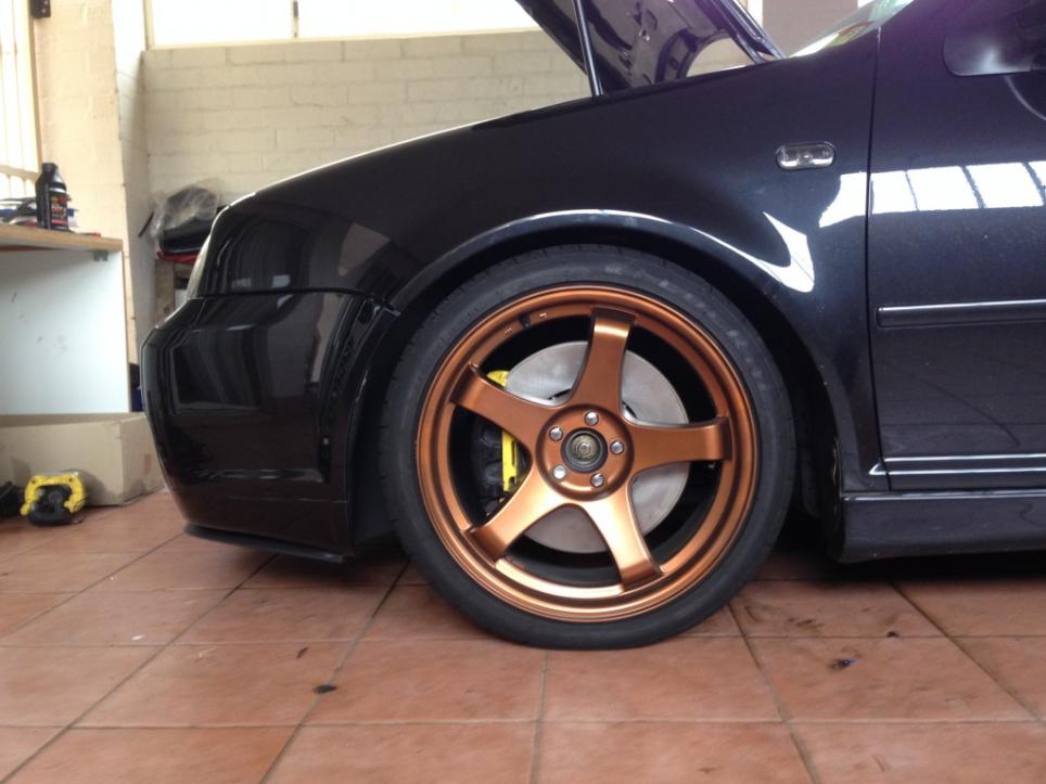

              Fronts in
              The fronts full the wheel nicely, the rears still look tiny haha
              • wow! the brake bias isn't effected too much with that greater difference front to rear? I guess all the weight and drive is in the front of the golfs so isn't so bad?
                • Well I upgraded the rears as well. It's the full r32 setup so brake bias should remain oem. Round 1 of bleeding and pedal still goes to floor when the car is on. Round 2 it is then haha
                  • aaa true, you don't need to cycle ABS or anything silly like that?
                    would be nice to have a vacuum bleeder

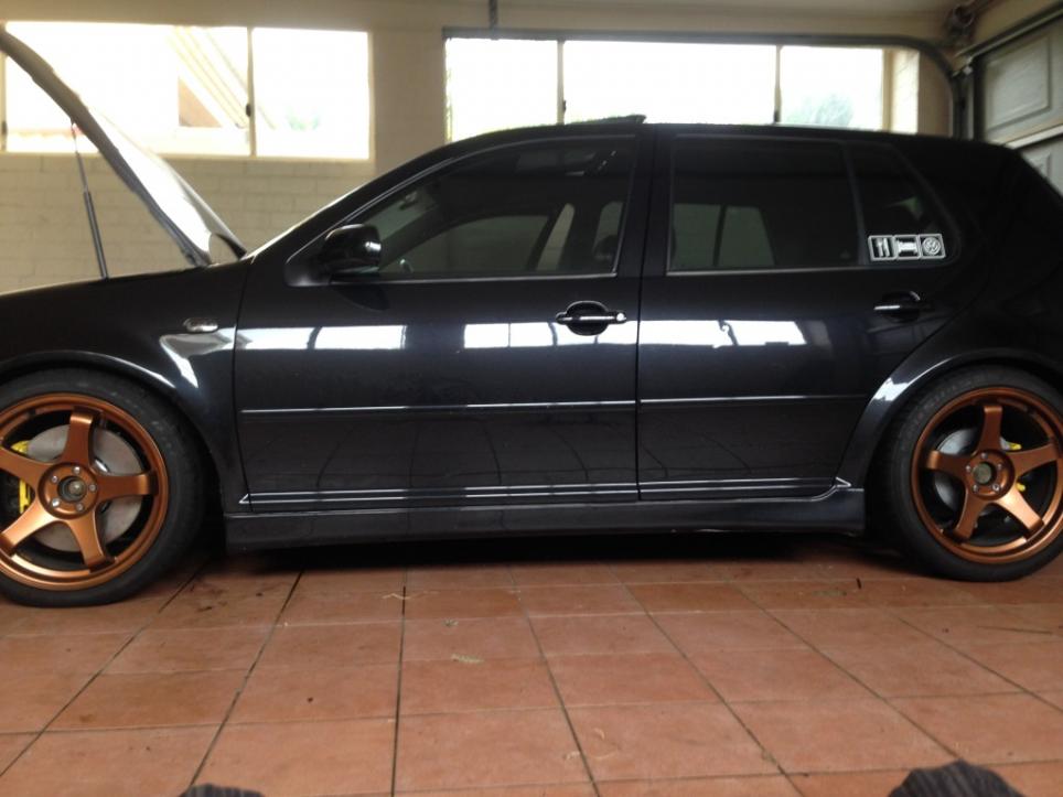

                    • Looks good man. Fills those wheels up great!
                      • I wonder if you should recode the ABS module to account for the R32 front calipers..they have a different softcode for the larger brakes.

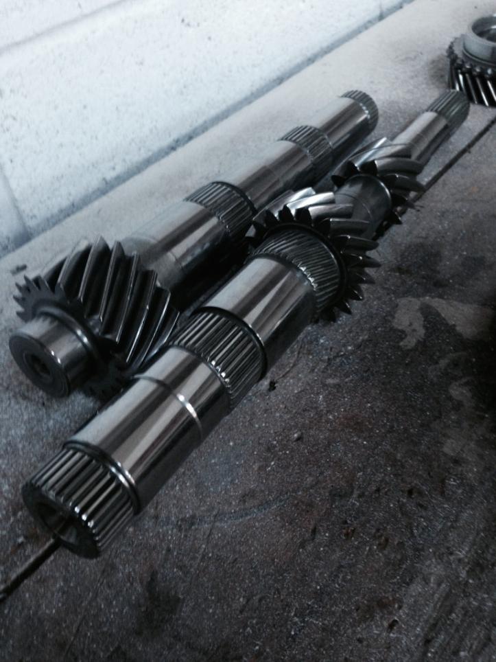

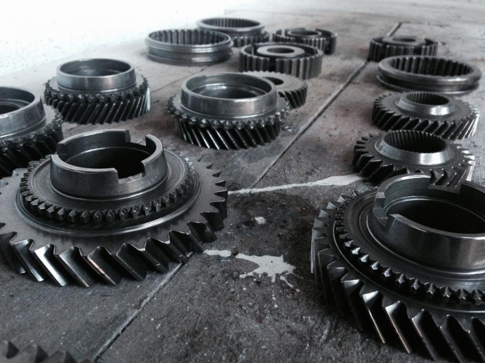

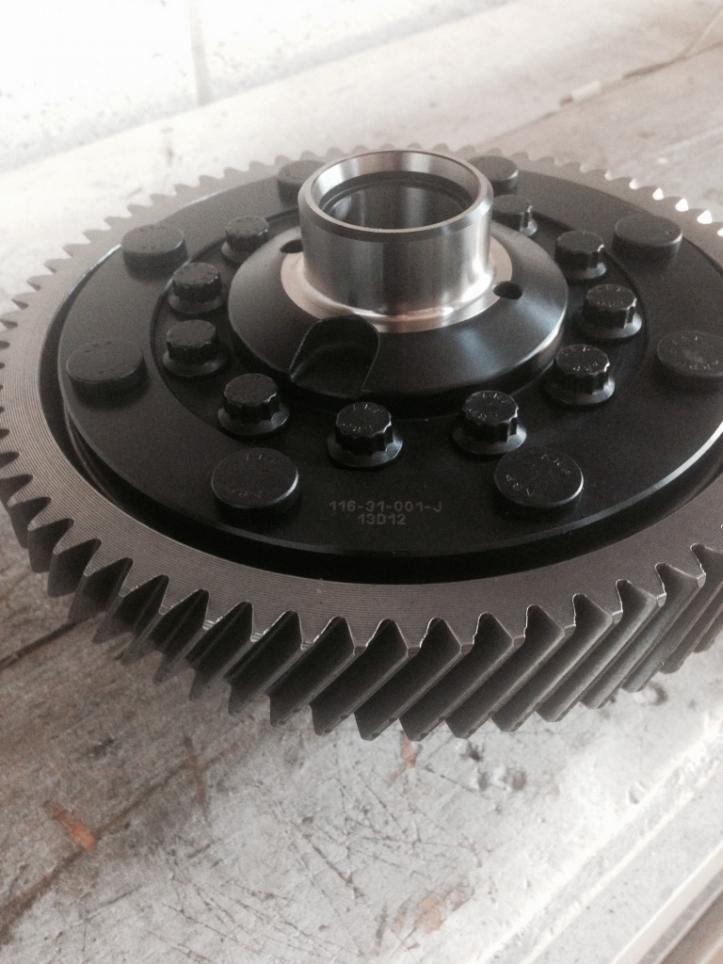

                            Thanks buddy but atm it's undrivable stripped the bleed thread on the master cylinder so I've given up and waiting for jimmy to get back and replace the mc and bleed the brAkes properly. Gearbox is also coming along, apparently there was some delays with parts but got sent these images and I'm really getting exited!!
                            • mmmm gearbox
                              Sent from my Nexus 5 using Tapatalk
                              • Just saw this on the Instagram and man does it look exciting!
